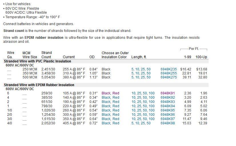

squonk 45,809 #5 Posted April 22, 2022 (edited) @stevasaurus The starter draws around 65 amps when cranking and inrush is close to 85. I would run 4 ga. cables to the battery, genny and switch if you got room. BATTERY CABLE SIZE 50 AMPS 100 AMPS 150 AMPS 200 AMPS 300 AMPS 6 GAUGE (AWG) 11.8 ft 5.9 ft 4.4 ft 2.9 ft 2.2 ft 4 GAUGE (AWG) 18.8 ft 9.4 ft 6.3 ft 4.7 ft 3.1 ft Edited April 22, 2022 by squonk 2 1 Share this post Link to post Share on other sites

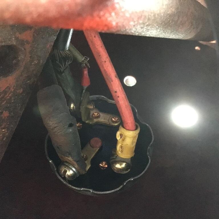

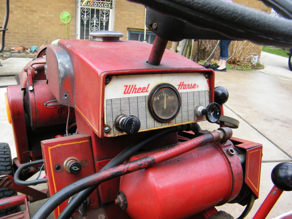

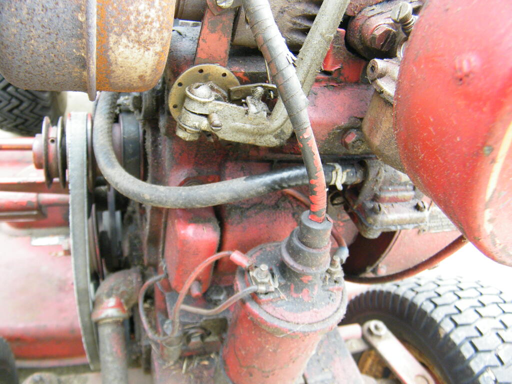

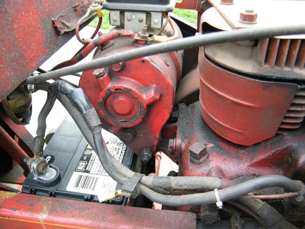

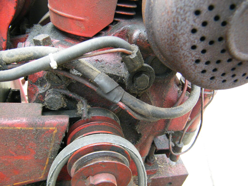

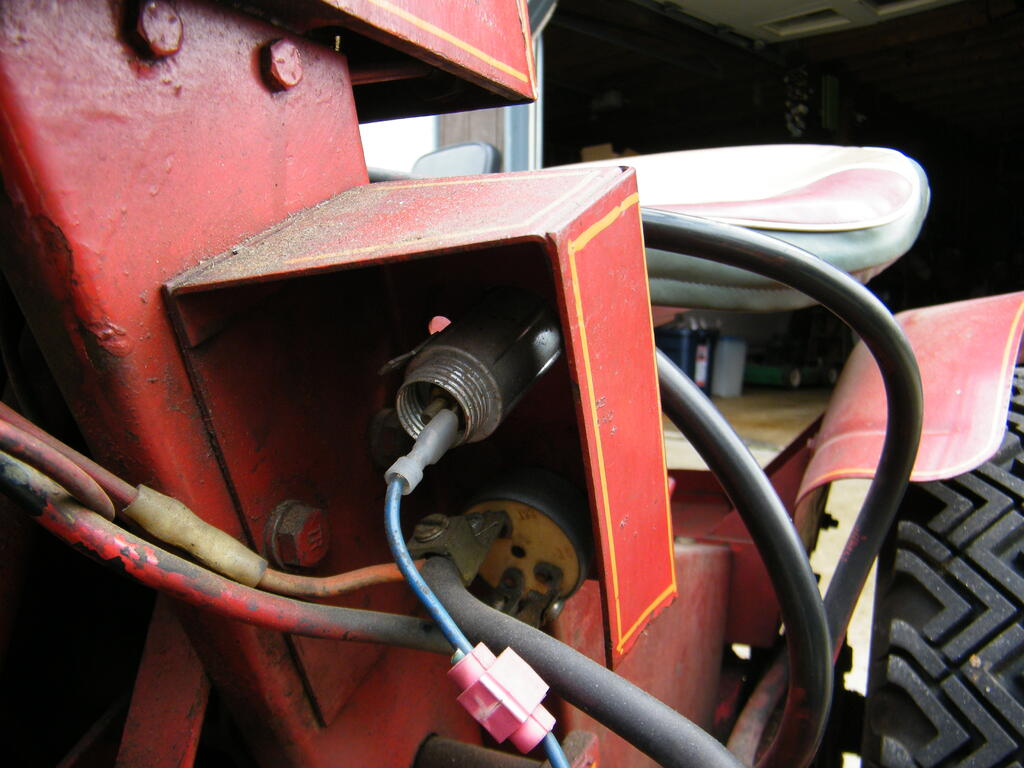

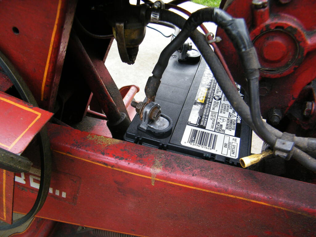

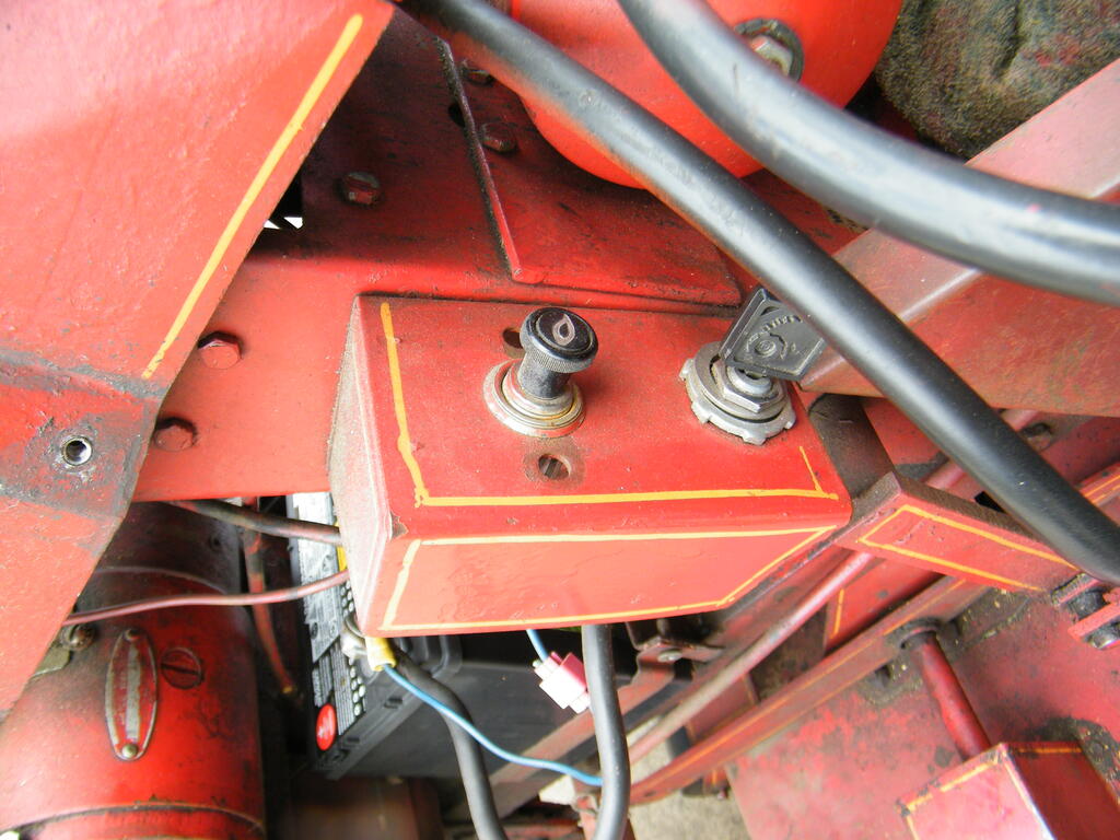

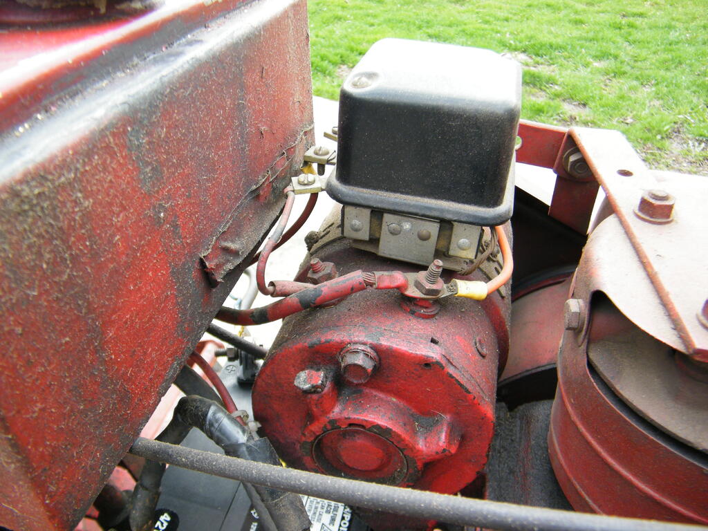

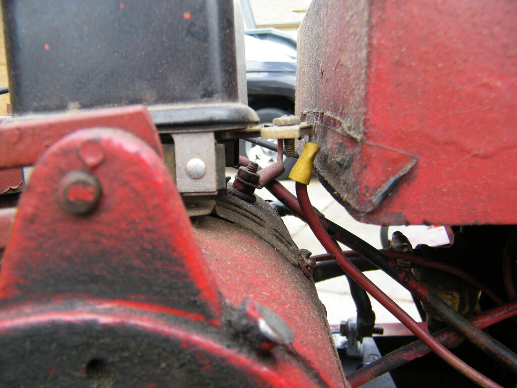

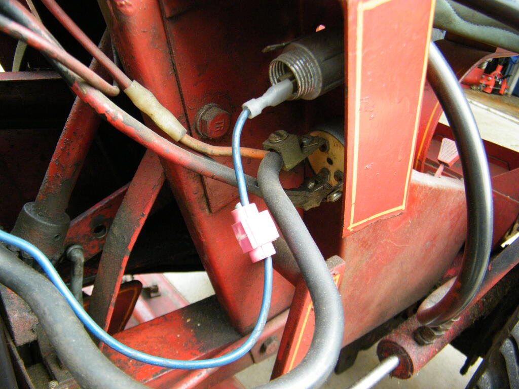

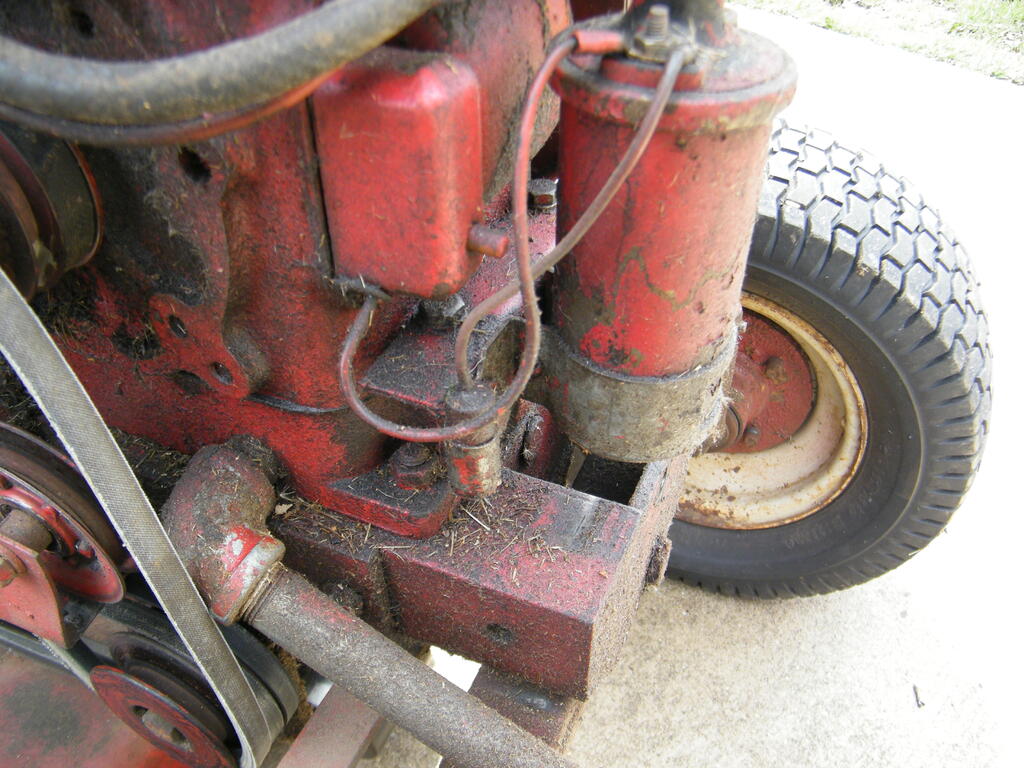

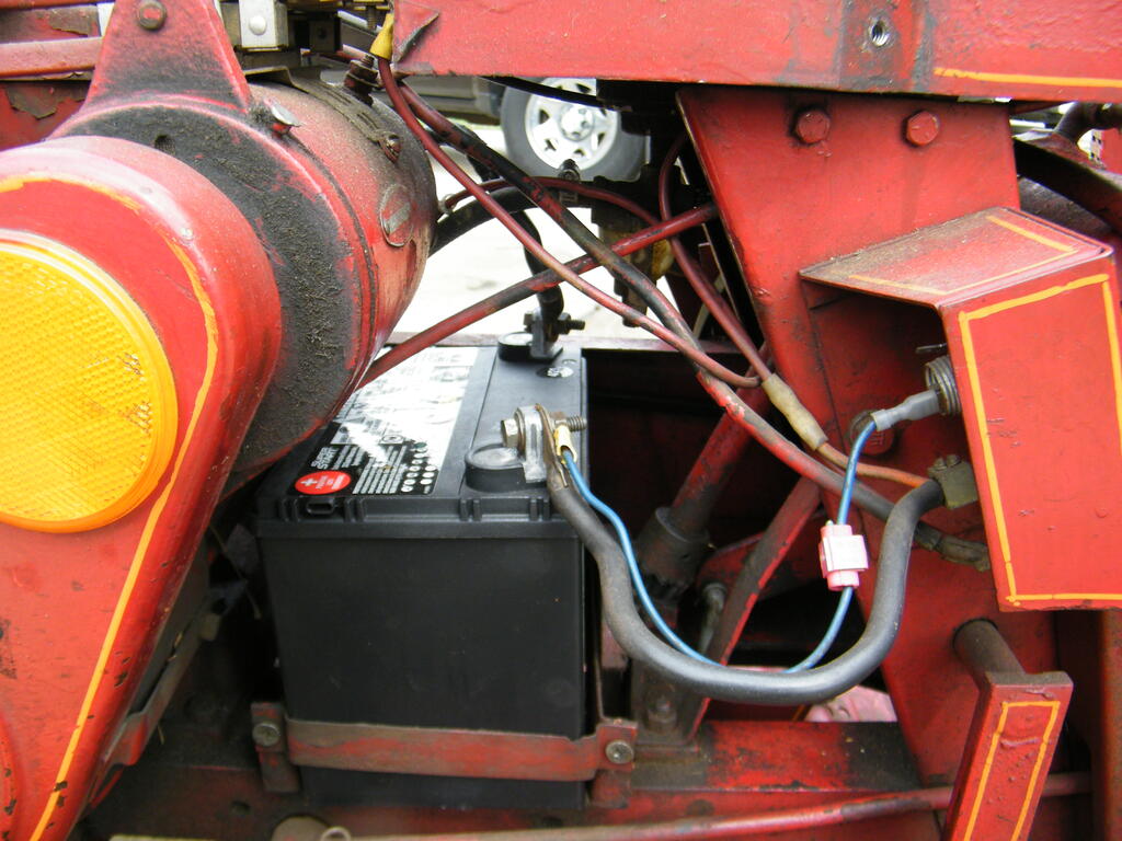

stevasaurus 23,652 #24 Posted April 23, 2022 Pictures...as you can see, plenty of bad spots. The ignition is 3 prong and uses a Wheel Horse key. It does have a working cigarette lighter above the ignition. It had lights, but I removed them. 2 1 Share this post Link to post Share on other sites
squonk 45,809 #25 Posted April 23, 2022 You got some big heavy cables there, That one to the gen itself looks a bit iffy. A good clean up of all the ends will help a lot. I'd be willing to bet the innards of the switch are ready to give up the ghost being as old as it is. 2 Share this post Link to post Share on other sites
