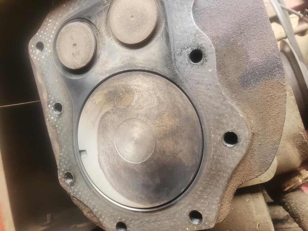

RJR49 159 #14 Posted April 16, 2022 Took the head off. Everything looked great! A guru that I rely on for all things automotive said "fix the blown thread, put it back together, and let's listen to it." Thought overheating timing, or just old age were probably the issue. Anyone have any thoughts on the best thread repair kits? He likes inserts over Helicoil type coils. 1 1 Share this post Link to post Share on other sites

Snoopy11 5,731 #20 Posted April 16, 2022 1 hour ago, RJR49 said: overheating timing, or just old age Those 2 things mean nothing to me. This isn't a "common" occurrence. Overheating, in my experience... does not cause spark plugs to eject and you would have been seeing other signs of potential issues. Off timing... would make it run like hell... and old age alone is NOT the cause. I would be wary of whoever you are listening to that told you that. Routine maintenance should help avoid some of the obvious reasons this might happen... i.e. tightening the spark plug every once in a while... adjusting the valves... checking over the machine. Proactive, not reactive. You still haven't shown pictures of the spark plug hole itself for our analysis. This is important for us to see. Be sure to check valve springs to ensure that they aren't broken or weak. Don Share this post Link to post Share on other sites

RJR49 159 #22 Posted April 17, 2022 Have to admit that I haven't checked how tight the plug was but given that only 2 threads didn't have aluminum stuck to them I'm confident a loose plug isn't the problem. I'm seriousely bad about the valve adjustment. I've been running Kohlers for over 50 years and never had a problem. Negligence for sure. However, the valves look to be in great shape. I have a picture of the Exhaust valve up and there isn't any evidence of burning. In fact, no discoloration anywhere. Weak springs may be the answer. But, that's just a guess too. Share this post Link to post Share on other sites
