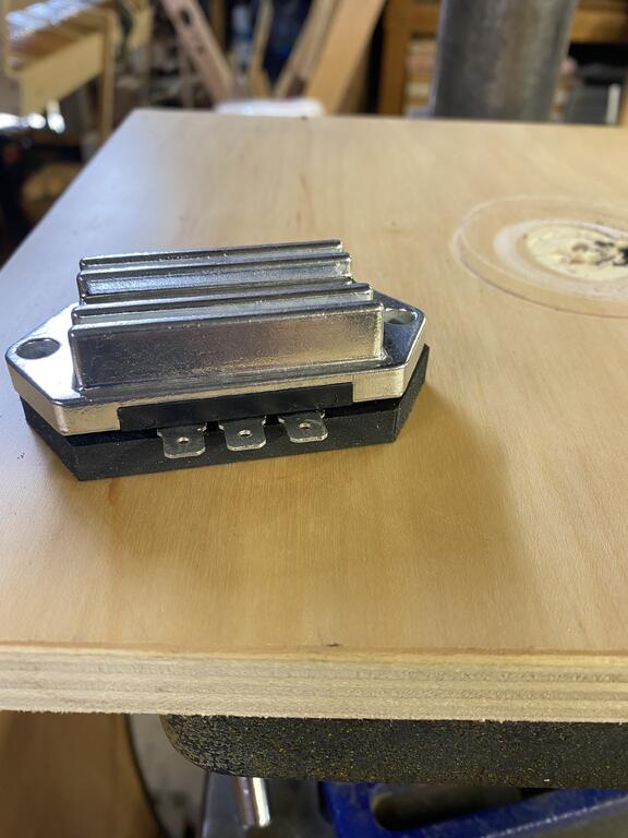

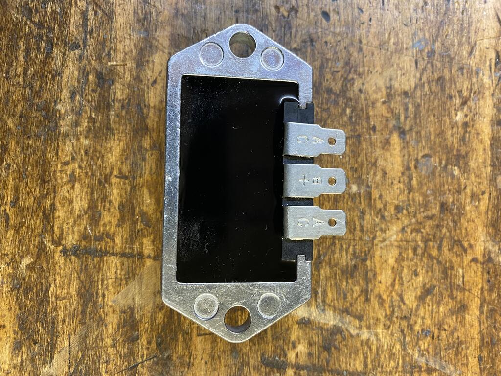

It’s been a while since I had one of these in my hand but isn’t this a problem having the contacts touch the mounting surface? They protrude past bottom of unit.

The contacts don't touch the mounting area (usually the blower cowling). Only the body of the VR (which is critical for its cooling and grounding) touches the mounting surface (I added a ground from the mounting screw on my Onan, just for giggles).

You are looking at the top side. When it's installed, the terminals will be clear of every thing.

If you wanted to mount it terminal side down, just put a couple of washers under the bolt holes to space it up.

Mounting it upside down will work but spacers should be made so tabs will not break. I don’t think that is the intended mounting way although it works. Cooling fins should be totally exposed to air. Contacts on this one stick past surface almost 1/8”. Bad design in my opinion . Another Chinese product.
I think I will make spacers and mount it the way it should be also isolating contacts with something.

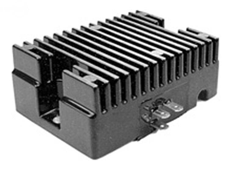

That style they put the cooling fins toward the engine fan. There should be a hole in the shroud that the body drops into. The fins are not really long enough for free air cooling.

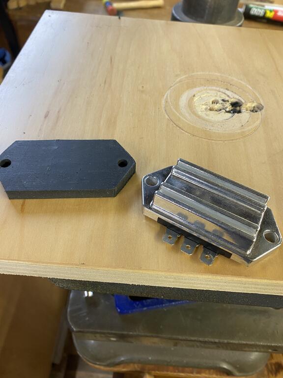

Then this style is perhaps created for a specific engine or location? I just want it to retrofit an engine without any specific place for it. I still think that this is a bad design.
 Made a rubber bottom for it and will add a dedicated ground for it, this way solving all problems.

 Yes that one would be for the later style engines, like a Magnum for example. The shroud will have a hole cut in it so that the cooling fins face toward the engine fan. The constant air from the fan cools the regulator.
Earlier free air cooling regulators look like this.

A VR needs substantial cooling. The short-fin versions will prematurely fail if not placed where the get adequate airflow.
