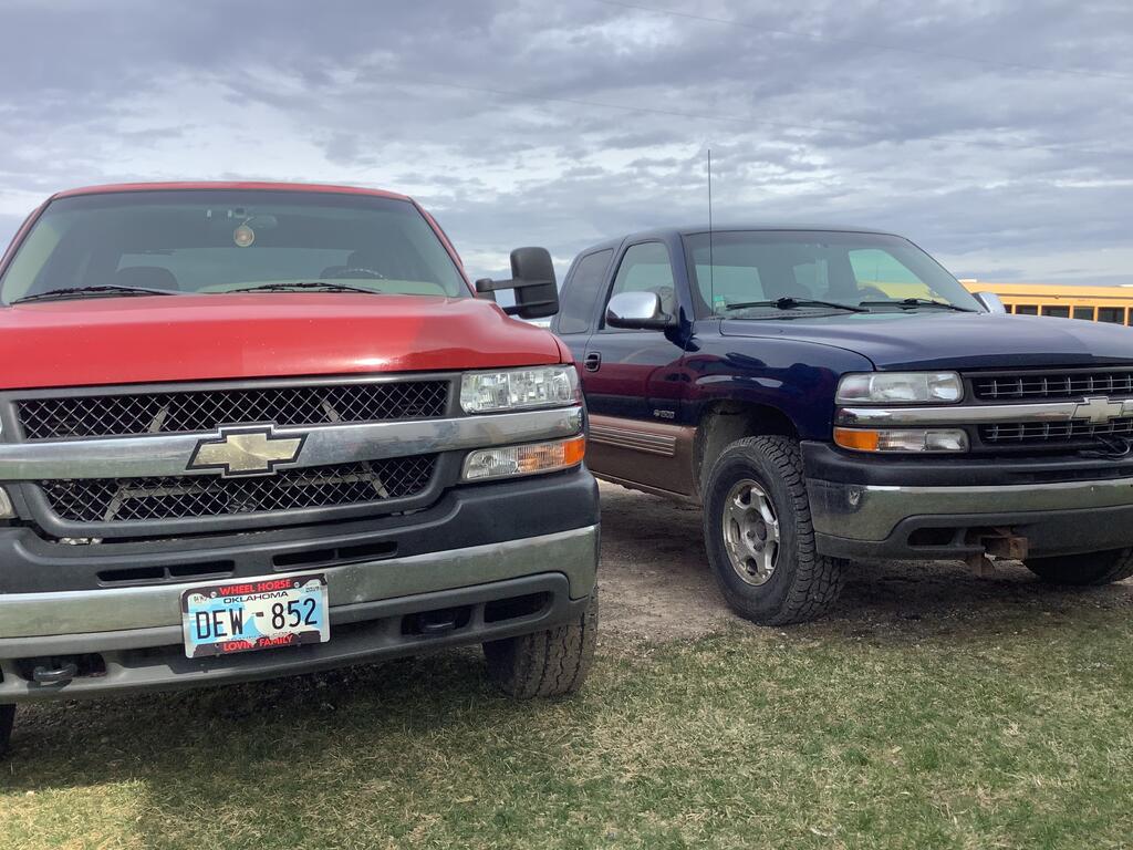

Pullstart 68,700 #30 Posted April 12, 2022 12 minutes ago, Snoopy11 said: 2001 Chevy Silervado... Regarding the truck, Kevin... are there any other details that I am missing? 2500 HD. I’ve always been amazed at how much more difficult it is to replace the transmission on a 1/2 ton vs 3/4 ton. I just realized the body is higher off the frame. If you look at the bumpers and grilles you’ll notice the fenders and headlights are much higher on the red one than the blue one. Share this post Link to post Share on other sites
