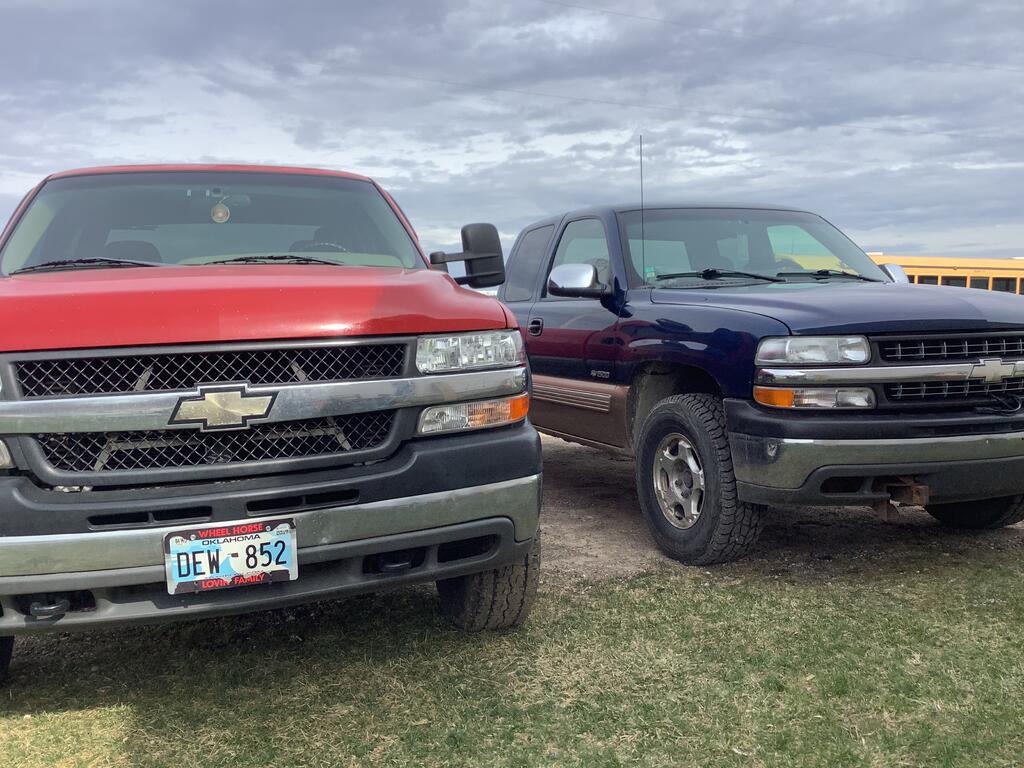

Pullstart 71,296 #1 Posted April 12, 2022 So, many people know of Norman, my ‘01 stick shift diesel. It’s only 2wd, but sits as high as 4x4 models of the same build. I have 245 tires on it to keep road resistance down and have made some improvements to the way it pumps air through the turbo system, raising engine efficiency. Norman’s main road partner will be our toy hauler, a 40’ long 13’3” high box on wheels. It’ll be right around 14,000 lbs of additional weight. I have the roof dam that must do some work pushing air up and over the trailer, because far less bugs get splat over it’s nose. I’ve recently been thinking of lowering the front end by turning the torsion bars down. Keeping the nose lower in my opinion should be once again more aerodynamic and I learned today that even air pressure on the tires from the air dam being lower helps. Thoughts? Ideas? For reference, here’s Norman standing tall next to my 1/2 ton 4x4. Unloaded, he gets about 5 mpg more than the little gasser. 2 Share this post Link to post Share on other sites

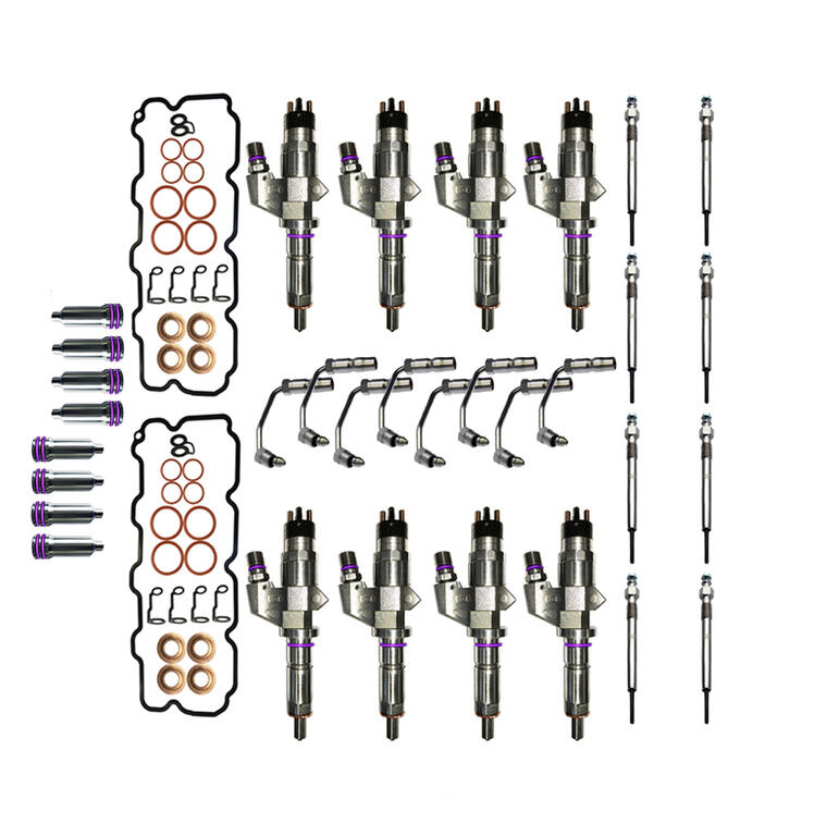

Pullstart 71,296 #16 Posted April 12, 2022 Speaking of saving money and being efficient, Norman’s smoking more when he drinks than Uncle Jim! Part of the money made from working on so many other vehicles lately, was just spent on a new set of injectors. Unfortunately, OEM Bosch is unobtainiumable right now, so I opted for a reman set with updated parts from www.dieselogic.com where they spoke with me on the phone and even involved the owner’s wisdom as to the entirety of my truck’s setup and got me set up with the best kit for my application. I have a feeling that these injectors had been replaced before but I don’t know for sure. I go through some coolant and it seems to have no evidence of where it goes, so I’m opting to replace the injector cups (that slide through the coolant pockets of the head) while I’m that far. 1 1 Share this post Link to post Share on other sites

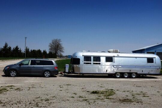

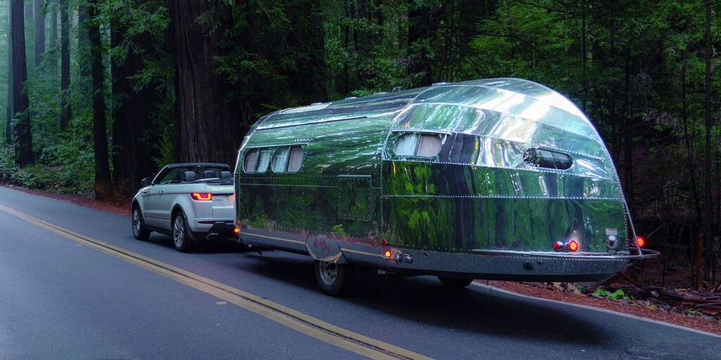

wh500special 2,464 #24 Posted April 12, 2022 (edited) The ultimate Aero camper is the Bowlus RoadChief. I bet your truck wouldn't even notice it behind it. The biggest efficiency yields will be had by slowing down. While the power required to overcome aerodynamic drag is linearly proportional to the coefficient of drag and the frontal area of the vehicle, it is proportional to the cube of the velocity. Little changes in speed quickly dwarf all other improvements that can be had by increasing tire pressure, increasing tire diameter, improving aero, and reducing weight. This is why semi trucks get fuel economy that isn't that far off of what a much lighter 1-ton with a fifth wheel camper gets. And also why the fuel economy hit from upsizing from a 23-foot Airstream to a 34-footer isn't what you'd expect. You can tow that with your minivan In the Mountains, weight is a big factor when going up and down hill, but speed again is the real fuel sucker. Save your wrenchin' knuckles and just slow down. Steve Edited April 12, 2022 by wh500special 6 1 Share this post Link to post Share on other sites
