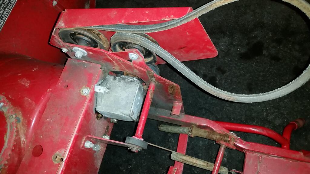

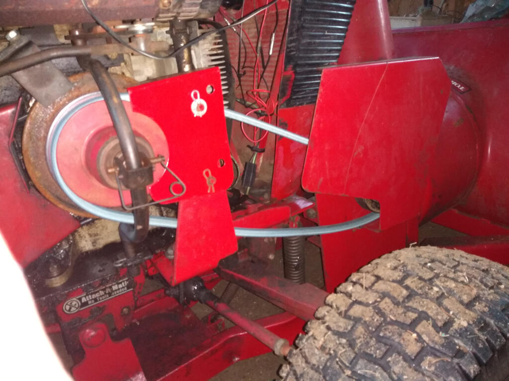

Chestnut 315 #5 Posted April 17, 2022 On 4/7/2022 at 8:50 PM, Chestnut said: he drive belt is a bit of a mystery. I think I finally got this sorted out but just wanted to check. I read in another post between @JCM and @ebinmaine that the belt was 5/8", 64.5" long. The snowblower had a 1/2" belt about that length, but I noticed in the raised position the small guard on the reverse idler was hitting the fixed idler and actually had little slots worn into it. The local tractor box store has the belts in 1" increments so I got a 65" belt. Way to long!? Went back and exchanged for a 62". Still not right. Then I noticed the second hole and moved the fixed idler to the forward hole in the bracket. Now 62" is way too short. Back to the store and try a 64. Can't quite get it on so back to get the original 65" belt. It's on but has a lot of slack when the snowblower is raised. Is this correct? Seems to spin fine with the snowblower down. Was this a design feature to stop the snowblower without disengaging the PTO when raising to reverse? Photo with the guards off is with snowblower down, guards on shows the slack with snowblower raised. Don't remember the PO's name, think it was Macgyver. 3 Share this post Link to post Share on other sites
WHX?? 51,702 #6 Posted April 18, 2022 (edited) Your belt is routed wrong and that idler may not be installed right. Check the manual. This is what it should look like. Edited April 18, 2022 by WHX?? 1 2 Share this post Link to post Share on other sites
ebinmaine 72,426 #7 Posted April 18, 2022 8 hours ago, Chestnut said: Don't remember the PO's name, think it was Macgyver Always got a kick outta the way he'd be able to make pretty much anything out of cotton balls and rubbing alcohol. 2 Share this post Link to post Share on other sites
Chestnut 315 #8 Posted April 18, 2022 8 hours ago, WHX?? said: Your belt is routed wrong and that idler may not be installed right. Check the manual. This is what it should look like. Thanks. I think the idler is installed wrong. No way I could pull the idler to that position. 2 Share this post Link to post Share on other sites

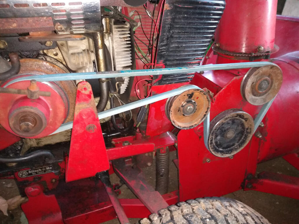

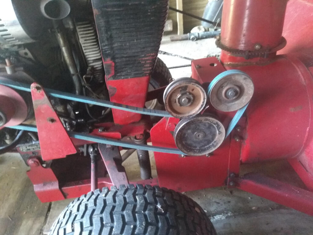

WHX?? 51,702 #9 Posted April 18, 2022 (edited) Gotta be... other best pic I got without pulling guards. This may not be correct as it was when it was new to me and before I got to set it up proper. Manual and IPL incase you no have.... 3318-459_1996-2000_44in_Snowthrower_IPL.pdf 3318-826 1996-1998 44in Snowthrower OM.pdf Edited April 18, 2022 by WHX?? 1 Share this post Link to post Share on other sites

Chestnut 315 #12 Posted April 18, 2022 48 minutes ago, WHX?? said: Gotta be... other best pic I got without pulling guards. This may not be correct as it was when it was new to me and before I got to set it up proper. Manual and IPL incase you no have.... 3318-459_1996-2000_44in_Snowthrower_IPL.pdf 146.09 kB · 0 downloads 3318-826 1996-1998 44in Snowthrower OM.pdf 762.31 kB · 0 downloads Thanks for the additional photo and manuals. I already had manuals but the belt routing completely escaped me. I haven't been out to look at it this morning but I need to see whether it has the right spring on the idler.I didn't try pulling the idler back as far as yours because it didn't gain me anything with the belt routed wrong. Hope it's the right spring. No longer available and not a common size. Another thread gives the length at about 14.5 inches long. 1 Share this post Link to post Share on other sites

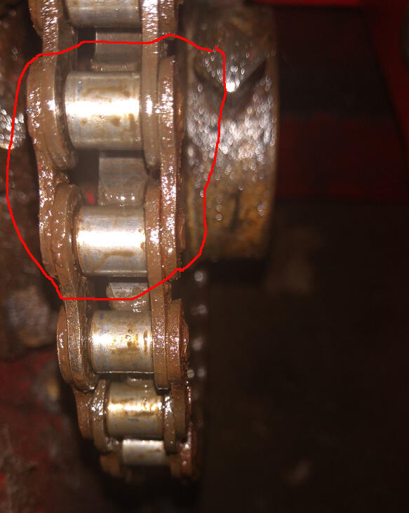

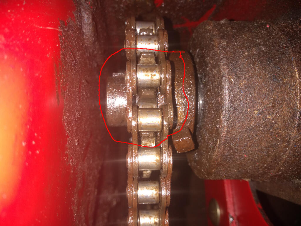

lynnmor 7,799 #17 Posted April 19, 2022 That chain is ready to let go, needs an immediate replacement. The sprockets are spent as well, putting new chain on worn sprockets will cause rapid wear. With all new parts and applying chain oil after every use, the system will last indefinitely, The only serious wear item is the adjustment block, it has been addressed in other posts several times. 1 Share this post Link to post Share on other sites
