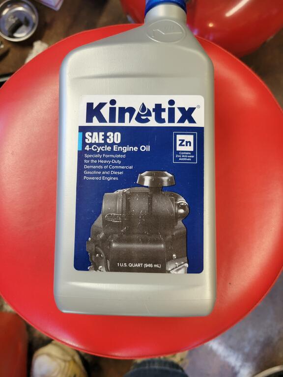

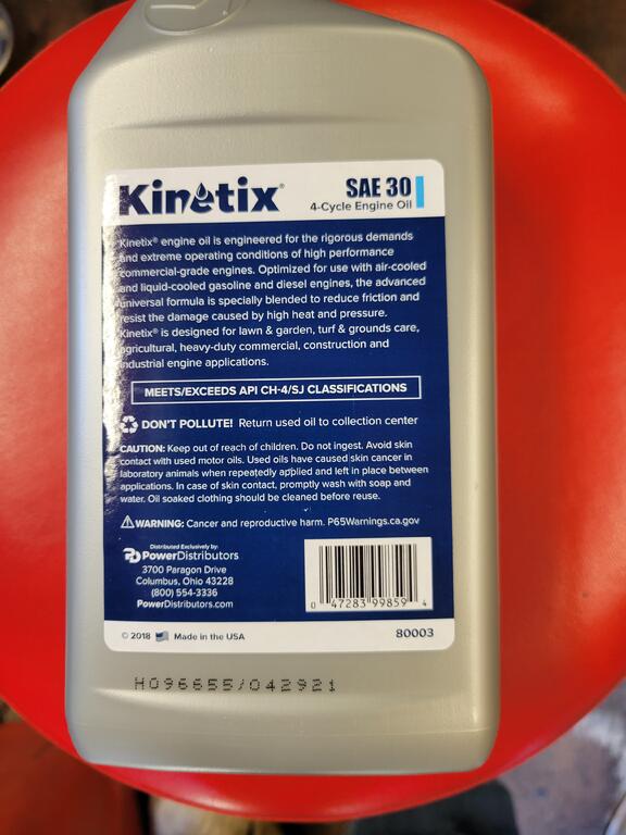

ebinmaine 80,302 #2 Posted April 4, 2022 There's a bunch of different information about which oil to use. You'll find SJ grade, I believe, has the zinc phosphate content you're looking for. Several Redsquare members use diesel oils to attain that. I personally use Kinetix brand. 3 Share this post Link to post Share on other sites

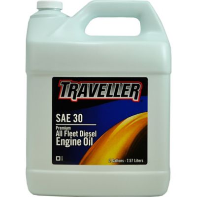

SylvanLakeWH 32,142 #4 Posted April 4, 2022 I use this: 9 6 Share this post Link to post Share on other sites
Achto 32,347 #5 Posted April 4, 2022 (edited) 39 minutes ago, RDS said: The manual for my B80 with a Kohler K181S specs SAE 30W SC. At the time an API rating of SC was the newest/highest quality. As oil has improved over the years, the API rating has progressed to show the improvements. SF, SG, SH, SJ, etc. With this given info, even though the lubricating and suspension quality has improved one thing that has decrease is the level of zinc used (EPA mandates). Diesel oils retain more zinc content. You can also add a zinc additive to your oil, if you wish. https://www.amazon.com/Rislone-4405-Supplement-Concentrate-Treatment/dp/B0075559UY/ref=asc_df_B0075559UY/?tag=hyprod-20&linkCode=df0&hvadid=312198323731&hvpos=&hvnetw=g&hvrand=13449251567463005992&hvpone=&hvptwo=&hvqmt=&hvdev=c&hvdvcmdl=&hvlocint=&hvlocphy=9019452&hvtargid=pla-567498281214&psc=1 Edited April 4, 2022 by Achto 6 Share this post Link to post Share on other sites
briankd 833 #6 Posted April 5, 2022 1 hour ago, SylvanLakeWH said: I use this: this oil seems to be scarce in my area my local malwart used to carry it shelf been bare now over 2 weeks . found it in quarts at Menards in their outdoor power section they don't carry it in 5 quart jugs . got me 8 quarts and found the rislone zinc additive at local O REILIES auto part's 8 bucks a can enough to do 3 tractors and one push mower 5 Share this post Link to post Share on other sites

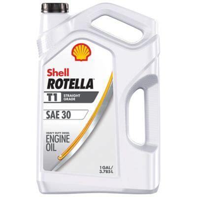

8ntruck 9,219 #7 Posted April 5, 2022 I prefer the Shell Rotella. Our old engines will be happier with an oil with higher zinc content. The zinc improves the extreme pressure properties of the oil, winch is what is needed with the old bearing and lifter/camshaft technology. 1 4 Share this post Link to post Share on other sites

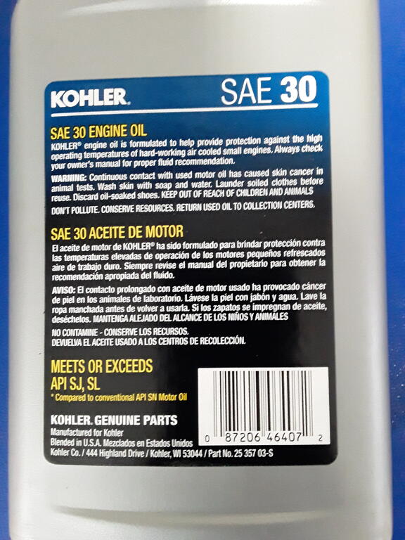

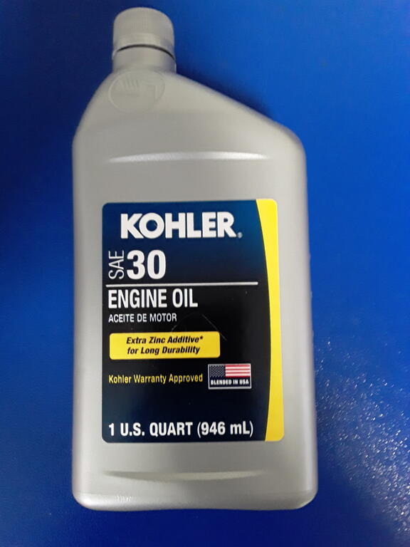

killroy 36 #16 Posted April 20, 2022 Was at my local mower parts place and found this 2 Share this post Link to post Share on other sites
lynnmor 9,013 #17 Posted April 20, 2022 1 hour ago, killroy said: Was at my local mower parts place and found this It should be fine for Wheel Horse tractors. Note that the classification only goes to SJ which is a good thing, higher classifications are the reduced zinc oils for engines with catalytic converters. @ebinmaine uses it. Kohler also sells a similar oil. Those oils that are SN and higher will allow more wear, I would avoid them. 2 Share this post Link to post Share on other sites
killroy 36 #18 Posted April 20, 2022 That oil has added zinc 2 Share this post Link to post Share on other sites

johnnymag3 2,647 #24 Posted May 4, 2022 On 4/4/2022 at 7:20 PM, SylvanLakeWH said: I use this: I use this also....Amazon drops it right off at my house 1 day after I call. 16.99 1 Gallon 4 1 Share this post Link to post Share on other sites
