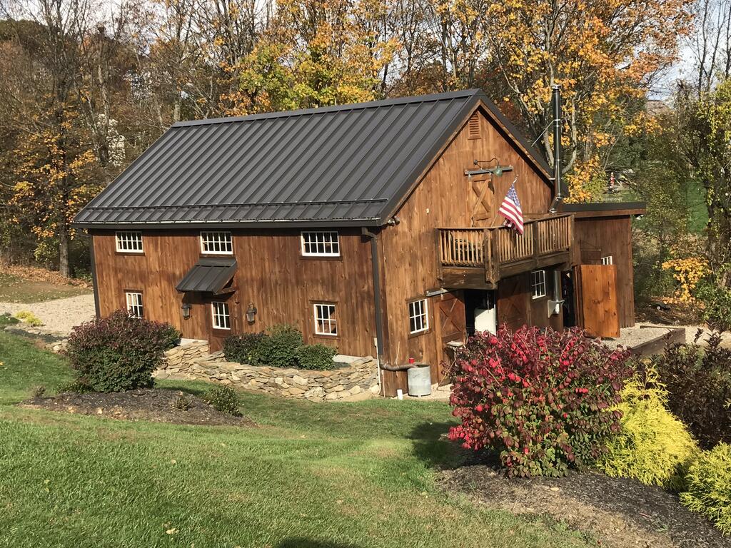

stevebo-(Moderator) 8,742 #2 Posted March 24, 2022 My barn is pine shiplap with “clear” oil based stain. Turned fairly dark once stained. 2 4 Share this post Link to post Share on other sites
ebinmaine 80,765 #3 Posted March 24, 2022 14 minutes ago, stevebo said: My barn is pine shiplap with “clear” oil based stain. Turned fairly dark once stained. Beautiful setup. How long has that been in place and the stain on it? 1 Share this post Link to post Share on other sites
stevebo-(Moderator) 8,742 #4 Posted March 24, 2022 I built the barn in 2014 and have stained it twice since then. Each time it gets darker. The pic above is with just one coat. 2 1 Share this post Link to post Share on other sites

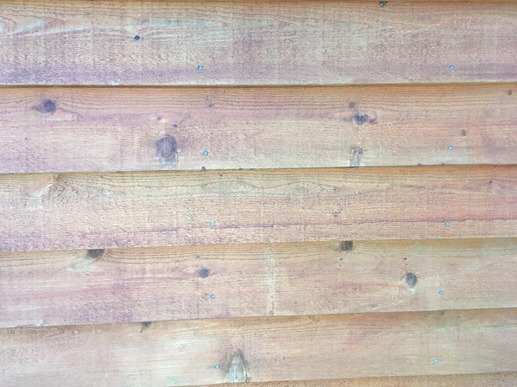

dcrage 636 #13 Posted March 24, 2022 (edited) The attached pictures shows the Behr product I use and an example of what it looks like after 5+ years. This is western red cedar and there is a cedar tint in the stain. Avoid treatments containing linseed oil products. There are microorganisms that love to eat linseed oil components causing the black ‘crap’ seen on wood structures a year or two after treatment. Wood siding can be ‘freshened’ before retreating using a water solution of TSP and bleach with plenty of elbow grease! Granted it is a lot of work but you don’t remove wood layers like what happens with power washing. Edited March 24, 2022 by dcrage 1 Share this post Link to post Share on other sites
