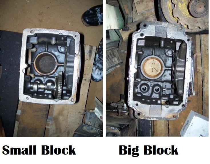

Achto 32,891 #26 Posted March 17, 2022 Just now, 953 nut said: The 241AS is what we call a small block I have seen 241's with a 301 casting on the block behind the fly wheel. K241, K301, K321 all share the same cylinder head. Share this post Link to post Share on other sites
953 nut 70,058 #27 Posted March 17, 2022 1 minute ago, Achto said: I have seen 241's with a 301 casting on the block behind the fly wheel. K241, K301, K321 all share the same cylinder head. Yes, on the big block but the small block that was used on the 1045 and 1055 is a totally different block and pan. Both of these are K-241 but the small block is K-241 AS. Piston rod crank cam are all the same, oil pan isn't. 1 1 1 Share this post Link to post Share on other sites
Achto 32,891 #28 Posted March 17, 2022 Thanks @953 nut!! Got my schooling for the day. More info to put in my memory bank. 1 1 Share this post Link to post Share on other sites
857lover 291 #29 Posted March 17, 2022 31 minutes ago, 953 nut said: The 241AS is what we call a small block, pan from it will not fit a BIG Block. Your best bet is to build a taller hood hinge and steering tower. Your best it won’t fit on a 301 ?? Share this post Link to post Share on other sites
Lee1977 7,807 #30 Posted March 17, 2022 (edited) If you have a wide base Kohler you can't just bolt on a narrow base the block is different, Go to engines there is a tread at the top by Kelley on Kohler engine types. It show the different types. Edited March 17, 2022 by Lee1977 1 Share this post Link to post Share on other sites
953 nut 70,058 #31 Posted March 17, 2022 1 minute ago, 857lover said: it won’t fit on a 301 ?? NOPE. You could raise the hood up or put a cool looking hood scoop over the engine. The short oil pan @daveoman1966 showed you is for the small block. Share this post Link to post Share on other sites
kpinnc 19,036 #32 Posted March 18, 2022 This is confusing. Small blocks were at least in my world K141, 161, and 181. Big block was anything K241 and above. The base being different is the only difference with the "AS" and similar models. Everything internal is the same as with the "S" or any other product line for the same series. John Deere and Cub were common users of that style block and oil pan. I still think that is a big block configuration. Maybe small oil pan, or small mounting area, but I think it's still a big block. Just my opinion... 1 1 Share this post Link to post Share on other sites
pfrederi 21,274 #33 Posted March 18, 2022 10 hours ago, kpinnc said: This is confusing. Small blocks were at least in my world K141, 161, and 181. Big block was anything K241 and above. The base being different is the only difference with the "AS" and similar models. Everything internal is the same as with the "S" or any other product line for the same series. John Deere and Cub were common users of that style block and oil pan. I still think that is a big block configuration. Maybe small oil pan, or small mounting area, but I think it's still a big block. Just my opinion... A big block...(K241 up to K341) may be a big base or a small base. Oil pans are not interchangeable... 3 1 Share this post Link to post Share on other sites

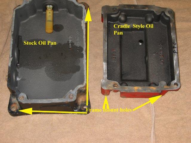

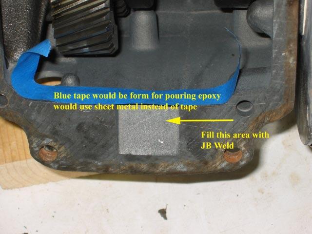

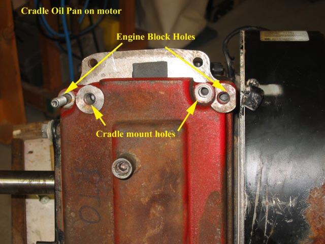

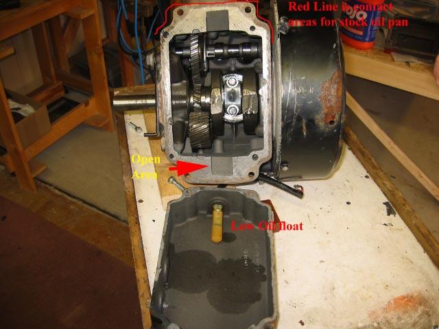

pfrederi 21,274 #35 Posted March 18, 2022 It is however possible to fit a small base oil pan to a big base block...Did it 14 years ago. I used a small base cradle (shaker mount) oil pan and married it to a big base Magnum 12. I would "assume" the shallow pans mentioned above would have the same bolt pattern If the pan doesn't have the under mount holes maybe a J bolt hook up for that side??? 2 1 Share this post Link to post Share on other sites

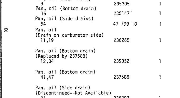

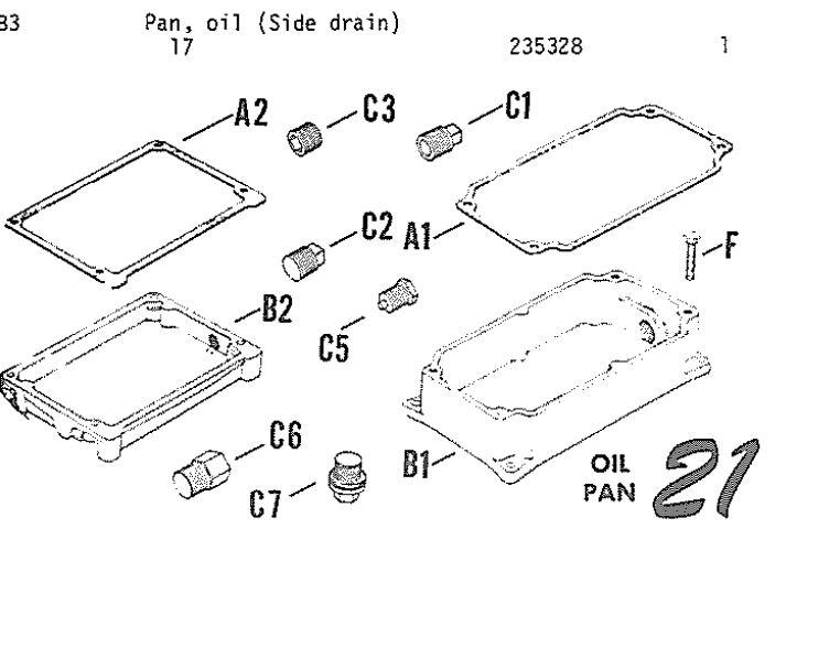

pfrederi 21,274 #37 Posted March 18, 2022 This gets confusing. 1055/1075 used Spec # 46219 (if the chart is correct) It had Oil Pan variant 19 which is a shallow pan drain on carb end. (B2 in picture.) 236265 however 1057/1077 used spec # 46333 (if chart is correct) it had oil pan variant 25 which is deeper pan (B1) 237763 Connecting rods 1055/75 used 235383 1057/1077 used 235139 1 1 Share this post Link to post Share on other sites

ebinmaine 81,047 #40 Posted March 18, 2022 1 hour ago, pfrederi said: This gets confusing. 1055/1075 used Spec # 46219 (if the chart is correct) It had Oil Pan variant 19 which is a shallow pan drain on carb end. (B2 in picture.) 236265 however 1057/1077 used spec # 46333 (if chart is correct) it had oil pan variant 25 which is deeper pan (B1) 237763 Connecting rods 1055/75 used 235383 1057/1077 used 235139 1967 was the first year for the long frame with tall hood. Not at all surprising that the 10 HP engine changed as well. 1 1 Share this post Link to post Share on other sites

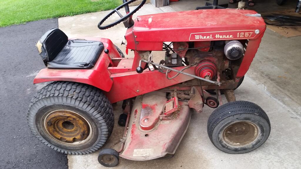

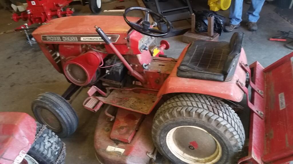

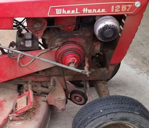

pfrederi 21,274 #47 Posted March 19, 2022 Using one of WHX?? pics you can see the difference in the oil pan when a big block is used on a long frame 1257 vs a short frame 1075 3 Share this post Link to post Share on other sites
kpinnc 19,036 #48 Posted March 19, 2022 (edited) So I'm tracking here- the shorter pan has the little oil dipper "trough" cast into it. Does it fit between the frame rails? 2 hours ago, pfrederi said: Using one of WHX?? pics you can see the difference in the oil pan Until this thread I never thought that style Kohler block and pan was of use to me. I see plenty of these engines for sale and tend to stay away from them. Thanks to all for clearing that up! I might have to pick one up for the heck of it... Edited March 19, 2022 by kpinnc 1 Share this post Link to post Share on other sites
littleredrider 409 #49 Posted March 19, 2022 I have a 16 horse on my 606 with a shallow pan from a JD. Pan itself bolted up fine, but needed to drill holes in the frame. Not a huge deal tho. This is also isn't a genny style motor, but regular points/bolt on starter. I trimmed the oil slinger, easy to do. Brian millers page shows how to swap pans as Pfrederi did.... 1 Share this post Link to post Share on other sites
