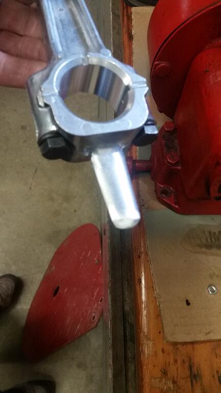

squonk 48,287 #7 Posted March 17, 2022 (edited) Yes you need the shallow pan and the correct connecting rod to go with it. A K301 will use a lot more fuel than a K181. You'll get stranded in the woods. Edited March 17, 2022 by squonk 1 2 Share this post Link to post Share on other sites
WHX?? 58,324 #8 Posted March 17, 2022 Or bob the rod....or use a Cub short pan and hack the frame up to fit. You would also need a different pulley. Better idea is to look for a roller long frame to put it in. Share this post Link to post Share on other sites

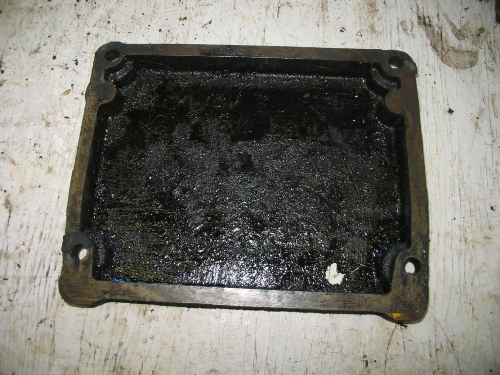

857lover 291 #10 Posted March 17, 2022 i have a k301 with a flat oil pan it is 2and a half inches tall is there any thinner pans out there i’m having some clearance issues that i’m trying to resolve 1 Share this post Link to post Share on other sites
Maxwell-8 4,371 #11 Posted March 17, 2022 29 minutes ago, 857lover said: i have a k301 with a flat oil pan it is 2and a half inches tall is there any thinner pans out there i’m having some clearance issues that i’m trying to resolve http://gardentractorpullingtips.com/oilpan.htm There are diffrent oil pans, but you will need to found a shorter oilslinger Share this post Link to post Share on other sites

Achto 32,891 #14 Posted March 17, 2022 25 minutes ago, Maxwell-8 said: but you will need to found a shorter oilslinger Or grind your existing oil slinger down. 1 Share this post Link to post Share on other sites

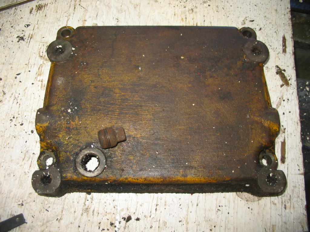

857lover 291 #15 Posted March 17, 2022 yeah that’s what i’ve heard but what do i look up to find one of theese pans what did they come off of Share this post Link to post Share on other sites
Achto 32,891 #16 Posted March 17, 2022 Just now, 857lover said: you caught me red handed Find the part number for an oil pan for a 1045, These were big block's in a short frame from the factory. Share this post Link to post Share on other sites
857lover 291 #17 Posted March 17, 2022 2 minutes ago, Achto said: Find the part number for an oil pan for a 1045, These were big block's in a short frame from the factory. that’s is going to be a little difficult but i will see what i can find Share this post Link to post Share on other sites
Achto 32,891 #18 Posted March 17, 2022 (edited) 7 minutes ago, 857lover said: that’s is going to be a little difficult but i will see what i can find A 1045 came with a K241AS. Yes I know that is a 10hp engine but the oil pan should fit a K301. A quick search found some flat pans on Edited March 17, 2022 by Achto 1 Share this post Link to post Share on other sites
857lover 291 #19 Posted March 17, 2022 (edited) 4 minutes ago, Achto said: A 1045 came with a K241AS. Yes I know that is a 10hp engine but the oil pan should fit a K301. A quick search found some flat pans on what are you putting in the search bar i can’t seem to find one i see some that came off a cub but they have like a drain plug at the bottom that would interfere Edited March 17, 2022 by 857lover Share this post Link to post Share on other sites
857lover 291 #20 Posted March 17, 2022 6 minutes ago, Achto said: A 1045 came with a K241AS. Yes I know that is a 10hp engine but the oil pan should fit a K301. A quick search found some flat pans on or if you could send me the link i’d really appreciate that Share this post Link to post Share on other sites
Achto 32,891 #21 Posted March 17, 2022 (edited) 15 minutes ago, 857lover said: if you could send me the link i’d really appreciate that Did not find one for a WH per say. Important thing to look for is the threaded mounting holes in the bottom for the right hand side mounting bolts. You could also try posting in the want adds here for a 1045 oil pan. Edited March 17, 2022 by Achto Share this post Link to post Share on other sites

daveoman1966 3,884 #24 Posted March 17, 2022 Is this what you want... It is approx 1-1/4" deep (outside). Share this post Link to post Share on other sites
953 nut 70,058 #25 Posted March 17, 2022 22 minutes ago, Achto said: A 1045 came with a K241AS. Yes I know that is a 10hp engine but the oil pan should fit a K301. A quick search found some flat pans on The 241AS is what we call a small block, pan from it will not fit a BIG Block. Your best bet is to build a taller hood hinge and steering tower. Your best Share this post Link to post Share on other sites
