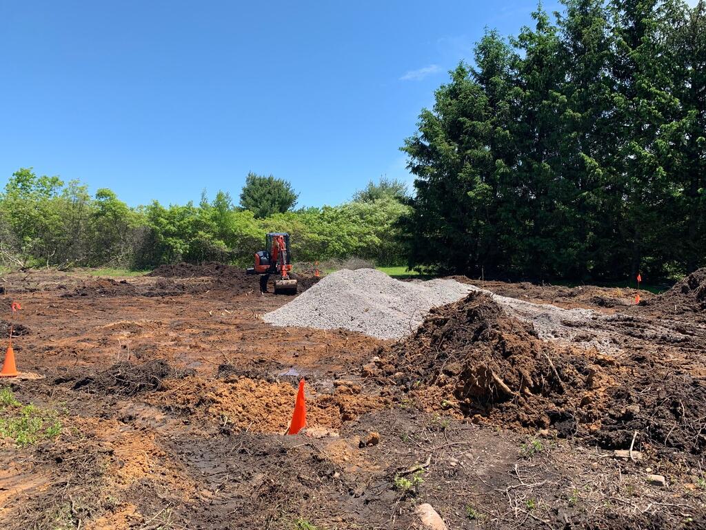

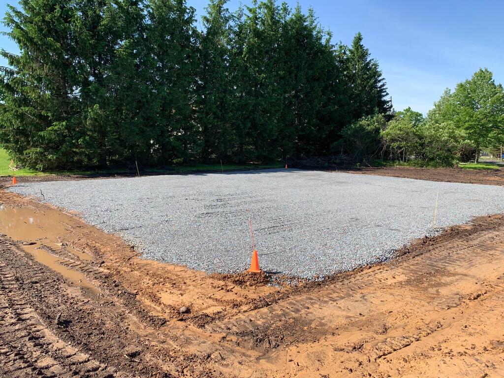

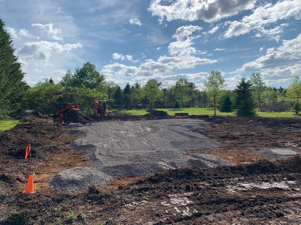

kwalshy 267 #133 Posted June 14, 2022 I just finished clearing out the scrub oak, what a PITA that stuff is. However, I did get plenty of seat time on the Kubota clearing the build site. The pad is now in with 10 loads of compacted modified. I had enough material placed for a perimeter all around the building of at least 5 feet, and enough modified in for a future concrete apron in front of the garage. 2 2 Share this post Link to post Share on other sites
ebinmaine 81,283 #134 Posted June 14, 2022 2 minutes ago, kwalshy said: compacted modified Just out of curiosity, what exactly is this substance? Share this post Link to post Share on other sites
kwalshy 267 #135 Posted June 14, 2022 36 minutes ago, ebinmaine said: Just out of curiosity, what exactly is this substance? It's also known as 2A Modified. Where I live the quarries are plentiful with limestone and this is what they make their 'modified' with - crushed stone & obviously some stone dust that comes with the process of crushing the limestone. 2A stone is typically no larger than 1.5"-2" in size. Modified compacts very well for a solid subbase. I installed this b/c at one point I'd like to pour a concrete floor in the pole barn. 1 Share this post Link to post Share on other sites
cschannuth 3,821 #136 Posted June 15, 2022 @ebinmaine in Missouri that would be called minus. You can either get clean rock or minus which still has the dirty fines from the crushing process. Clean rock works great if drainage is needed. 1 inch minus is used here a lot for use under concrete. As stated above, when compacted, it provides a very solid surface. 1 Share this post Link to post Share on other sites
ebinmaine 81,283 #137 Posted June 15, 2022 5 hours ago, cschannuth said: @ebinmaine in Missouri that would be called minus. You can either get clean rock or minus which still has the dirty fines from the crushing process. Clean rock works great if drainage is needed. 1 inch minus is used here a lot for use under concrete. As stated above, when compacted, it provides a very solid surface. You guys got me curious now. I think up around these parts we call that stone dust and then designate the size... Share this post Link to post Share on other sites
8ntruck 9,420 #138 Posted June 15, 2022 Minus, modified. Is that the same a crusher run rock? 1 Share this post Link to post Share on other sites
kwalshy 267 #139 Posted June 15, 2022 1 hour ago, 8ntruck said: Minus, modified. Is that the same a crusher run rock? Crush run typically has a stone size no larger than 3/4" 2 Share this post Link to post Share on other sites

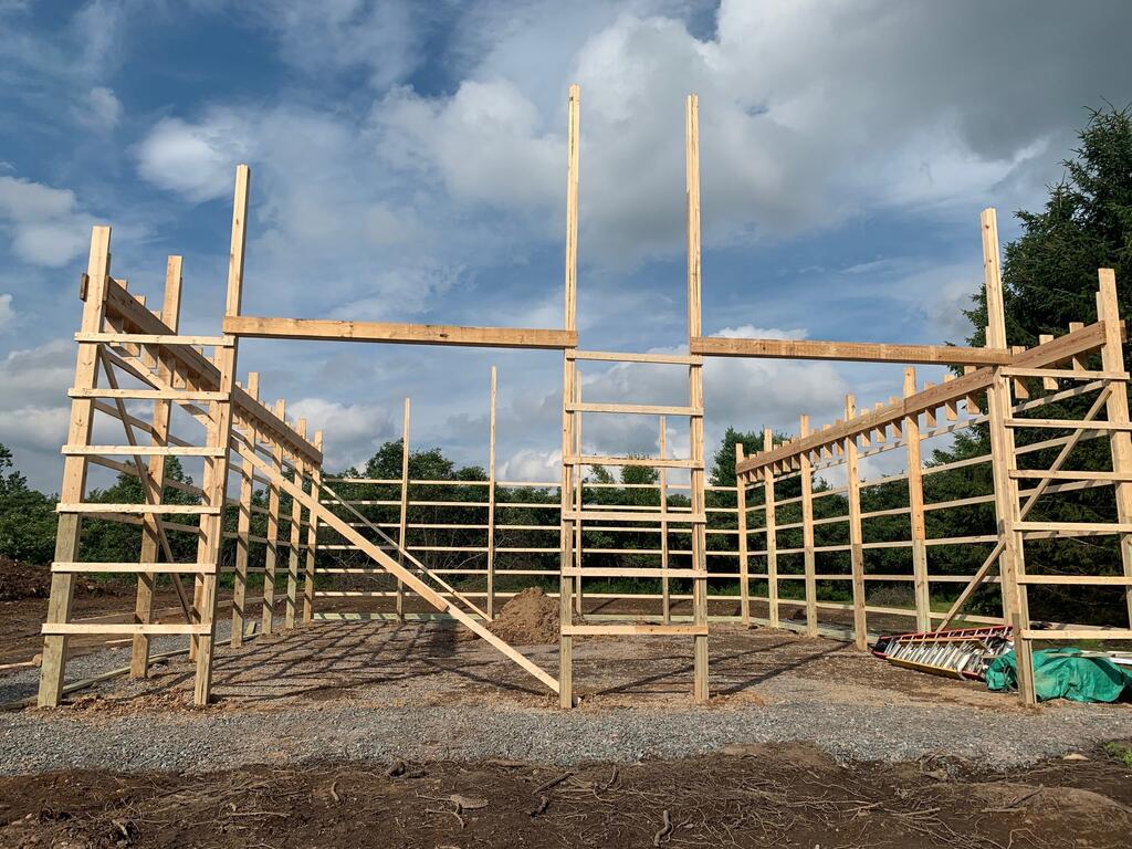

kwalshy 267 #142 Posted July 19, 2022 The framing started yesterday. The crew accomplished a lot. I found one post in the front that was out of plumb, but they brought it back in so the garage door will be square. If anyone sees anything not right with the framing, please let me know! Thanks! 2 Share this post Link to post Share on other sites
rjg854 13,455 #143 Posted July 19, 2022 Looks good to me, the only question I have is why those truss blocks hang so far below the top plates. We would usually leave them either flush or just above the bottom of the plates. I don't know if you plan on insulating, or how, but that would be a lot to go around. That's my 2 cents. 1 Share this post Link to post Share on other sites
kwalshy 267 #144 Posted July 19, 2022 (edited) 4 hours ago, rjg854 said: Looks good to me, the only question I have is why those truss blocks hang so far below the top plates. We would usually leave them either flush or just above the bottom of the plates. I don't know if you plan on insulating, or how, but that would be a lot to go around. That's my 2 cents. Thank you for that comment. I didn't think about the extra work that would be for me when I insulate. All those blocks would be annoying to deal with! So thanks to your comment, I spoke with builder & there will be another header going up & attached to the posts & truss blocks. Edited July 19, 2022 by kwalshy 1 Share this post Link to post Share on other sites

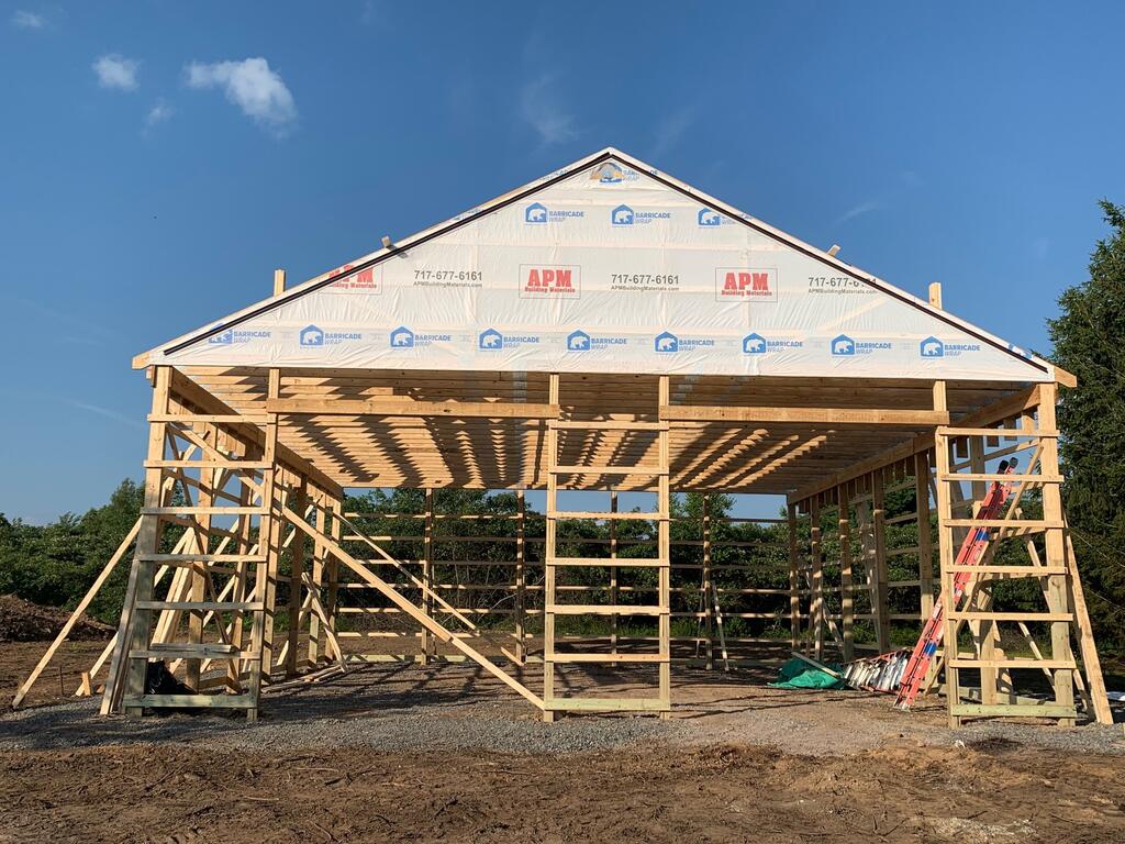

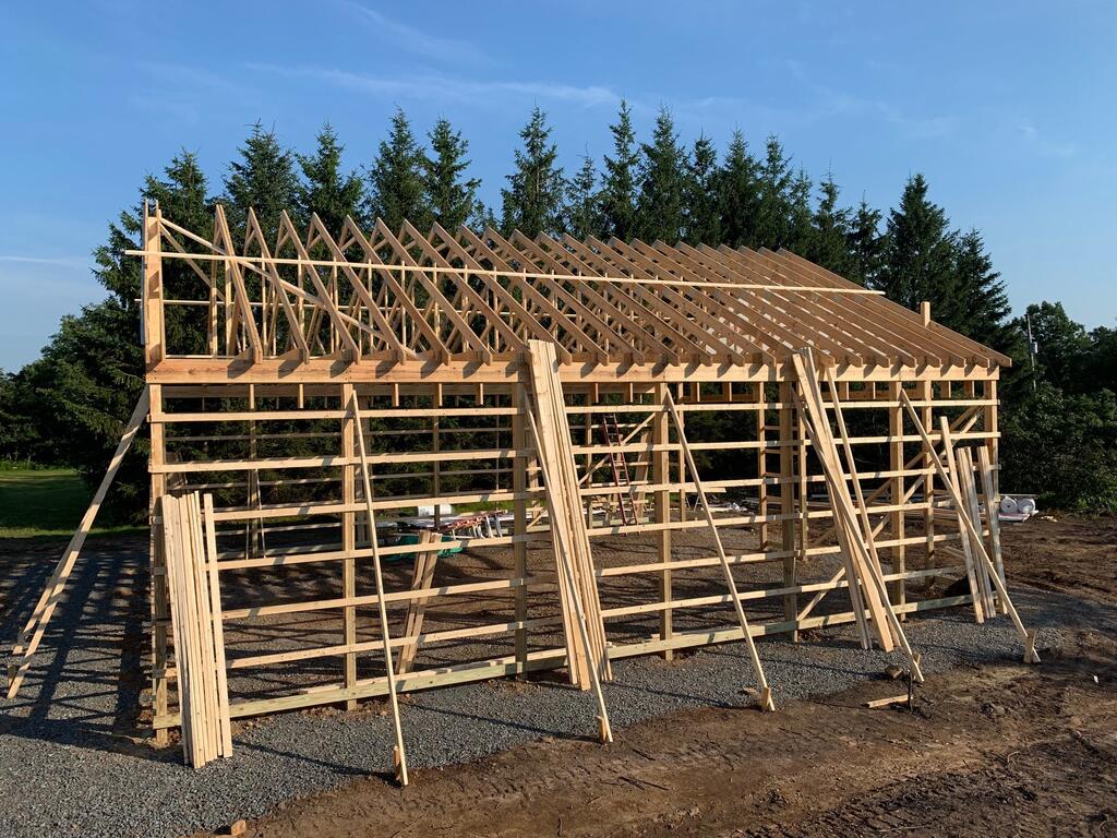

kwalshy 267 #145 Posted July 20, 2022 More progress pics. All trusses went up yesterday. You can see the double trusses at the end with a 4ft space to next truss, this is for my access to attic, all other trusses are 2ft OC. I will build attic stairs and install a floor in the future. 4 1 Share this post Link to post Share on other sites
