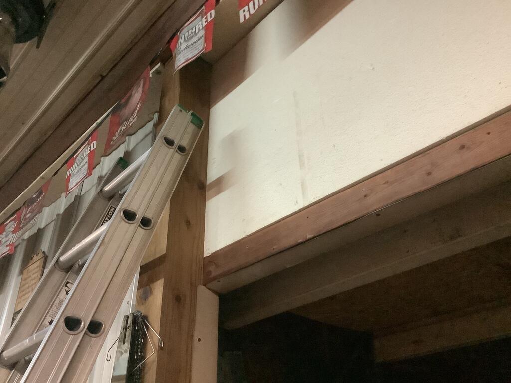

Ed Kennell 47,955 #2 Posted February 28, 2022 I built my 24X32 in 2020. I have 12' under the roof trusses with an 18X10' door. Mine is not insulated, but I did put 3/8" foam under the roof steel to prevent indoor rain. I added the concrete floor after it was built using the 2x10 around the base as the form. I did taper the floor to floor drains at critical locations. Very useful for pressure washing and working on water cooled outboard motors. 3 Share this post Link to post Share on other sites

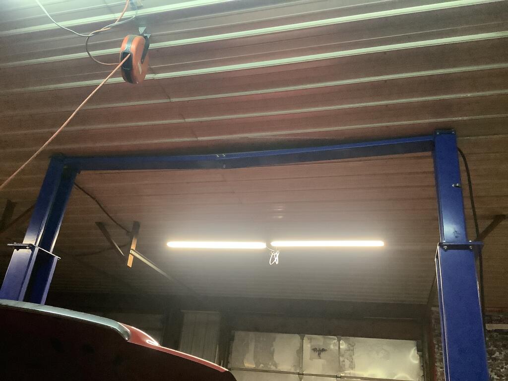

Pullstart 71,564 #7 Posted March 1, 2022 (edited) You’ll need at least 12’ for a two post lift, but if you’re going with 14’, 16’ is a good height for pallet racking… insulation? YES! Get as much as you can, preferably the 6” insulation batting at minimum. You’ll appreciate that later Edited March 1, 2022 by Pullstart 4 Share this post Link to post Share on other sites

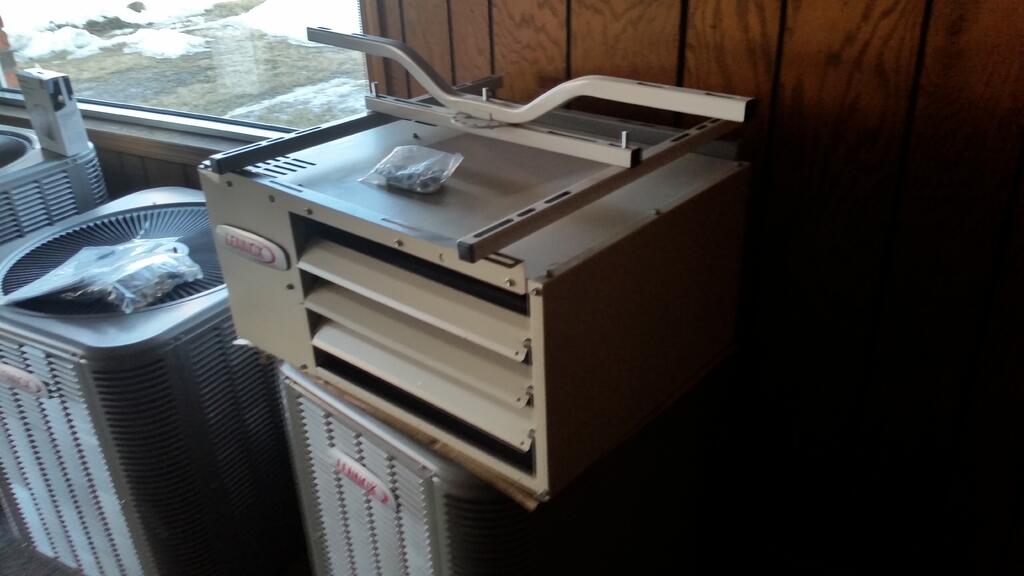

WHX?? 58,388 #19 Posted March 1, 2022 (edited) 50 minutes ago, Pullstart said: might I suggest in-floor pex piping? I got out of the habit of suggesting that Kev. In a shop I am just a unit heater kind of guy. Too much of a hassle if just want to shut the heat off and go to Florida for a week. Seen too many bozos just shut it off then it freezes. DUH Or you run out of PROPANE.... ahem.... Even with the devil's advocate called anti freeze in it still have problems. Can't set it back a whole lot or takes a long time to recover. Only nice things is you work on the floor alot or the missus puts you out there for good ya got it made. Still yah you can't do it later so many guys put the tubing down for future or they win the lotto so not the worst idea. 1/2" barrier pex 12" on centers throughout. 1200 square ft. shop a nice little 60-70K btu heater will do just fine and be my go to. Edited March 1, 2022 by WHX?? speeling 4 Share this post Link to post Share on other sites

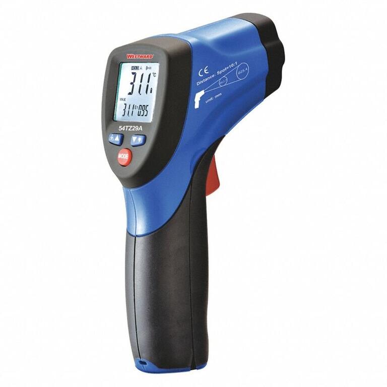

wallfish 20,744 #25 Posted March 2, 2022 (edited) 2 hours ago, WHX?? said: New skool you wanna know where them tubes are. Ha, I've had plenty of people try to mark them like that! Homeowners to professionals. Thermal imaging, thermal tester, dividing rods you name it. It's more deadly accurate finding those tubes with a core drill! Seems no matter how many lines they draw on the floor or however they try and determine their location, the core drill will find'm. I've drilled into a dozen or more tubes when they're supposedly CLEARLY marked out exactly where those tubes are so I can avoid drilling into them. LoL I stopped marking them myself a while ago so I'm not responsible anymore. Yes, I will repair them if I hit them but I'm being paid extra for that time now instead of eating it. Edited March 2, 2022 by wallfish 3 1 2 Share this post Link to post Share on other sites
