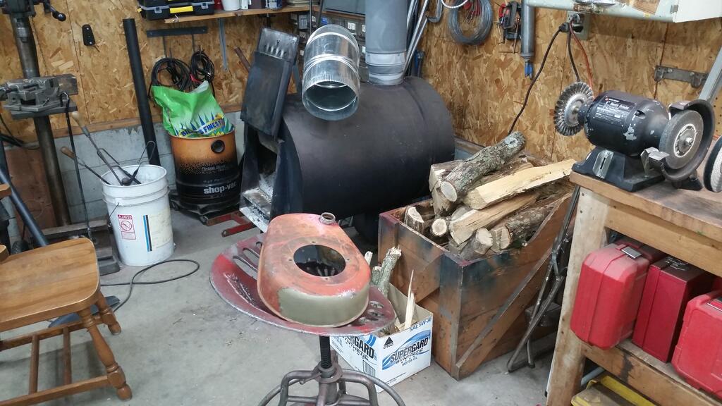

WHX?? 58,388 #80 Posted March 13, 2022 Drains all up to what code says Plunge ... you'd know better than I on that. Wood stove up to the insur.... beat me to it Jimbo.... I have a wood burner in my shop and no problems except for the insurance bending me over for an extra 50 clams a year for havin it. 78 degrees out ther right now and 17 outside. I'll pay for that. 2 1 Share this post Link to post Share on other sites

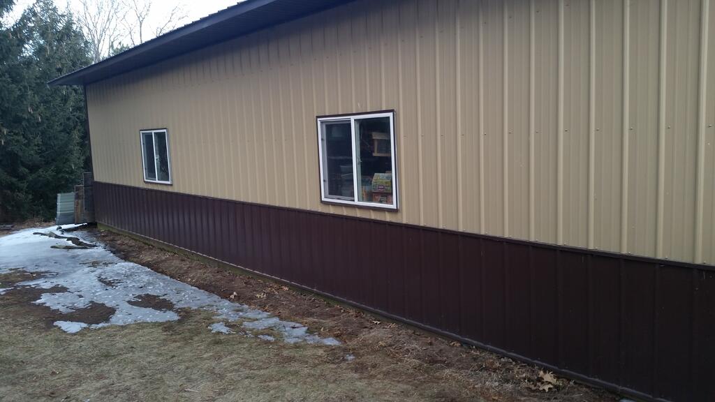

WHX?? 58,388 #98 Posted March 15, 2022 4 hours ago, ebinmaine said: So here's a question for you..... How large of an area would you clear if the building was going to be a total of 40 deep by 44 wide including the two side wings? The nearest tall tree distance... ask me how I know.... Whole back corner of the roof on my building got taken out by a tree in a wind storm. Got pics of the damage somewhere in here. Actually came out stinking like a rose on it. Insurance was very kind. They figured I would hire someone to fix it but did it myself with less than half the materials figured. 3 Share this post Link to post Share on other sites
