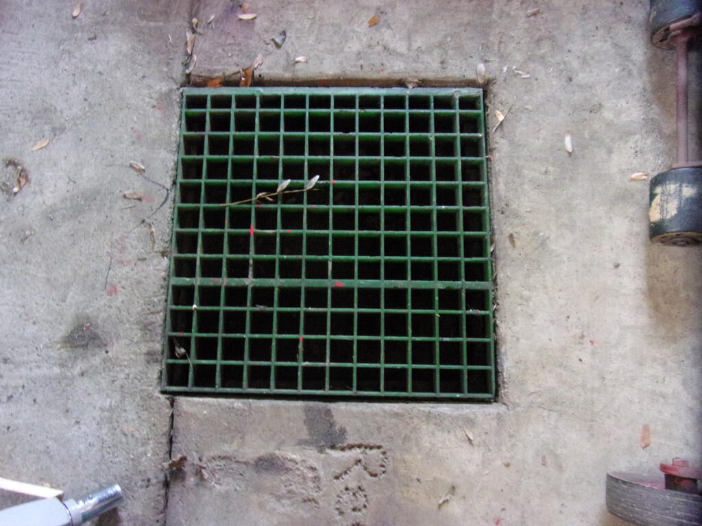

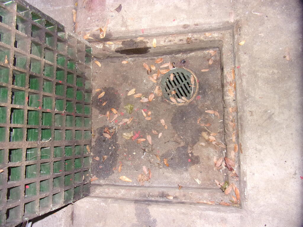

Ed Kennell 47,955 #70 Posted March 11, 2022 3 hours ago, kwalshy said: Yes, I would like a floor drain. The purpose will primarily be for washing the tractor or truck and the floor after butchering a deer. I will have a few conduits installed so I can run power, water into the barn at a later date on my own. I would go with a cleanable drain pit. A real necessity when butchering. I have my deer hoist centered over the pit so it catches everything. The pit is 18" square so I can use a shovel to clean out the big debri that will not pass thru the finer standard floor drain cover. I would also price in a roof overhang on sides and gable ends. It not only adds value to the building, but along with proper grading will help prevent any moisture problems. 3 1 Share this post Link to post Share on other sites
