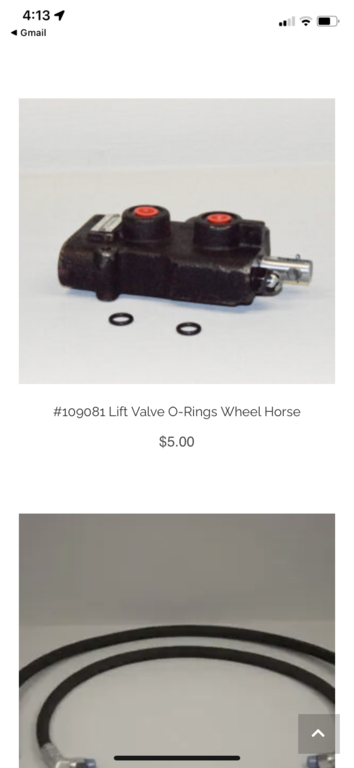

mark in ny 27 #7 Posted May 8, 2022 On 2/25/2022 at 7:48 PM, 953 nut said: Sounds like you may need to rebuild the spool valve, pressure is leaking by to the UP portion. Lowell @wheelhorseman has the kit you'll need. https://wheelhorsepartsandmore.com/product/lift-valve-rebuild-kit/ Just getting around to fixing this issue, my lift control doesn't look as the same as that one pictured. I put in a email to wheelhorseparts and more looking for which kit to buy but haven't gotten a response or got sent to spam or something. Wasn't sure if there's any difference internally than the one picture vs let's say a 520 style which is what I think I have. 1 Share this post Link to post Share on other sites
c-series don 11,941 #8 Posted May 8, 2022 Your valve body may not look like that one in the picture however you should still be able to get a rebuild kit for the one you have. Others here can point you in the right direction as far as where to get one. 1 Share this post Link to post Share on other sites
Bill D 2,870 #9 Posted May 8, 2022 (edited) I believe Wheel Horse Parts and more has a kit for that valve as well. It's just two orings. Edited May 9, 2022 by Bill D 1 Share this post Link to post Share on other sites
Horse Newbie 7,404 #10 Posted May 13, 2022 (edited) @mark in ny… Is this the valve you have ? This is the style spool valve I have on my ‘94 520 H… On the back side of the spool shaft there is a small screw and a retaining cup or washer. You can slide the spool shaft out of the body after removing the screw and cup. Check the bore and spool shaft for pitting, corrosion and smoothness. When you reassemble make sure everything is clean… really clean ! Lubricate all parts with whatever hydraulic fluid you are using in the hydro transmission. I used 10w-40 oil in mine… some say 10w-30, but I live down south so I don’t think the 10w-40 is too thick. You may want to use 10w-30 if you are in NY. I believe the Eaton 100 manual says either will work. Do you see that acorn nut on the front side of the valve ? I took it off to inspect and clean but DO NOT turn the Allen head screw beneath it ! All I now is it is some kind of adjustment screw that you don’t want to turn. Edited May 13, 2022 by Horse Newbie Share this post Link to post Share on other sites
