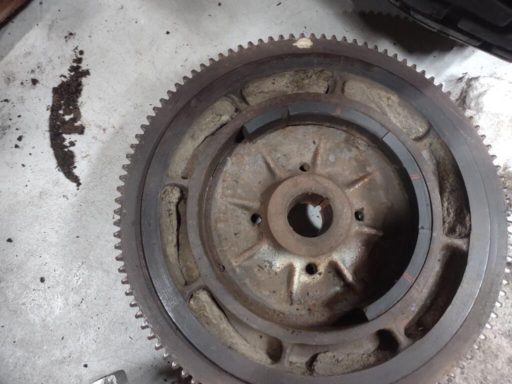

ebinmaine 81,047 #51 Posted February 28, 2022 @JCM. Jim... 7:30 pm and the loco female is still cleaning the engine.... We got the flywheel off. Alternator off. I'll post separate about that. Need some diagnostics advice. Intake off. 2 3 Share this post Link to post Share on other sites

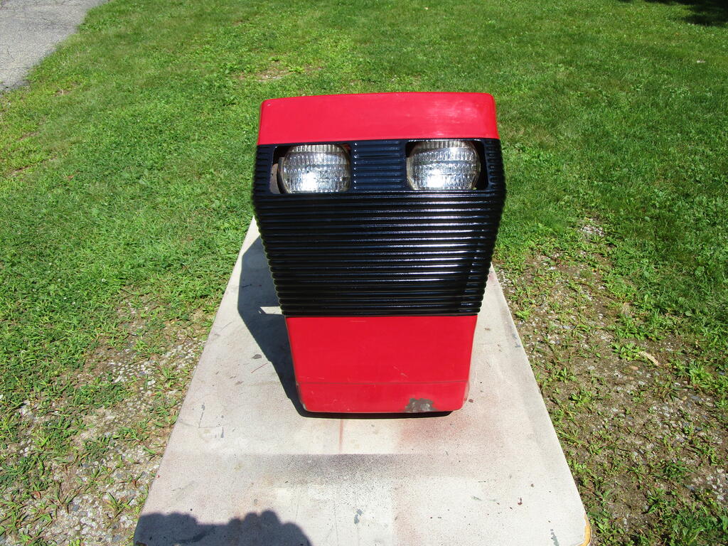

ebinmaine 81,047 #54 Posted February 28, 2022 5 minutes ago, JCM said: You two are unreal. BBT Wheelhorse Restorations. 5 minutes ago, JCM said: , Hiram , Me Hey buddy I fixed the banner for ya. We talked about popping the engine off the frame but she figured while working on cleaning it up it would be easier to leave it set. Jim what color black exactly? The Paint Department will be spraying the engine tins soon. 2 1 1 Share this post Link to post Share on other sites
JCM 11,420 #55 Posted February 28, 2022 This is what the 420 looked like when I got it, not sure of the finish. I used Rustoleum semi-gloss black on the tunnel and hood stand and looks nice. I used semi-gloss on the black mask on the 418 and I think it is a little to glossy. Maybe a satin would have been better on the front end ? When I find a pic I will post it. 1 3 Share this post Link to post Share on other sites
ebinmaine 81,047 #56 Posted February 28, 2022 8 minutes ago, JCM said: Rustoleum semi-gloss black If you can find the can or a pic of it or whatever we can pick some up to get her going painting. 2 Share this post Link to post Share on other sites
JCM 11,420 #57 Posted February 28, 2022 All semi-gloss here. Black mask a bit too much shine . 2 4 Share this post Link to post Share on other sites
JCM 11,420 #58 Posted February 28, 2022 (edited) Hood pictured from 418 in semi. Rust-oleum # 7776830 flat black for hood for the 417-A or a satin ? Not sure on that which one to use yet. Hood stand and tunnel # 7798830 semi-gloss black Edited February 28, 2022 by JCM 2 Share this post Link to post Share on other sites

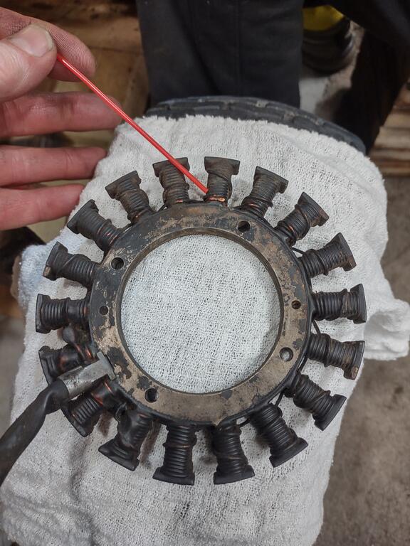

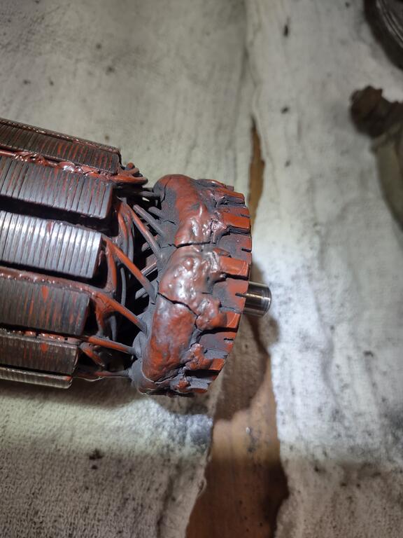

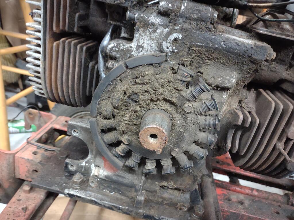

oliver2-44 11,791 #65 Posted February 28, 2022 8 hours ago, ebinmaine said: Note the cracks in the (insulation?) @ebinmaine Some years back at work we found some surface cracks in generator coils. Machine was already being reassembled and no time to order in fancy name brand stuff. Engineer recommended we gently clean the cracks with electrical cleaner and dry them throughly with indirect heat overnight. Then use some clear 3M epoxy to fill the cracks. You really don’t have to “fill” them, just seal them. Do a small area at a time facing up so gravity keeps it in the crack. If it was ok for a 138000v machine I suspect it might just be good enough for 12v. 2 1 1 Share this post Link to post Share on other sites
oliver2-44 11,791 #66 Posted February 28, 2022 (edited) On 2/27/2022 at 6:34 PM, ebinmaine said: The black “paint” is actually insulating glyptal paint. You can buy “red glyptal paint at an electrical supply but expensive for the tiny pit you need. So here another tip I learned from a motor rewind shop. Clear Polyurethane Wood finish. Good for at least 480v. Motor shops buy a higher grade (finer filtration) of this from paint manufactures for their large dip tanks. So tooth brush gently clean with electrical solvent in a spray can from auto supply. Dry overnight (don’t want to trap moisture in) Then give it a coat or 2 of poly. If all of the black insulating paint looked fragile you could give it a lite coat of poly from a spray can. Edited March 2, 2022 by oliver2-44 2 1 1 Share this post Link to post Share on other sites
ebinmaine 81,047 #67 Posted February 28, 2022 6 hours ago, kpinnc said: double adjective I believe that's referred to as a Descriptive descriptor of a description. 😂 2 Share this post Link to post Share on other sites
ebinmaine 81,047 #68 Posted February 28, 2022 @oliver2-44 Excellent. Thank you. I've been using brake clean to spray out the starters I rebuild. Is that still ok in this situation? Any thoughts on how to bench test the alternator? Seems I've seen that on Redsquare at some point. 2 Share this post Link to post Share on other sites
oliver2-44 11,791 #69 Posted March 1, 2022 Yes, brakeclean should be OK. But I would test a small spot on each starter to insure it doesn’t soften the insulation. You can test a starter armature with a tester called a “Growler” In my younger days seems like every auto supply had one. Now it’s been years since I’ve seen one 3 Share this post Link to post Share on other sites

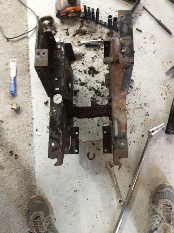

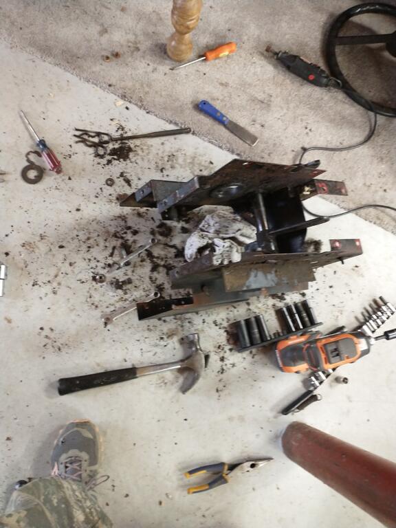

ebinmaine 81,047 #73 Posted March 1, 2022 My Lead Machinery Dismantler got a little more done today. I got a text from her a little while ago that said, If I was a Dremel looking tool where would I live? I'm not at the house today so I was a little afraid to ask why someone would want to know such information. Turns out she was grinding off broken cotter pins in the console/transmission tunnel where there isn't much space. I hate to admit it but I've never even considered doing that. 😀 She got that emptied out of all the linkage. Another text, A rather large c-clamp was launched into Oblivion. 😂 If any of you find folks would care to guess where Oblivion is perhaps we could look there... 5 Share this post Link to post Share on other sites
