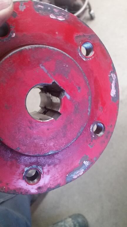

seven 202 #1 Posted February 20, 2022 I have very worn out keyways both sides any ideas as of how to repair? 1 1 Share this post Link to post Share on other sites
Maxwell-8 4,371 #2 Posted February 20, 2022 3 minutes ago, seven said: I have very worn out keyways both sides any ideas as of how to repair? The hubs or the axles? or both? 1 Share this post Link to post Share on other sites
seven 202 #3 Posted February 20, 2022 (edited) Both Edited February 20, 2022 by seven 1 1 Share this post Link to post Share on other sites

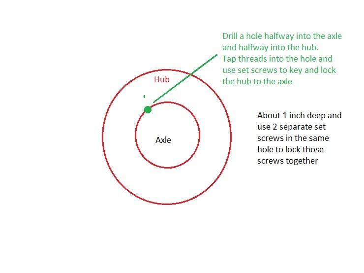

wallfish 19,754 #9 Posted February 20, 2022 Backyard hammer mechanic quick fix suggestion. No expensive machining or replacement parts. The axles and hubs are already damaged anyway so... Still leaves a way to remove them for any future service if necessary. Do 2 holes 180 deg apart if you're so inclined but I wouldn't do any new holes near the existing key location. 5 7 Share this post Link to post Share on other sites

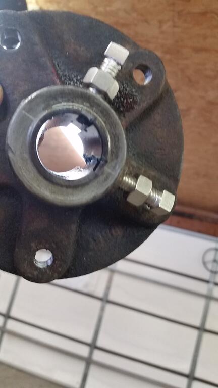

Pullstart 69,771 #11 Posted February 20, 2022 I like @wallfish’s idea. I recently did this to a front steering arm/spindle assembly. It tightened things so well. 4 1 Share this post Link to post Share on other sites

WHX?? 56,154 #14 Posted February 21, 2022 I was trying to figure out what 'Fish was suggesting but after looking what you did Kev now I get it. Hey I'm a little slow at times.... Actually a good idea John for a farmer fix. Use a grade 8 bolt? 1 Share this post Link to post Share on other sites
Pullstart 69,771 #15 Posted February 21, 2022 This is assuming the axle is as walleyed out as the hub and you have nothing to lose… Share this post Link to post Share on other sites

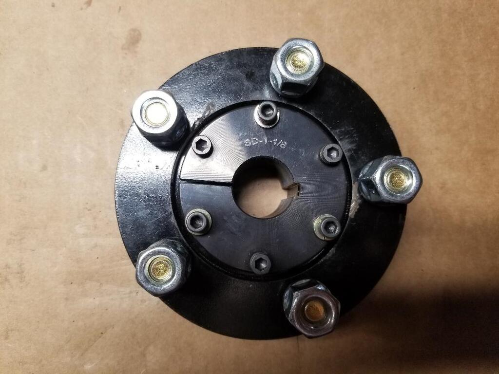

Wild Bill 633 931 #17 Posted February 21, 2022 I recommend the hubs from A-Z Tractor with the QD bushing which is like a collet that grips the shaft. They will take 5000 lb-ins / 417 lb-ft of torque without the key. 1" diameter https://www.ebay.com/itm/265311350944?hash=item3dc5c9f0a0:g:OpwAAOSwlIxfmse0 1-18" diameter https://www.ebay.com/itm/265311349273?hash=item3dc5c9ea19:g:OpwAAOSwlIxfmse0 1 1 Share this post Link to post Share on other sites
wallfish 19,754 #18 Posted February 21, 2022 10 hours ago, WHX?? said: Actually a good idea John for a farmer fix. Use a grade 8 bolt? Set screws can go in beyond the edge of the hole so nothing protruding out. Those hardened set screws won't shear. But bolts work too 1 Share this post Link to post Share on other sites

Wild Bill 633 931 #25 Posted March 3, 2022 On 2/21/2022 at 4:46 PM, Bill633 said: I recommend the hubs from A-Z Tractor with the QD bushing which is like a collet that grips the shaft. See attached picture. I prefer to install grade 8 bolts from the back side with Loctite red and lug nuts as shown 1 Share this post Link to post Share on other sites
