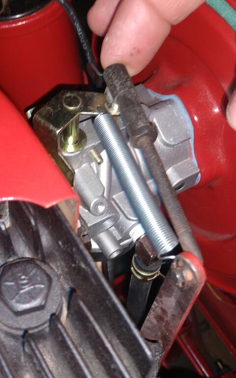

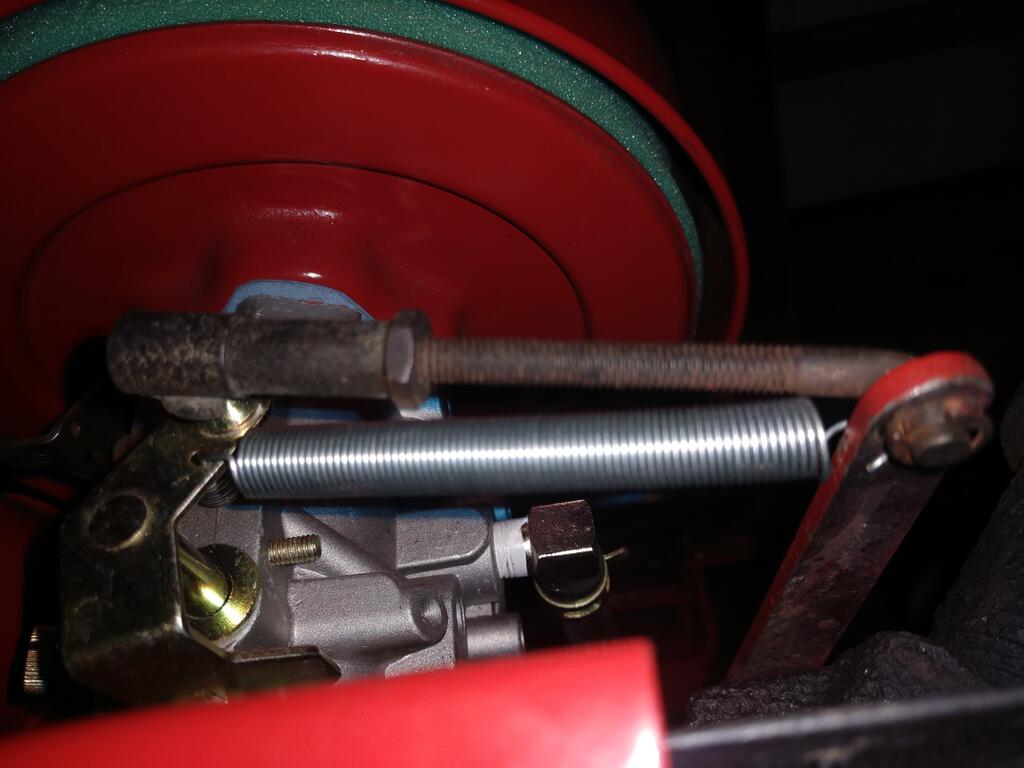

kpinnc 19,060 #3 Posted February 13, 2022 Almost sounds like your govenor is out of adjustment- or you've got a little slop in the throttle link. Magnum engines have tiny holes drilled in the top of the governor arm and the tab on the throttle shaft at the carb for adding a small spring just for that purpose. I will never understand why they made the holes but didn't use a spring from the factory. Anyway, most hardware stores sell light springs that you can use. It won't affect anything except it eliminates the slop between governor action and carb reaction. Might be worth a try. 3 1 Share this post Link to post Share on other sites

peter lena 10,107 #7 Posted February 14, 2022 @Jsieao referring to @kpinnc spring picture , use delicate top spring , pete 1 Share this post Link to post Share on other sites
kpinnc 19,060 #8 Posted February 14, 2022 2 minutes ago, peter lena said: referring to @kpinnc spring picture , use delicate top spring , pete For clarification- I mean you should place the spring between the governor arm and the tab on the carb. I do not suggest attaching it anywhere else. To do so will affect the throttle response. My spring placement merely eliminates play between the governor and throttle shaft, which equates to a more precise governor response. It in no way changes anything otherwise. 2 Share this post Link to post Share on other sites
peter lena 10,107 #9 Posted February 14, 2022 @kpinnc referring to your carb spring picture , used a very delicate spring in that , was just enough , another thing, your straight vertical fuel line from the fuel pump to carb is a perfect spot for a 5/16" check valve , evil energy has them , when installed there it looks like it was made for it , vertical fit , consistently gives quick starts , have it on my 3 magnums , pete 1 Share this post Link to post Share on other sites
kpinnc 19,060 #10 Posted February 14, 2022 Just now, peter lena said: another thing, your straight vertical fuel line from the fuel pump to carb is a perfect spot for a 5/16" check valve , evil energy has them , when installed there it looks like it was made for it , vertical fit , consistently gives quick starts , have it on my 3 magnums , pete Thanks Pete. I will have to check one of those out. 1 Share this post Link to post Share on other sites
