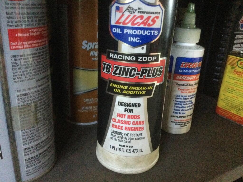

Snoopy11 5,731 #32 Posted February 14, 2022 20 minutes ago, briankd said: i don't know if zinc would have helped this or not Yeah... ZDDP is mostly for cam lobes/follower protection... Don Share this post Link to post Share on other sites

richmondred01 2,393 #34 Posted February 16, 2022 On 2/13/2022 at 3:48 PM, Jeff-C175 said: ALL oils have cut back the Zinc content! Not just NAPA. Has to do with the API specifications. WALMART has the best price on Rotella T1 straight 30W, about $17 a gallon last purchased. If you add ZDDP to the T1, ONE OZ per quart is all you need.to get to about 1200-1400 ppm of Zinc. More is NOT better! 1 Share this post Link to post Share on other sites
Snoopy11 5,731 #35 Posted February 16, 2022 (edited) PRECISELY what I use @richmondred01 I use that in the Ranger, and all my machines. @peter lena... that is the stuff I told you about... Don Edited February 16, 2022 by Snoopy11 Share this post Link to post Share on other sites
Bill D 3,193 #36 Posted February 17, 2022 I called Shell's tech support line. Rotella T1 30w has 1,240 ppm zinc according to the rep. Share this post Link to post Share on other sites

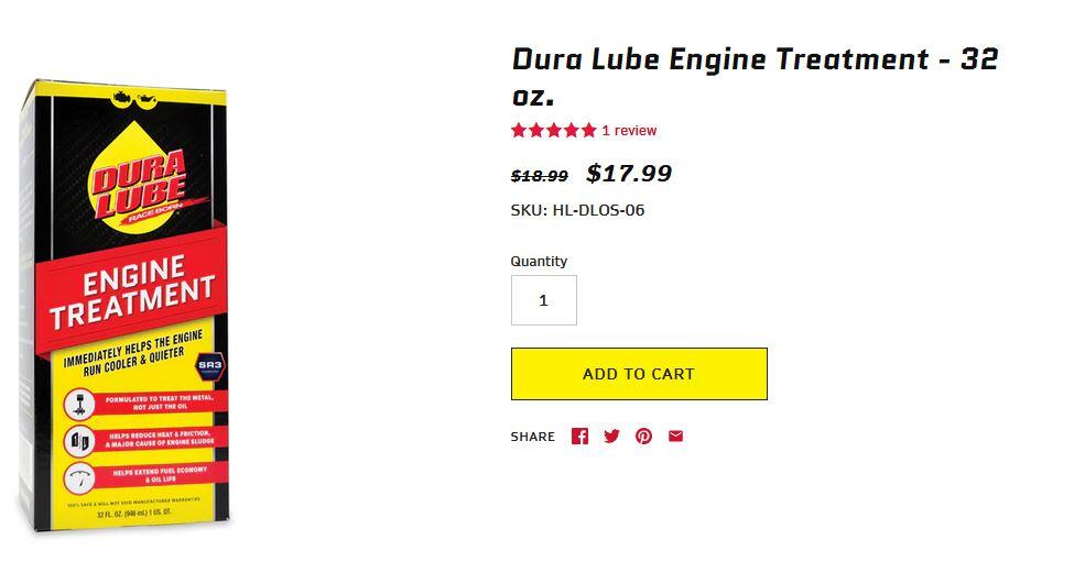

hgpsmerk 8 #40 Posted February 21, 2022 I just recently switched to Royal Purple synthetic 30 WT oil. I use 1 1/2 qts of that with 1/2 a qt of duralube to make 2 QTS. K321 has over 3200 hours on it. No smoke and runs smooth. 1 Share this post Link to post Share on other sites
Jeff-C175 7,211 #41 Posted February 21, 2022 37 minutes ago, hgpsmerk said: duralube Duralube what? Share this post Link to post Share on other sites
pfrederi 21,301 #42 Posted February 21, 2022 (edited) 21 minutes ago, Jeff-C175 said: Duralube what? Probably #1. Some of these have been around forever. They all claim to do great things and have lots of testimonials and some "scientific" testing. If it makes you feel better to use this stuff I doubt it will hurt your engine...just your wallet.\ Edited February 21, 2022 by pfrederi Share this post Link to post Share on other sites
hgpsmerk 8 #43 Posted February 21, 2022 Duralube engine treatment is the one. 1 Share this post Link to post Share on other sites
lynnmor 9,073 #44 Posted February 21, 2022 Sniff Sniff Did someone spill snake oil in here? 1 Share this post Link to post Share on other sites
hgpsmerk 8 #45 Posted February 21, 2022 Nope. Just constant use with 30 WT oil with a 1/2 qt of duralube engine treatment at every oil change. No Bull. 1 Share this post Link to post Share on other sites
