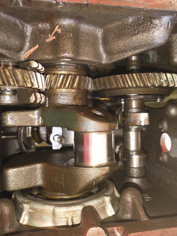

squonk 48,322 #5 Posted February 13, 2022 This is the inside of a Kohler K341 with 996 hours. I did not clean a thing before this picture was taken. You can see it's almost spotless inside. It was running fine but had a loose balance gear and a broken piston skirt. I have had this for 10 years and 8 of them have been on Rotella 30W and a pinch of zinc additive. The engine has been bored and rebuilt. Camshaft and lifters were fine. I don't think zinc is all that to be worried about. 7 2 Share this post Link to post Share on other sites

RED-Z06 2,720 #12 Posted February 13, 2022 2 hours ago, squonk said: This is the inside of a Kohler K341 with 996 hours. I did not clean a thing before this picture was taken. You can see it's almost spotless inside. It was running fine but had a loose balance gear and a broken piston skirt. I have had this for 10 years and 8 of them have been on Rotella 30W and a pinch of zinc additive. The engine has been bored and rebuilt. Camshaft and lifters were fine. I don't think zinc is all that to be worried about. Wonder what caused the skirt to break? 996 hours is still pretty early to need parts in it. Share this post Link to post Share on other sites

squonk 48,322 #15 Posted February 13, 2022 32 minutes ago, RED-Z06 said: Wonder what caused the skirt to break? 996 hours is still pretty early to need parts in it. I bought it with 750 ish hours. Had little maintenance before I got it.. Hard to say how long I was running it with the broken piston. Share this post Link to post Share on other sites

Snoopy11 5,731 #21 Posted February 13, 2022 4 hours ago, squonk said: This is the inside of a Kohler K341 with 996 hours. I did not clean a thing before this picture was taken. You can see it's almost spotless inside. It was running fine but had a loose balance gear and a broken piston skirt. I have had this for 10 years and 8 of them have been on Rotella 30W and a pinch of zinc additive. The engine has been bored and rebuilt. Camshaft and lifters were fine. I don't think zinc is all that to be worried about. I really have to agree with Mike here pretty strongly. The only time you really need a high ZDDP content is in racing applications. I wouldn't worry about it in a stock engine. Don Share this post Link to post Share on other sites
