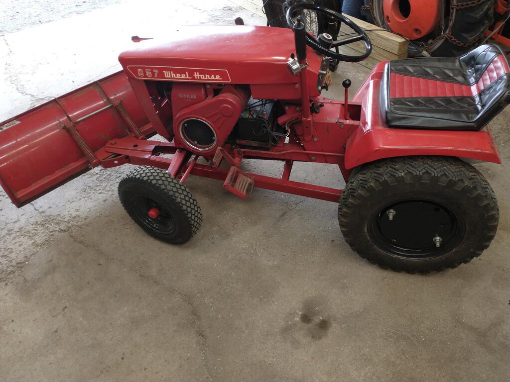

squonk 48,076 #8 Posted February 12, 2022 I have 6-12's on my 857. Good old General Garden Tractor S.S's. 40 lbs of weight on each wheel. I've been plowing snow with no chains. 5 Share this post Link to post Share on other sites

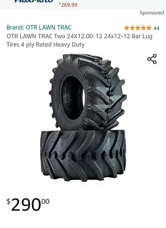

TJ5208 1,841 #9 Posted February 13, 2022 Either one of these is what I'm probably going to do. The 24s look aggressiverer than the 23s. 1 Share this post Link to post Share on other sites
TJ5208 1,841 #10 Posted February 13, 2022 (edited) What do you guys think I should do? Which one? Edited February 13, 2022 by TJ Salyers 1 Share this post Link to post Share on other sites
Sparky-(Admin) 26,322 #11 Posted February 13, 2022 21 minutes ago, TJ Salyers said: What do you guys think I should do? Which one? Your 520 doesn’t have wide enough rims that will work for the 24-12-12’s. 2 1 Share this post Link to post Share on other sites
TJ5208 1,841 #12 Posted February 13, 2022 2 minutes ago, Sparky said: Your 520 doesn’t have rims that will work for the 24-12-12’s. Okay 23-10s it is. 1 Share this post Link to post Share on other sites

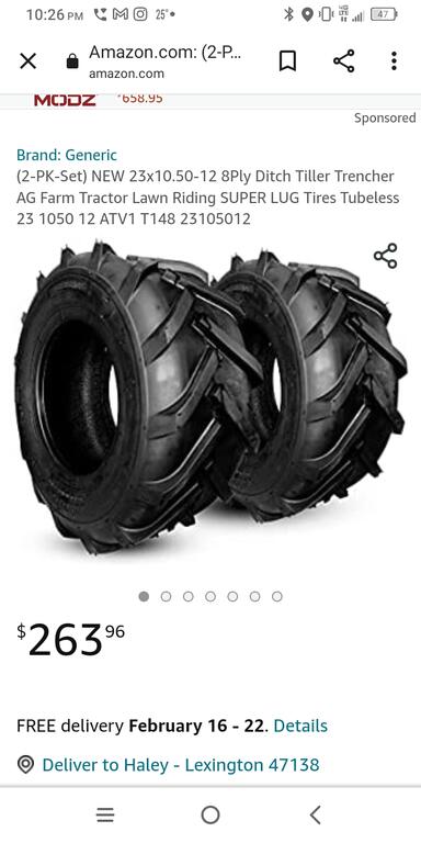

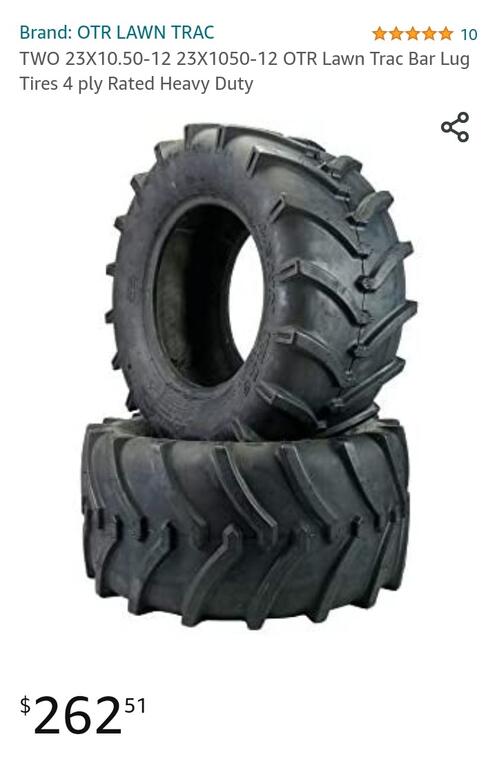

TJ5208 1,841 #13 Posted February 13, 2022 (edited) Heres several brands im looking at. I'm liking the otrs. Edited February 13, 2022 by TJ Salyers 1 Share this post Link to post Share on other sites
Sparky-(Admin) 26,322 #14 Posted February 13, 2022 Between the two I would choose the 4 ply tires over the 8 ply. In my opinion the 8 ply is to stiff and non-flexible for our type of machines. 1 2 Share this post Link to post Share on other sites

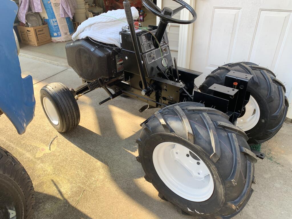

kpinnc 18,940 #16 Posted February 13, 2022 This probably belongs to a member here, but I don't know. 23x10.50-12 OTR ags on a 520: 2 1 Share this post Link to post Share on other sites

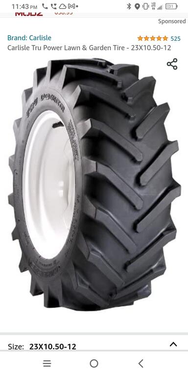

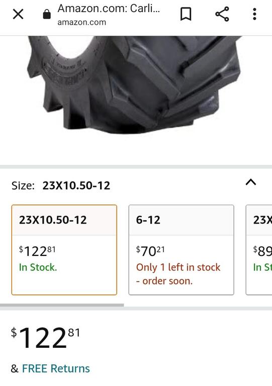

TJ5208 1,841 #17 Posted February 13, 2022 (edited) I looked at Carlisle they look like a good tire but the Otrs look good also. But I think I might try Otr or Carlise. Which ones do you guys recommend? Edited February 13, 2022 by TJ Salyers 1 Share this post Link to post Share on other sites

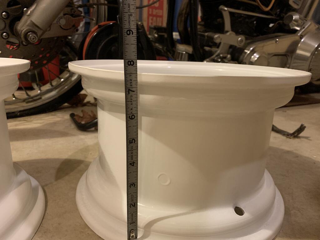

Horse Newbie 7,405 #24 Posted February 13, 2022 @kpinnc… what are these ? They are from the ‘84 Work Horse GT-1600… 1 Share this post Link to post Share on other sites
Sparky-(Admin) 26,322 #25 Posted February 13, 2022 38 minutes ago, Horse Newbie said: @kpinnc… what are these ? They are from the ‘84 Work Horse GT-1600… 7.5” 2 Share this post Link to post Share on other sites
