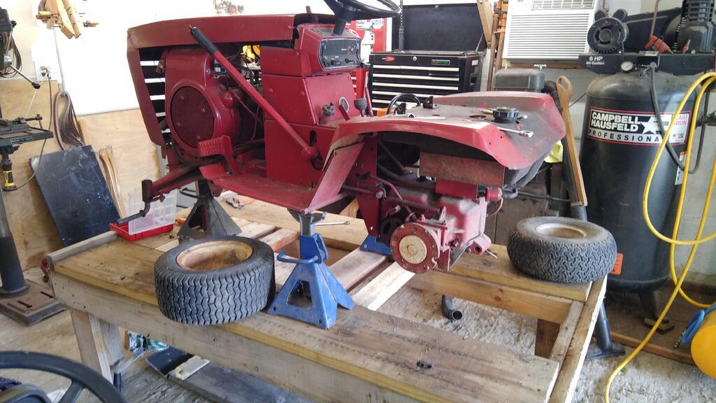

RandyLittrell 3,943 #58 Posted December 11, 2022 I guess I missed this thread. Eric, I built a work platform out of scrap wood from plate glass crates and only have a few bucks in it. I made a gap in the middle so you can crawl under to work on things under the tractor while sitting up. I made a lip under there so I can use boards in the middle for jacks and such, but slide them out of the way. I use a boat winch on the front to winch them up on bench and have had my loader tractor on it with no problem. Very sturdy. You could put casters all around to move it with a smooth floor or wheels under just one end and pull it with a tractor from building to building. 4 1 Share this post Link to post Share on other sites
ebinmaine 77,014 #59 Posted December 11, 2022 9 hours ago, RandyLittrell said: I guess I missed this thread I'll let that slide just this once but I'm gonna need you to pay better attention. I'm kidding. I'm kidding. I'm kidding. No worries... I gotta tell ya what there mister man. That platform is slick. Like the scrap wood idea. I worked for a glass factory. Them crates is some rugged. Also like the mobility thought especially considering we're trying to make most of our work pieces movable. 1 Share this post Link to post Share on other sites
RandyLittrell 3,943 #60 Posted December 11, 2022 3 hours ago, ebinmaine said: I gotta tell ya what there mister man. That platform is slick. Like the scrap wood idea Thank ya sir!!! I have lowered it since I first built it, and that pic is the lowered height. I think it's about 16" now or so. I want to build a new one in the future from steel tubing and make it so I can lift or raise the whole thing or just lower one end for getting tractors on and off. But it works great just like it is! Randy 1 Share this post Link to post Share on other sites
