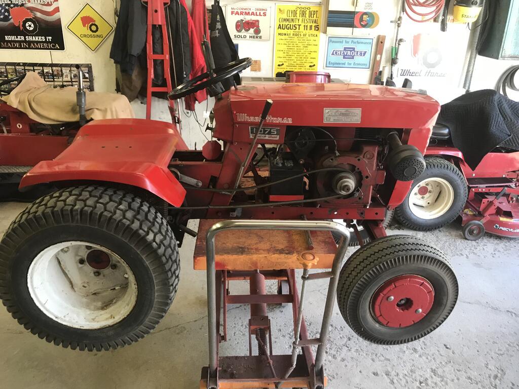

squonk 47,785 #6 Posted February 11, 2022 (edited) I had one of those Horror Fright Motorcycle tables. Put an oak door on it to make it wide enough for a tractor. It barely picked up my 1467 once. That was it. Nothing helped getting the jack to work right. Plus pumping it with the pedal seem tedious. ended up selling it. I'd cut loose with the cash and get an ATV table lift. OR a HF lift table will lift will most Wh's. Plus you can roll it out of the way. Not sure of a C160 though. Edited February 11, 2022 by squonk 2 Share this post Link to post Share on other sites

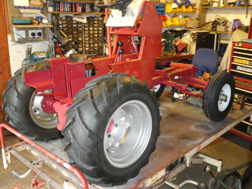

stevasaurus 23,784 #7 Posted February 11, 2022 What I use is stuff I already have. I have my little flatbed trailer and some very sturdy ramps for it. I can drive or push a horse up the ramps and onto the trailer. Probably about 16". I then take blocks and place the ramps from the ground end on them. Now I can push the horse back onto the ramps and work on the horse. My ramps hook onto the back of the trailer, so there is no movement there. I suppose I could do the same thing and then put both ends of the ramps on blocks and push the horse on from there. No hydraulics, no lifting, set up where you want, leave until you need the ramps. If there is a draw back, the horse is sitting on it's tires, but you could jack up one end enough to work on wheels, hubs, seals or what ever. 3 Share this post Link to post Share on other sites

SylvanLakeWH 32,009 #9 Posted February 11, 2022 53 minutes ago, stevasaurus said: What I use is stuff I already have. I have my little flatbed trailer and some very sturdy ramps for it. I can drive or push a horse up the ramps and onto the trailer. Probably about 16". I then take blocks and place the ramps from the ground end on them. Now I can push the horse back onto the ramps and work on the horse. My ramps hook onto the back of the trailer, so there is no movement there. I suppose I could do the same thing and then put both ends of the ramps on blocks and push the horse on from there. No hydraulics, no lifting, set up where you want, leave until you need the ramps. If there is a draw back, the horse is sitting on it's tires, but you could jack up one end enough to work on wheels, hubs, seals or what ever. I’m not visualizing your set up but it sounds good… do you have a pic or two so I can understand the set up? 1 Share this post Link to post Share on other sites

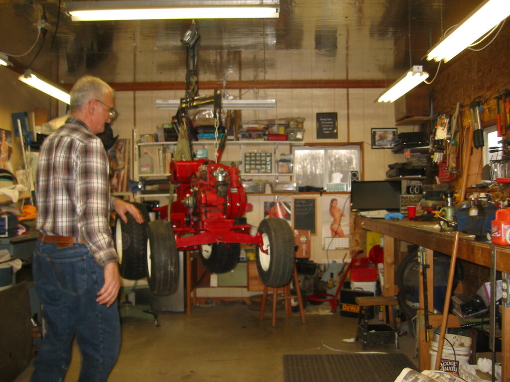

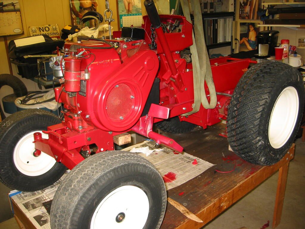

pfrederi 21,003 #10 Posted February 11, 2022 I have a lift table like Squonk but you have to take the belt guard off to use it. Tachmatics cause issues also. Build a table and pick her up slide table under it...... 4 3 Share this post Link to post Share on other sites

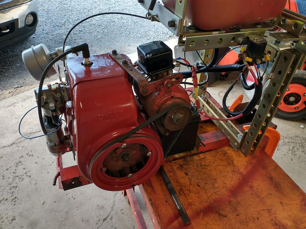

Achto 32,266 #12 Posted February 11, 2022 (edited) I use a motor cycle lift to work on my tractors. I made the extension block that you see on top for 2 reasons. 1 - 3" of extra height. 2 - It's only 1/4" wider than the frame on each side. This allows you to assemble the whole tractor while it is on the lift, even the belt guard. The tabs on top fit inside of the frame and keep the tractor from from sliding off side to side. The tabs on the bottom keep the extension from sliding off of the lift. Comfortable height to sit on a shop stool & work on the tractor. Don't take up much room either. Edited February 11, 2022 by Achto 8 5 Share this post Link to post Share on other sites

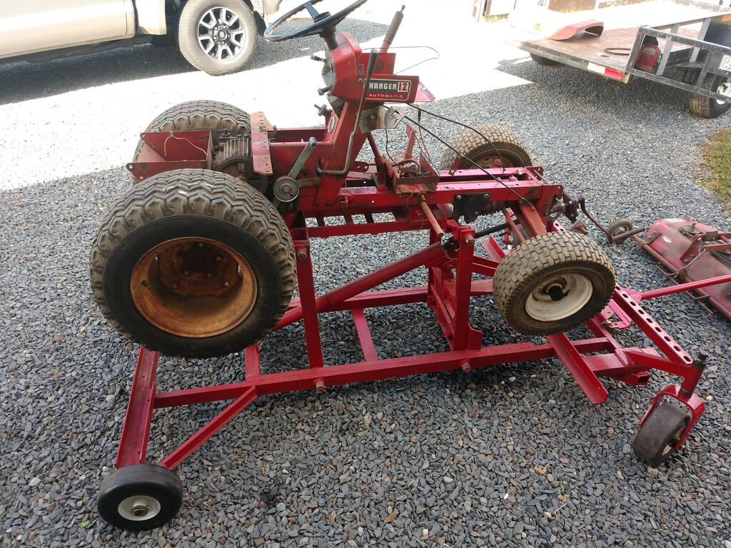

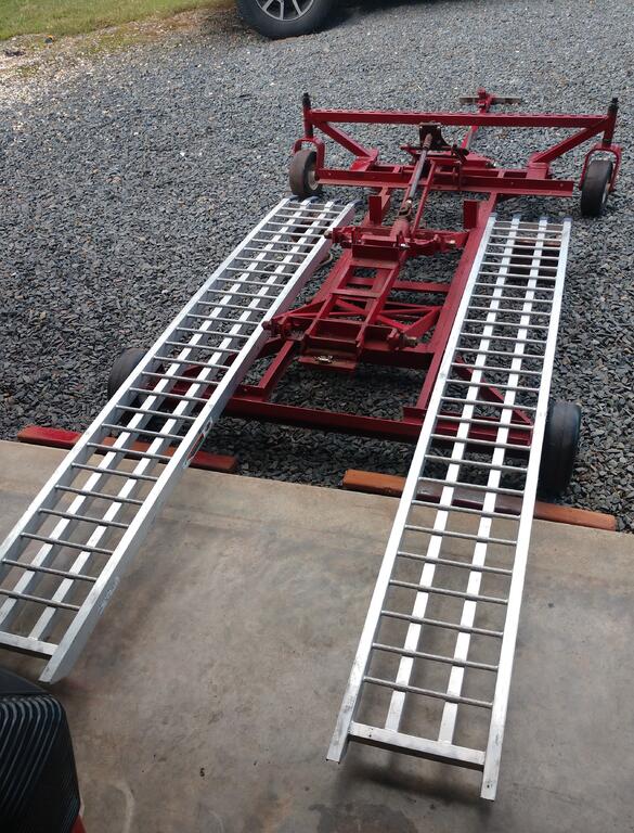

kpinnc 18,859 #14 Posted February 12, 2022 Whatever you use, either anchor it to the floor or make the base as wide as possible. The center of gravity moves quite a bit when you remove stuff. One loaded wheel can flip the tractor over if the base isn't sturdy. Or make one like mine... 5 2 Share this post Link to post Share on other sites
Horse Newbie 7,405 #15 Posted February 12, 2022 3 hours ago, pfrederi said: I have a lift table like Squonk but you have to take the belt guard off to use it. Tachmatics cause issues also. Build a table and pick her up slide table under it...... First pic… I thought that Horse was levitating… 4 Share this post Link to post Share on other sites
Horse Newbie 7,405 #16 Posted February 12, 2022 15 minutes ago, kpinnc said: Or make one like mine... Show - off ! 1 Share this post Link to post Share on other sites
Horse Newbie 7,405 #17 Posted February 12, 2022 16 minutes ago, kpinnc said: Whatever you use, either anchor it to the floor or make the base as wide as possible. The center of gravity moves quite a bit when you remove stuff. One loaded wheel can flip the tractor over if the base isn't sturdy. Or make one like mine... Now I know where to borrow one for my next refresh ! 1 1 Share this post Link to post Share on other sites
kpinnc 18,859 #18 Posted February 12, 2022 6 minutes ago, Horse Newbie said: Show - off ! I know, I know... But Eb did ask! I'd love to have a hoist like pfrederi! 2 Share this post Link to post Share on other sites
Horse Newbie 7,405 #19 Posted February 12, 2022 5 minutes ago, kpinnc said: know, I know... But Eb did ask! That is true… the walls have eyes… and ears… Share this post Link to post Share on other sites

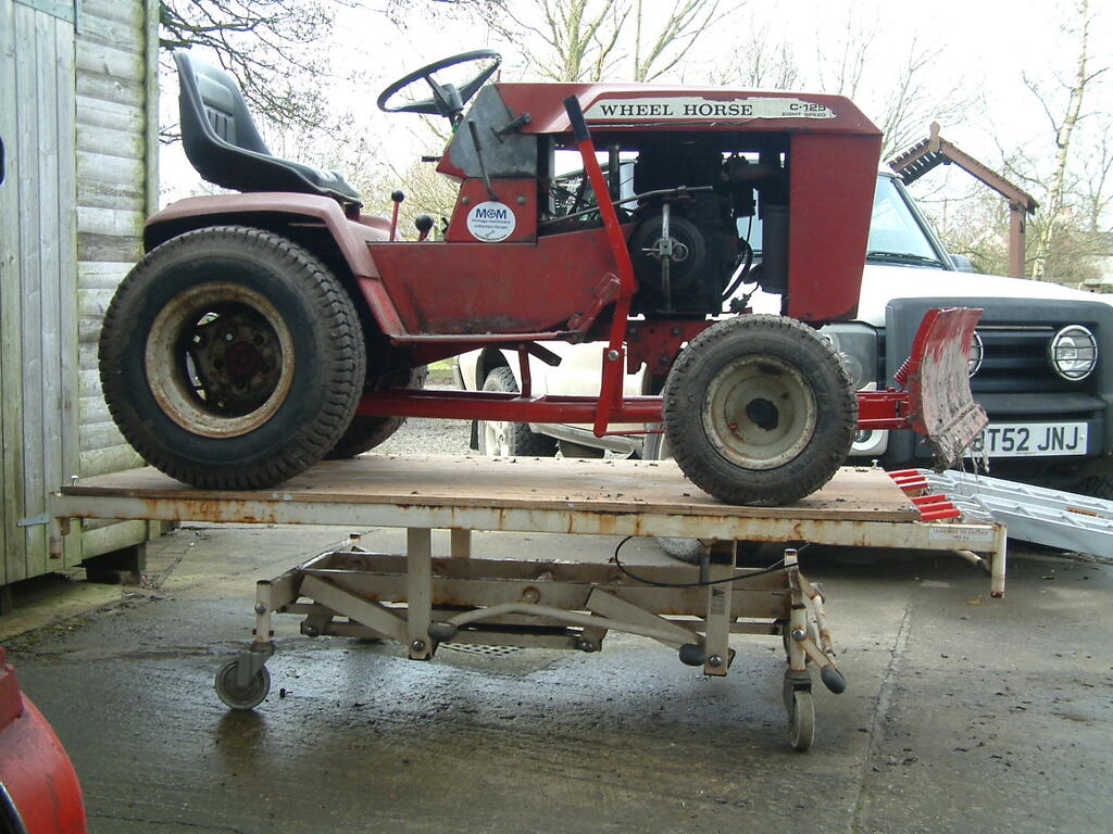

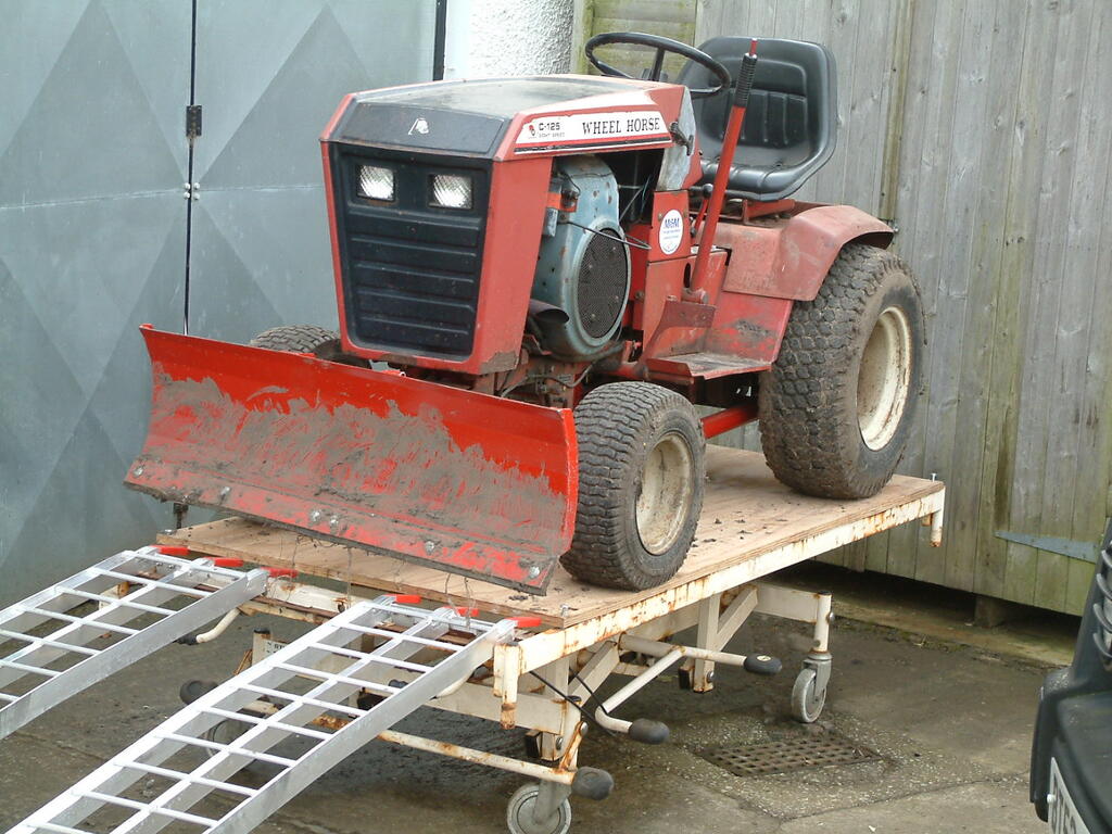

Stormin 9,988 #21 Posted February 12, 2022 (edited) 11 hours ago, elcamino/wheelhorse said: Get a used hospital bed like @Stormin has , I am sure he will provide photos. Hospital bed tractor lift. Handiest thing I've got for free. A tractor will just fit on nicely. A hand winch is fitted to one end to pull tractors up. A removable handle at the other to move it around. It also comes in handy as a mobile work bench. P.S. Some support at the ramp end is an idea. Tends to lift the winch end at first. I find height wise it's ok when down. It can be raised by the foot pump. OH! And remember to put the brakes on. Edited February 12, 2022 by Stormin 2 6 Share this post Link to post Share on other sites

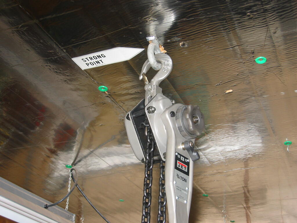

ebinmaine 80,099 #22 Posted February 12, 2022 10 hours ago, Horse Newbie said: First pic… I thought that Horse was levitating… It is. @pfrederi Paul's a wizard... Lots of excellent ideas here as always folks. Thank you for posting. We both like the tables quite a lot. Space, or lack of, could be a deciding factor there. The ceiling mounted chain falls really got her attention. That may just work out well because I have a chain falls and 10 foot channel I've been considering moving to the basement specifically to lift/adjust/install the engine on Colossus. 7 hours ago, Pullstart said: Why not have HER lift the tractor? She’s Black Belt Trina for cryin’ out loud! I'll tell her this is the final solution and keep you posted for feedback. 3 Share this post Link to post Share on other sites

Stormin 9,988 #24 Posted February 12, 2022 6 hours ago, squonk said: Electric lift hospital beds would be cooler! Beggars can't be choosers. It was at an engineering shop not far from me and destined for the skip. 1 Share this post Link to post Share on other sites
ebinmaine 80,099 #25 Posted February 14, 2022 (edited) As a partial solution and part of my thought process I hung my chain falls in the basement workshop temporarily. I wanted to have both of us be able to get an idea of where it would sit. The hoist itself would be out of the way for the most part because it'll live right where it is sitting now, up against the pegboard wall. For the chain falls bracket fastening, I think I've come up with a good solution. A 2x6 board above the 10' long rail will be 12' long so I can grab an extra joist. Three 4" long (#10 deck screws or 1/4" lags) in every joist. Then, to hang the rail I'll use five total brackets with bolts that go through the 2x6. The deck screws should have a real-world pull out of somewhere above 600 lb each. That should give me a pretty fair safety margin for lifting several hundred pounds. Thoughts comments suggestions questions as always are welcome.... Edited February 14, 2022 by ebinmaine 1 Share this post Link to post Share on other sites
