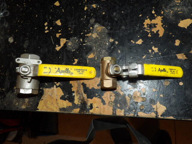

WHNJ701 4,173 #1 Posted February 11, 2022 We have been in this house for 3 years. The plumbing water pipe layout is as simple as you can get and 95% is new mostly pex. On the hot water side I keep getting pin holes in the shut offs. The hot shower one I see has a slight drip and was replaced a year ago. I do have a acid neutralizer tank with the marble sand, which was serviced a year ago. The hot water heater is electric almost 20 years old and is set to 130 degrees. Are these new pex shut offs cheap junk? If it was an acid issue wouldn't I have issues with cold side too?. Share this post Link to post Share on other sites
Jeff-C175 7,211 #2 Posted February 11, 2022 (edited) 27 minutes ago, jabelman said: pin holes in the shut offs Can you elaborate a bit? What do you mean by 'shutoff'? Pics? Edited February 11, 2022 by Jeff-C175 Share this post Link to post Share on other sites

WHNJ701 4,173 #4 Posted February 11, 2022 23 minutes ago, Jeff-C175 said: Can you elaborate a bit? What do you mean by 'shutoff'? Pics? You can see the little corrosion spot. It's about a year old. Share this post Link to post Share on other sites

Jeff-C175 7,211 #6 Posted February 11, 2022 (edited) 54 minutes ago, jabelman said: corrosion spot That is very bizarre. I would suspect a porous casting to begin with. What's the brand on those valves? "Wolverine Brass" ? I might write to the manufacturer. Edited February 11, 2022 by Jeff-C175 1 Share this post Link to post Share on other sites

Jeff-C175 7,211 #8 Posted February 11, 2022 3 minutes ago, Snoopy11 said: good ones... Wolverine Brass is an old American company and generally well regarded. Maybe they've moved production off-shore now... I can't think of any water quality issues that could eat through solid brass in a year! 1 Share this post Link to post Share on other sites

formariz 12,381 #12 Posted February 11, 2022 https://www.erplumbing.com/blog/problems-with-pex-pipes-with-brass-fittings/ Share this post Link to post Share on other sites
EB-80/8inPA 2,124 #13 Posted February 11, 2022 24 minutes ago, formariz said: https://www.erplumbing.com/blog/problems-with-pex-pipes-with-brass-fittings/ Egads, dezincification! Share this post Link to post Share on other sites
WHNJ701 4,173 #14 Posted February 11, 2022 I checked the shark bite website and they use dezincification free brass. Share this post Link to post Share on other sites
Ed Kennell 47,696 #15 Posted February 11, 2022 Just now, jabelman said: shark bite website and they use dezincification free brass. I keep shark bites in stock for quick repairs to all the pin holes in my copper and brass fittings. My well water tastes good, but it has an appetite for brass and copper. Share this post Link to post Share on other sites
