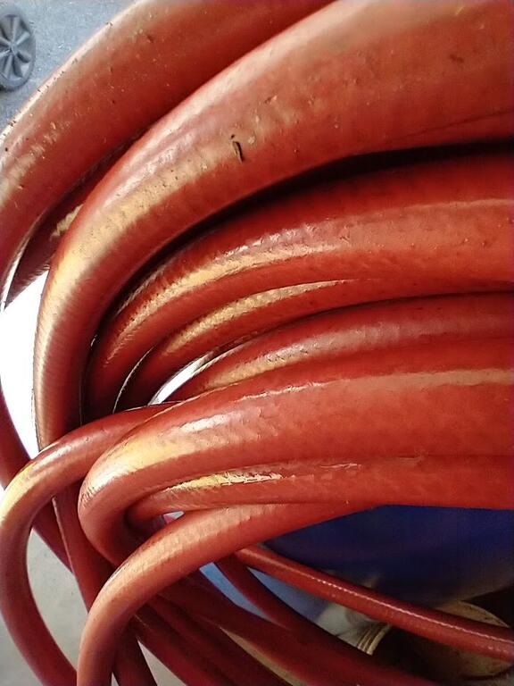

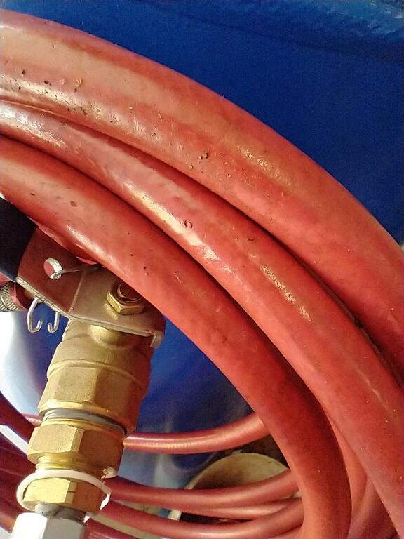

rmaynard 17,585 #1 Posted February 9, 2022 I have a 60 gallon air compressor in my shop. In the spring of 2021 I noticed that the air hose was covered with sticky oil. So I cleaned it off with mineral spirits, and it was good for the whole summer and fall. Now, today I go to the garage to air up some tires, and notice that the entire length of the hose is again covered with oil. I have no idea where it is coming from. My air shut-off valve has been closed. I always close it every time I finish using it. The oil level in the compressor has never dropped. Water was drained before winter. Thus the Maynard Mystery Oil. Anyone else have this problem or know what is causing it? 5 Share this post Link to post Share on other sites

squonk 48,154 #7 Posted February 9, 2022 A lot of high quality air hoses have an oily feel to them. I think it's a chemical to keep the hoses from dry rotting and offer UV protection. Share this post Link to post Share on other sites
ranger 1,862 #8 Posted February 9, 2022 If it’s oil, that will always be present in the air from the compressor, (unless it’s an oil free pump), there shouldn’t be a significant amount if rings etc are ok. And if it's permeating through the hose walls, or if it’s oil or whatever used in the manufacturing process of the hose, I would consider the structural integrity of the hose to be compromised, and would seriously think about replacement. Burst airlines are capable of inflicting serious injuries to eyes etc! 1 Share this post Link to post Share on other sites
rmaynard 17,585 #9 Posted February 9, 2022 25 minutes ago, squonk said: A lot of high quality air hoses have an oily feel to them. I think it's a chemical to keep the hoses from dry rotting and offer UV protection. You wouldn't want to get the oil on your clothes. It's very hard to get out. I think the problem comes down to the fact that most houses that you find today at Walmart, Amazon, Lowes, TSC, and Harbor Freight are all made in China. I do not remember where I bought it, but it was probably from HF. I had mentioned the blue hose that is in the pole shed. Just checked and it is oil-free. Share this post Link to post Share on other sites
squonk 48,154 #10 Posted February 9, 2022 1 minute ago, rmaynard said: You wouldn't want to get the oil on your clothes. It's very hard to get out. I think the problem comes down to the fact that most houses that you find today at Walmart, Amazon, Lowes, TSC, and Harbor Freight are all made in China. I do not remember where I bought it, but it was probably from HF. I had mentioned the blue hose that is in the pole shed. Just checked and it is oil-free. I have some of the black hose (Merlin?) brand hose from HF and had a slippery coating on it. It's probably the oil leeching out. 1 Share this post Link to post Share on other sites
rmaynard 17,585 #11 Posted February 9, 2022 24 minutes ago, ranger said: If it’s oil, that will always be present in the air from the compressor... It's a three year old compressor. No blow-by. There is no oil getting in the hose from the compressor. I have a water/oil separator ahead of the hose. When using it continuously like when I'm bead blasting, I get water, but never any oil. I'm assuming that the oil is from the manufacturing process of the hose. 1 Share this post Link to post Share on other sites

wh500special 2,464 #15 Posted February 10, 2022 (edited) Guessing here… It’s most likely plasticizer used to process the plastic or rubber hose sheath and to make it soft and pliable. Rubbers and plastics have varying degrees of hardness which is especially dependent on the degree of crosslinking present. Plasticizers are big, heavy molecules that “get in the way” of the crosslinking process and make the material more pliable and tougher. PVC is a great example of what plasticizers can do to plastics that are fundamentally the same thing. PVC pipes are hard. Not much if any plasticizer in them. PVC beach balls and shower curtains are soft and flexible. Lots of plasticizer in them. In your hose it could be off-spec manufacturing. Might just be the conditions in your garage that contribute to it coming out and staying put on the surface. Eventually plasticizers come out of the stuff they are blended into. This is why things get more brittle over time and deteriorate. Most of the time they evaporate into the air. In this case they are coming out faster than they evaporate. Maybe due to cool temperatures. That filmy/foggy crap that accumulates on the inside of your car windows has a lot of plasticizers in it that evaporated out of your seats and interior components. When enough of it leaves your dashboard starts cracking and your headliner starts falling down. This is one more of those things we will look back on in the future and concede that we were knowingly poisoning ourselves. I can’t guarantee this, but I’d bet the hose is still safe to use. The braided fabric inside it is doing the real work of holding it together under pressure. The outer coating is just there for sealing leaks and providing abrasion resistance. Steve (if there are any real chemists here @dcrage I know I left myself open when talking about cross linking and thermoplastics in the same breath, but the point I was making was about the steric hindrance which applies to both cases.) Edited February 10, 2022 by wh500special 1 Share this post Link to post Share on other sites
wh500special 2,464 #16 Posted February 10, 2022 As soon as I posted this it occurred to me it might also be a release agent used in the extrusion process to keep it from sticking in the die as it’s pulled through. Less likely, but possible. formulators would watch that pretty closely as it would likely affect bonding to the layers underneath if used in excessive amounts. Steve Share this post Link to post Share on other sites

formariz 12,381 #19 Posted February 10, 2022 Your problem is actually rather common with that type of “rubbery” hose. It actually happens a lot with Good Year brand hoses. I don’t know the exact cause but I suspect that it is sort of a reaction hose material may have with something in the atmosphere in that area. All hoses I know of that had that problem were already at least 6 to 8 years old and once it started it always happened again after cleaning them . I suggest cleaning hose and move it out of that area to see what happens in time. Share this post Link to post Share on other sites
Jeff-C175 7,211 #20 Posted February 10, 2022 (edited) 2 hours ago, wh500special said: most likely plasticizer While reading through the thread to see if anyone mentioned it I see that you did! Now I don't have to! Google the term "plasticizer migration" And don't ever leave an 8 track tape on the vinyl seats of a 74 Pontiac, or expect cheap SJ cordage to last more than 5 years. Edited February 10, 2022 by Jeff-C175 1 1 Share this post Link to post Share on other sites

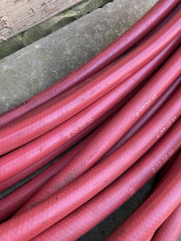

formariz 12,381 #21 Posted February 10, 2022 @Maynard here is one of my hoses I just noticed. Oily and sticky for the first time ever. Not a cheap hose either US made and less than a year old. 1 Share this post Link to post Share on other sites
