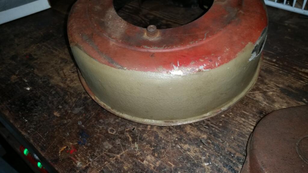

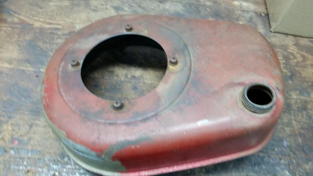

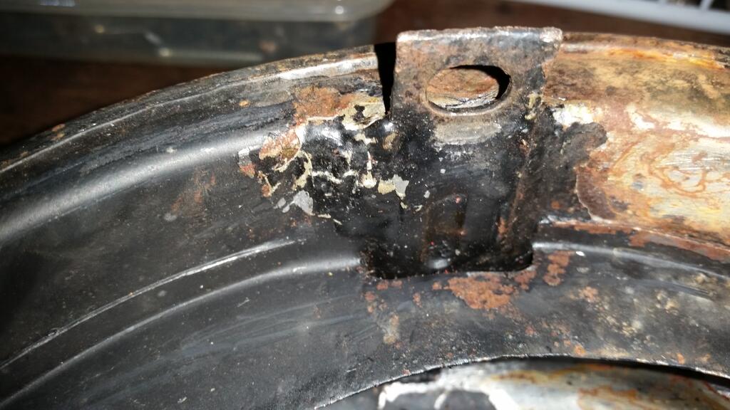

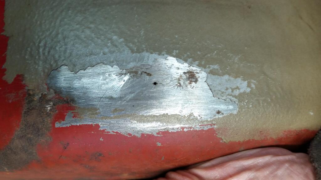

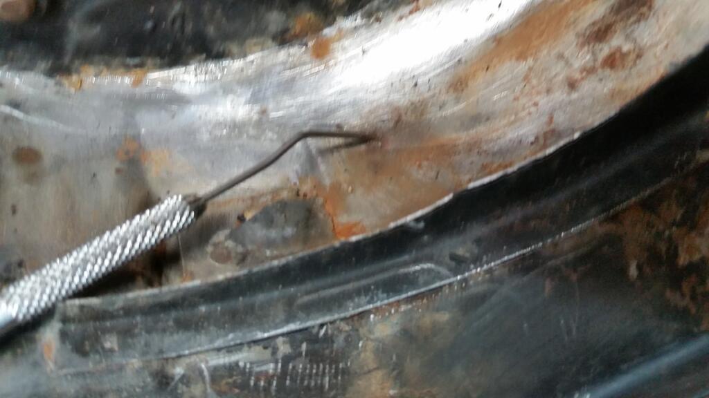

WHX?? 58,347 #1 Posted February 8, 2022 RE-67..... actually took a couple of them. My thoughts is to solder up the pin holes followed by a tank sealer kit Here It appears this tank has been problematic through it's years as evidenced by some PO fixes.... no Madge not saying it was you....... way before your ownership. Looks like one of the tank bungs (it has two of them 1/8 npt) was leaking and some sort of JB weld or epoxy was applied. Also looks like one of the mounting bracket got the same treatment along with a patch along the side. It also has what looks like a factory? coating applied to the underside. It's peeling off with help of the jack knife and moisture is getting underneath it promoting rust through. It also has some wear points where it vibrates on the mounts. Thoughts here are to beef up these areas with some light brazing. Another thought is to blast off the whole underside some brazing or solder and re-coat it with?? Would like to keep the patina on the topside if possible. This was a common tank in the day used on vertical small HP Teckys that were used on pull behind tillers and what not. Hen's teeth these days so only hope is resto. Thoughts on other resto options?? 2 Share this post Link to post Share on other sites
