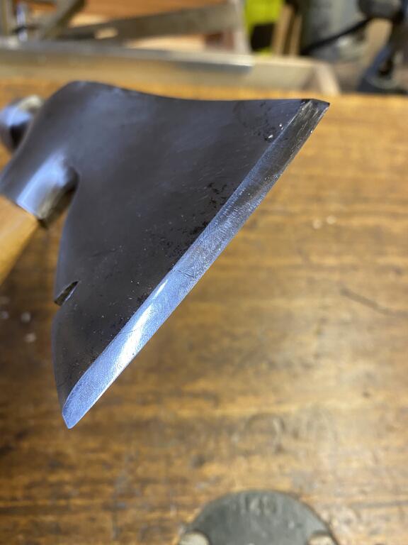

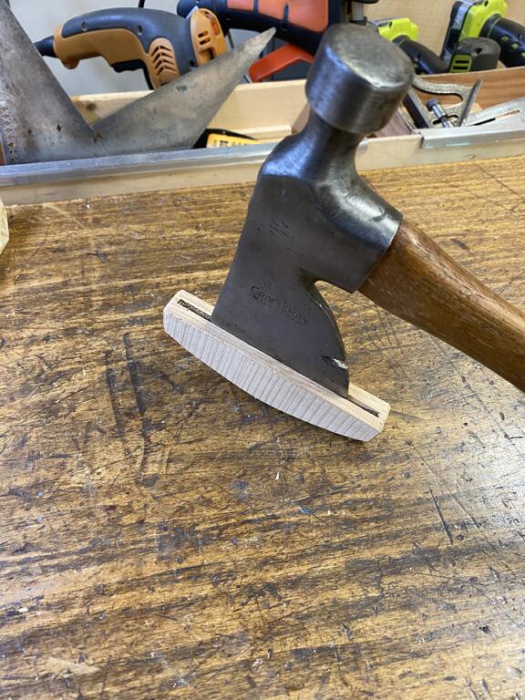

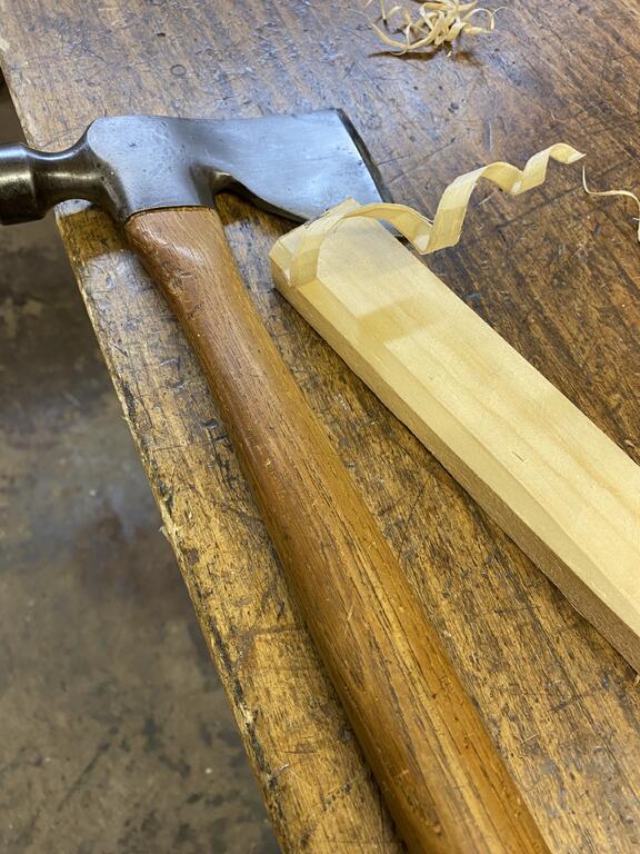

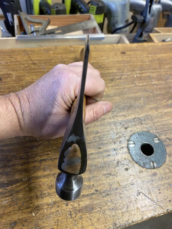

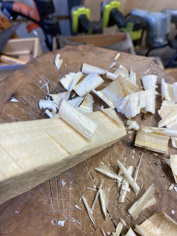

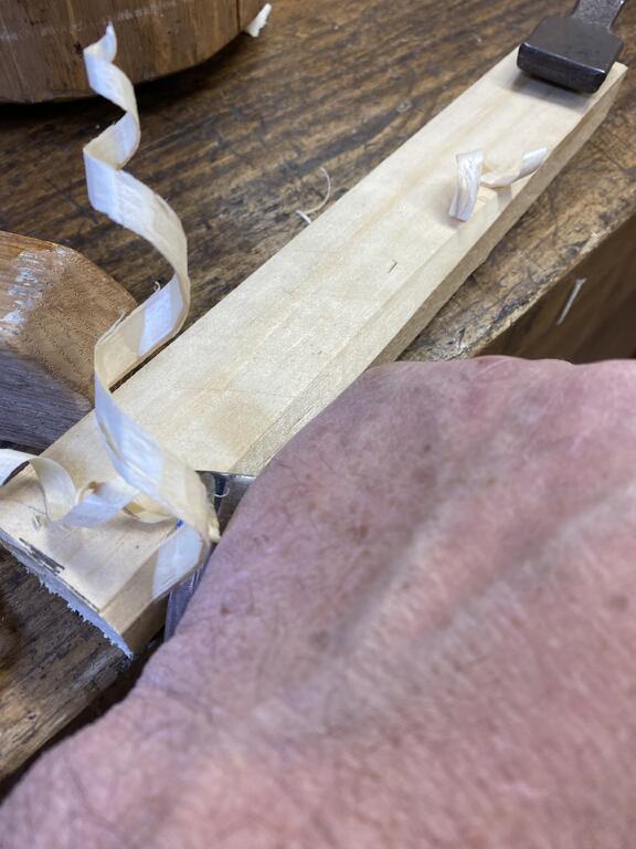

formariz 12,379 #1 Posted February 7, 2022 (edited) Also pretty much totally forgotten today, is the Carpenters Hatchet. Built unlike other hatchets it features the obvious hammer end. It is however the edge end that makes it an incredibly efficient tool. It is much thinner in section and usually beautifully balanced. It is also handled differently since it is used in a different manner usually choking it or even handling the blade. Essentially it is more of an adze than a hatchet and used as such. Here it is used many times as a combination carving tool and draw knife. It is kept razor sharp. I have a different bevel on each side since I am right handed and use it on much as stated before. It is an elegant tool that is very useful in all aspects of carpentry. There was a time when it was a common tool in a carpenters tool box. Today of course most have never even seen one much less use them. Elegant and light Designed to fit one’s hand upfront Thin well balanced head Well tempered edge like a good chisel Will take a razor edge and keep it works like an adze can be used like a carving tool or drawknife one of my favorite tools Edited February 7, 2022 by formariz 1 5 4 Share this post Link to post Share on other sites

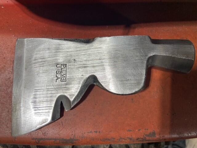

OutdoorEnvy 1,816 #5 Posted February 7, 2022 That is an awesome carpenter's hatchet farmariz! You have it in tip top shape too! I love old hand tools! Don't get me started on them...but here is a nice Plumb carpenter's head I need to get a handle for soon. It was pretty dirty but cleaned up nice and looks hardly used! It is sharp and ready for a handle! Used to you could get wooden handles at the hardware store for about anything, now you have to order most of them. The head in the pic is on my C-100 project tractor so technically fits in with the forum here 3 1 Share this post Link to post Share on other sites

formariz 12,379 #7 Posted February 7, 2022 @jabelman@OutdoorEnvy, Good to see others using them. It’s a great tool. It’s one of my favorite tools. Love making long chamfers and Lamb’s tongues with them. The handles are easy to make. Not as contoured as a usual hatchet since it is used differently. Share this post Link to post Share on other sites

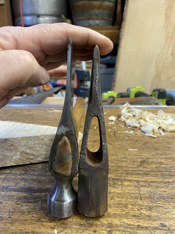

formariz 12,379 #8 Posted February 7, 2022 You can see the difference here from the early original versions. Much thicker cross section . By then mostly roofers used them and split shingles by striking shingle on face amongst other uses. Early versions are much more like an adze blade having less than half of the weight. The newer version is too heavy in cross section to be used like that. 2 Share this post Link to post Share on other sites

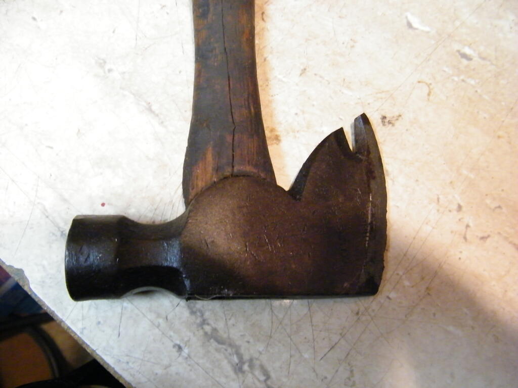

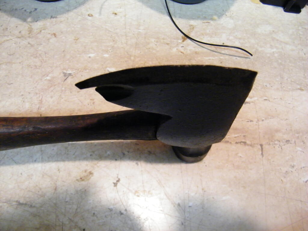

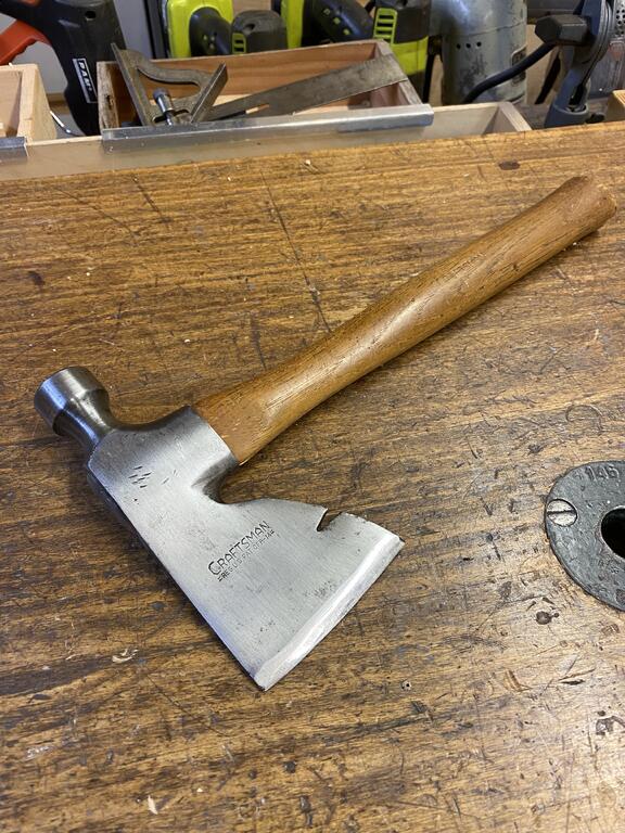

stevasaurus 23,739 #10 Posted February 7, 2022 I knew I had one of those. Shows more use then Cas's. I think it was my Grandfathers. Has Collins & CO on the blade. 2 Share this post Link to post Share on other sites

formariz 12,379 #13 Posted February 7, 2022 6 minutes ago, stevasaurus said: I knew I had one of those. Shows more use then Cas's. I think it was my Grandfathers. Has Collins & CO on the blade. WOW. I actually never seen one worn to the nail slot like that. That guy really worked a lot. 1 Share this post Link to post Share on other sites

stevasaurus 23,739 #15 Posted February 7, 2022 Cas, I just noticed mine and yours have the same regular hammer head, not like the others shown. Mine is also thinner then the others, but not quite as thin as yours. It is also really sharp, even with some minor nicks in the blade. Share this post Link to post Share on other sites

formariz 12,379 #17 Posted February 7, 2022 31 minutes ago, stevasaurus said: Cas, I just noticed mine and yours have the same regular hammer head, not like the others shown. Mine is also thinner then the others, but not quite as thin as yours. It is also really sharp, even with some minor nicks in the blade. Older ones will have the hammer head shape like that and of course be thinner. Later they became heavier with a thick cross section . The nice smooth shapes like where to rest ones finger became less pronounced. A lot easier to produce and as times went on the usage changed. 2 Share this post Link to post Share on other sites

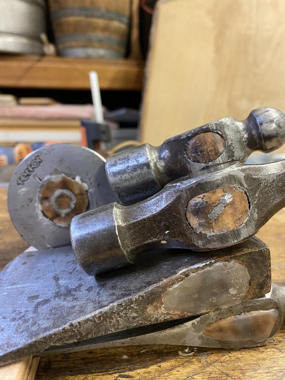

Pullstart 70,504 #19 Posted February 7, 2022 I do know that I need a new handle on it. It has about umpteen nails as wedges, maybe some screws, other wooden wedges, etc… and it’s still loose! I kept it in the basement at the old house, next to the wood stove for splitting little kindling. It’s nowhere near razor sharp! Share this post Link to post Share on other sites
formariz 12,379 #20 Posted February 8, 2022 19 minutes ago, Pullstart said: I do know that I need a new handle on it. It has about umpteen nails as wedges, maybe some screws, other wooden wedges, etc… and it’s still loose! I kept it in the basement at the old house, next to the wood stove for splitting little kindling. It’s nowhere near razor sharp! Properly making but more importantly installing a handle on a tool so it stays for the life of tool is also sort of a lost art. Lots to know and understand in that subject. Fitting and correct wedging are critical. If done correctly should never get loose. The looseness is also created many times through negligence and improper use of tool. Additional wedges, nails and submerging in water are all mistakes that will just prolong the misery of using a tool in that condition. It is altogether dangerous. After fitting a handle I always melt wax onto end sealing it. Perhaps I’ll do a “making and fitting handles thread?” 3 1 1 Share this post Link to post Share on other sites
