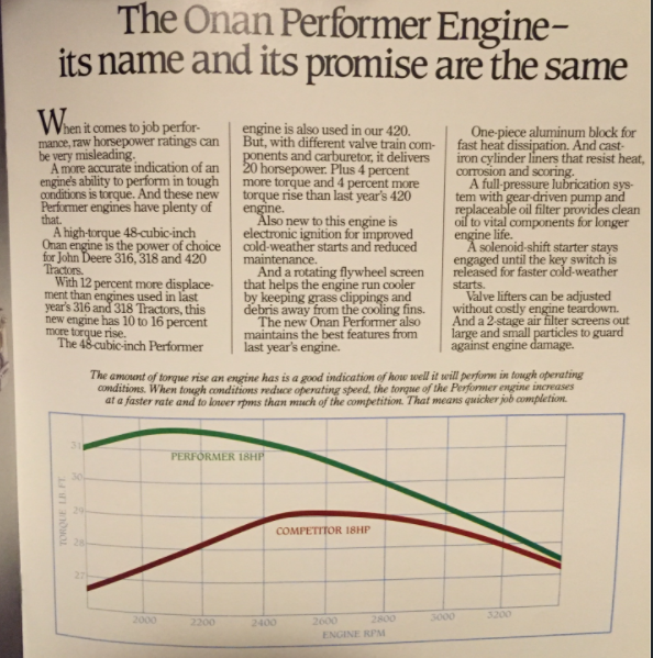

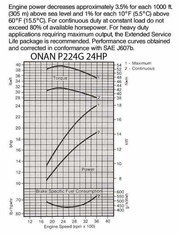

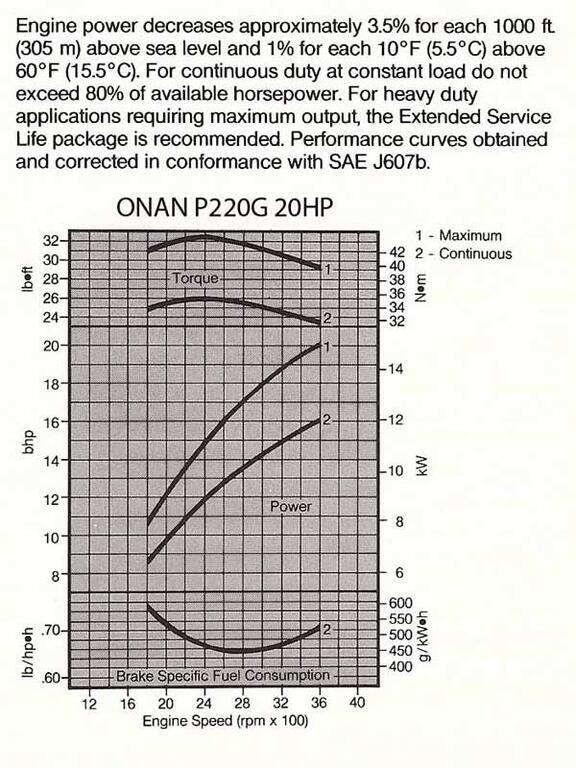

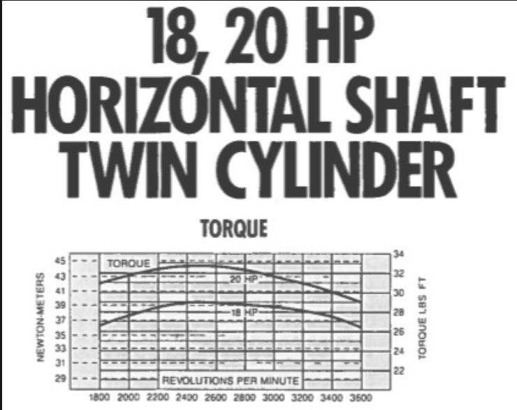

sgtsampay 117 #1 Posted January 24, 2022 (edited) So, I have been curious about this topic for a long time. After lots of hunting around the internet, I found some old data. I figured if I shared it, then maybe some of your people with much better knowledge can talk about this topic. Basically, why does everyone say that the Onan makes "gobs more torque" than really anything else? According to this data the Kohler M20 vs. the Onan P220g are right neck and neck. The 18Hp Onan makes more than the M18 but only a couple FTlbs. Now for comparison, the K341 I have in my C160, makes a max of 29ftlbs @ 2,200rpm according to a source i found. I still don't have a graph to confirm it though. Anyways, doesn't seem that much power than my K341 for the 20HP twins. Anyone else have some feedback? Here are the graphs. Kohler M18/M20 Onan P218 Onan P220 Onan P224 Now in regards of the 24hp Onan, it truly makes a difference of up to 40ftlbs. But besides the gravely, any other company use it? Edited January 24, 2022 by sgtsampay 1 Share this post Link to post Share on other sites

kpinnc 17,154 #3 Posted January 24, 2022 Curious what exactly is included in the "extended life service package"... I have an old Toro Groundsmaster that has a P220 with a remote oil filter and oil cooler. That mower had 2500 hours on it 10 years ago when I started using it. No doubt now over 3000 hours, and it purrs like a kitten and is very strong. Bet that cooler has something to do with it? 1 Share this post Link to post Share on other sites

Snoopy11 5,731 #8 Posted January 24, 2022 Wonder why they are only laying out 2,200 rpm...? Dyno tests by various groups that I have read behind all run a bit higher... Don 1 Share this post Link to post Share on other sites
lynnmor 8,627 #9 Posted January 24, 2022 21 minutes ago, kpinnc said: Curious what exactly is included in the "extended life service package"... They had better valves and a few other minor bits. 1 Share this post Link to post Share on other sites

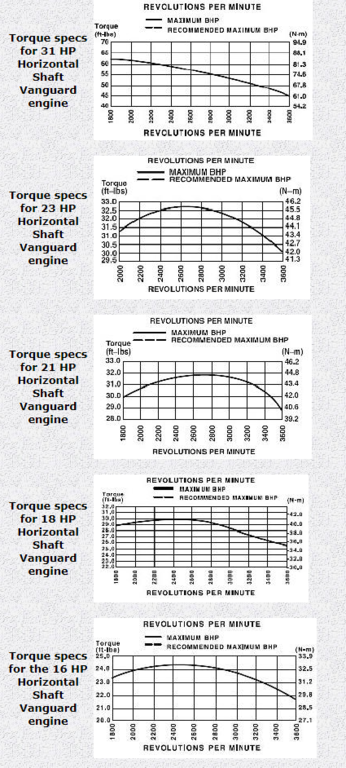

sgtsampay 117 #12 Posted January 24, 2022 Some more data to add to the list. Here are the Vanguards. Again, no different. Interesting. So just better emissions? 2 Share this post Link to post Share on other sites

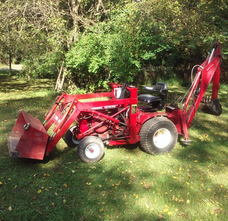

roadapples 6,987 #16 Posted January 24, 2022 First off, as far as sound, I couldn't care less. At 73, the quieter the better. I have a C160 with Ark 550 loader and backhoe. I don't think the hoe weights less than 400lbs. Before the hoe was installed I tried to pick it up with the bucket and couldn't move it. So I've got about all the traction I can handle. Yet when scooping up a load of stones, ground, etc, it still wants to spin the wheels if I'm not careful. Don't know what I'd do with any more torque.... 3 2 Share this post Link to post Share on other sites
kpinnc 17,154 #17 Posted January 24, 2022 5 minutes ago, roadapples said: Don't know what I'd do with any more torque.... Very true. The only time any of my machines struggle is if they have to backup my zero turn. The grass here is thick, heavy fescue. It really takes a toll on whatever has to cut it. This is the only thing I've ever seen make my machines struggle a bit. ...but they still get it done! 3 Share this post Link to post Share on other sites
sgtsampay 117 #18 Posted January 24, 2022 1 hour ago, roadapples said: First off, as far as sound, I couldn't care less. At 73, the quieter the better. I have a C160 with Ark 550 loader and backhoe. I don't think the hoe weights less than 400lbs. Before the hoe was installed I tried to pick it up with the bucket and couldn't move it. So I've got about all the traction I can handle. Yet when scooping up a load of stones, ground, etc, it still wants to spin the wheels if I'm not careful. Don't know what I'd do with any more torque.... I would love to see a picture of your c-160! That must be awesome! I also agree that more torque is pointless at times however like a big mower deck or snowblowing more power is always helpful. Besides ,I must be missing something or wheelhorse would have never gone to the twin cylinder engines.. 2 Share this post Link to post Share on other sites

roadapples 6,987 #22 Posted January 24, 2022 ...@sgtsampay 2 hours ago, sgtsampay said: I would love to see a picture of your c-160! That must be awesome! a big mower deck or snowblowing more power is always helpful. I have no problem with bigger engines and more power. I have a 520 strictly for a 2 stage blower. That or a 60" deck is the only reason I would want anything bigger than a single 16..... 2 2 Share this post Link to post Share on other sites
ebinmaine 77,341 #23 Posted January 24, 2022 3 minutes ago, roadapples said: Love this beast. Never see my woman if she ever got one. You'd have to pry her off the seat wit' a crowbar. 2 1 1 Share this post Link to post Share on other sites
Achto 31,009 #24 Posted January 24, 2022 (edited) A quote from Briggs as to why they choose to switch to displaying the torque of an engine instead of the HP. "While horsepower has been traditionally used for these applications to measure engine power, torque values are not new for engines. Gross Torque is the immediate twisting force required to turn a blade or pump at a given moment. Thus, torque is the way to measure the rotational force a machine can produce." While I agree that HP is important to us plus lets face it, it is the term we grew up with and are most familiar with. I kind of compare it to living in the US and measuring with the metric system. For some reason it's just not natural to most of us. So let me give one example of the difference that torque makes. A Cummins 350 is rated at 350HP at 1800RPMs and a torque rating of 1175ftlbs of torque at 1300RPMs. A Dodge 5.7 Hemi is rated at 395HP at 5600RPMs and a torque rating of 400ftlbs of torque at 4000RPMs Given these HP facts one might want to choose the 5.7 Hemi. More horse power!!! Which would be a good choice depending on what you want to do with it. If I was putting it in a hot rod car, I'm all for the 5.7. But if you were putting it in a semi truck or a farm tractor, which one would you choose??? The higher torque rating is more capable of doing the heavy work. A Car & Driver article that explains torque and horse power. https://www.caranddriver.com/news/a15347872/horsepower-vs-torque-whats-the-difference/ Edited January 24, 2022 by Achto 3 1 1 Share this post Link to post Share on other sites
kpinnc 17,154 #25 Posted January 24, 2022 5 minutes ago, roadapples said: have no problem with bigger engines and more power. I have a 520 strictly for a 2 stage blower. That or a 60" deck is the only reason I would want anything bigger than a single 16..... Holy Crapolie, Batman! That is one decked out C-160! 2 1 Share this post Link to post Share on other sites
