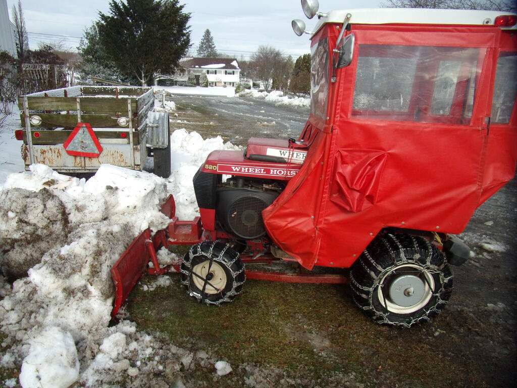

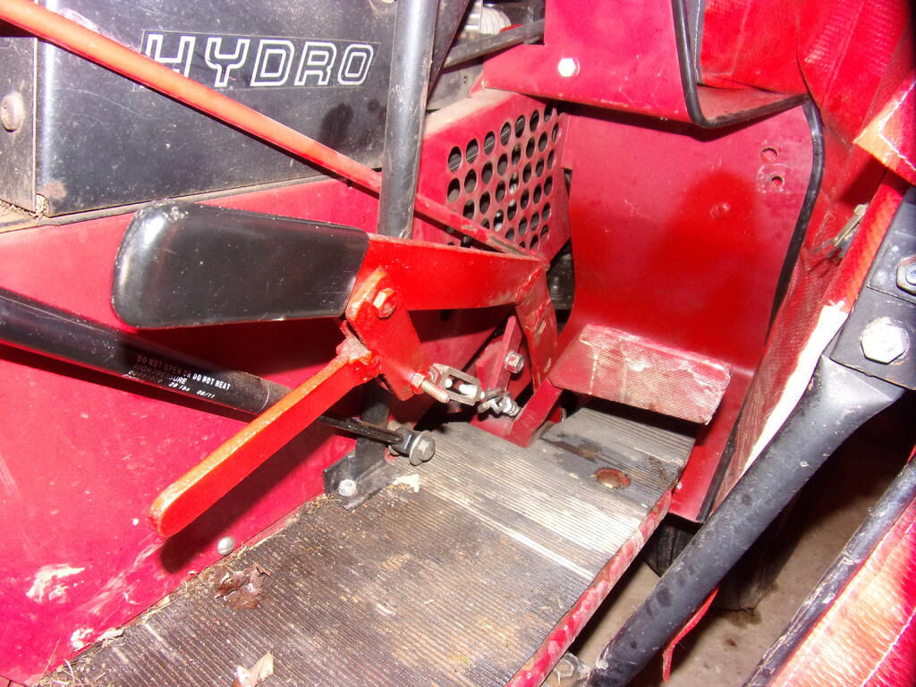

Ed Kennell 47,750 #5 Posted January 24, 2022 (edited) 9 hours ago, formariz said: So on my 520 I have the belt cover drilled to let the hot air out from rear of engine. I need some ideas on how to direct that hot air into the snow cab. I am sure many of you have done that . Much appreciated as always. Some fab and resewing required to fit cab cloth to metal heat houser. The origonal set up was with a SS blower. I changed to a 54" plow blade several years ago. Here you can see ; vented belt guard motion control foot pedal pnuematic cylinder for foot pedal blade angle control lever inside of heat houser I recently added a scoop over the louvered hood to capture that heat and direct it into the cab. I can feel some air coming in but it is not really hot enough to warm the cab. Because of the location, I do feel it will help to prevent the windshield from fogging. Some of the other mods can be seen here; seat and fender pan raised 2" Foot rests moved forward 2" filler tires wheel weights rear weights front weight and frame stabalizer 2 link Vee Bar chains on rear 2 link chains on front cab head lights cab blinking clearance lights cab mounted mirrors Edited January 24, 2022 by Ed Kennell 2 6 Share this post Link to post Share on other sites

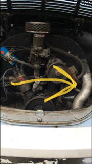

WheelHorse520H 710 #8 Posted January 24, 2022 If you go to an auto parts store and pick up some foil hoses like they used for heating on the old VW Beetles to direct the air into the cab. Or even across the top of the dash with some small vents or a control flap or something. That’s all I’ve got for ideas. I’ll let you know if I think of anything else. 2 Share this post Link to post Share on other sites

Ed Kennell 47,750 #23 Posted January 26, 2022 2 minutes ago, Jeff-C175 said: going with hydronics is more trouble and expense than it's worth. I had the same thought Jeff. My simple vented belt guard collector keeps my cab 30 degrees warmer than the outside temp. I understand , sometimes we all need a project regardless of how effective or expensive it may be. 3 Share this post Link to post Share on other sites
