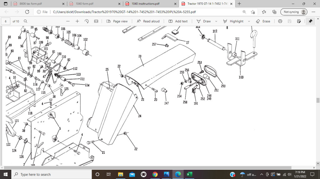

pfrederi 21,274 #3 Posted January 22, 2022 interesting parts manual indicates 17 between 2 fenders.. if it warms up I may go down to the barn and look at mine... (warm up may be awhile) 1 Share this post Link to post Share on other sites
953 nut 70,058 #4 Posted January 22, 2022 Looking at the IPL (Illustrated Parts List) it appears that there are about 14 bolts for each fender and the tail light wiring. Some are a bit of a PITA to get back in so don't tighten any of them until all are started. 1 Share this post Link to post Share on other sites

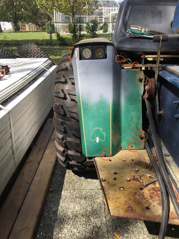

19richie66 17,937 #10 Posted January 22, 2022 Seven Share this post Link to post Share on other sites
