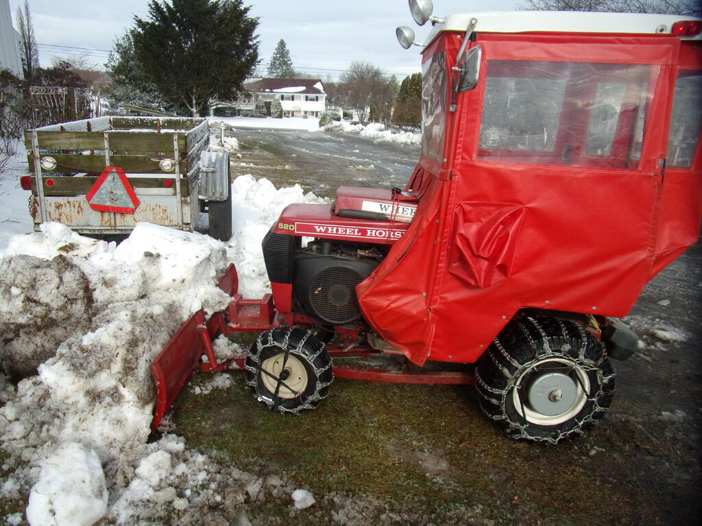

Achto 32,891 #5 Posted January 17, 2022 (edited) 51 minutes ago, Joe 77 B100 said: It currently has turf tires with chains Turf tire with chains is usually a good combo. If you decide to put ag tires on the back then you will want cross linked chains. Other wise the chains tend to fall down between the lugs. I have Carlisle X-trac snow blower tires on the front of my snow clearing tractor. They give good bite for steering. I run turf tires with chains on the rear. Edited January 17, 2022 by Achto 5 1 Share this post Link to post Share on other sites

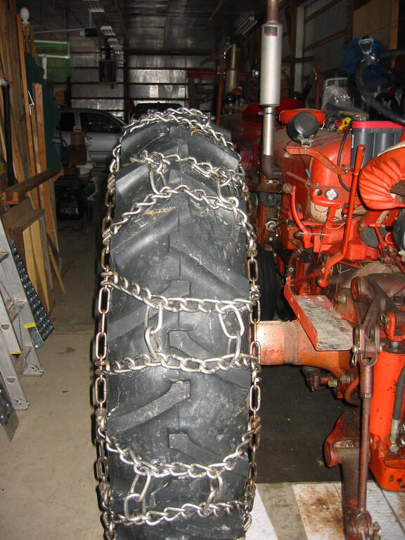

pfrederi 21,274 #6 Posted January 17, 2022 Turfs chains and weights. As achto said if you use AGs you need special chains that won't get down between the lugs like the ones in the picture I use on my big tractor. . AGs with out chains have a big issue in reverse they are directional tires and have little traction in reverse. this is especial bad if you have raised your blower and try to back up as the weight is transferred to the front. 4 Share this post Link to post Share on other sites

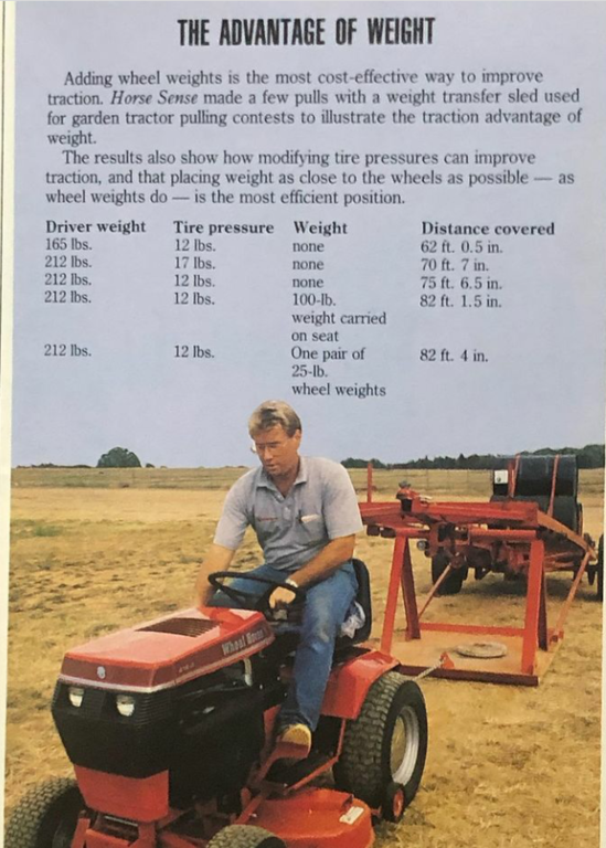

TJ5208 1,841 #13 Posted January 17, 2022 (edited) Yes it does make a difference Wheel Horse did a test I'll have to find it Edited January 17, 2022 by TJ Salyers Share this post Link to post Share on other sites

TJ5208 1,841 #23 Posted January 18, 2022 Here's the test 6 Share this post Link to post Share on other sites
ebinmaine 81,047 #24 Posted January 18, 2022 2 minutes ago, TJ Salyers said: test Excellent post! I've never seen that. Note how a tire with less air pressure pulls further. Because it's more flexible and has better grip. My fluid filled rear tires actually have zero air pressure.... Share this post Link to post Share on other sites
