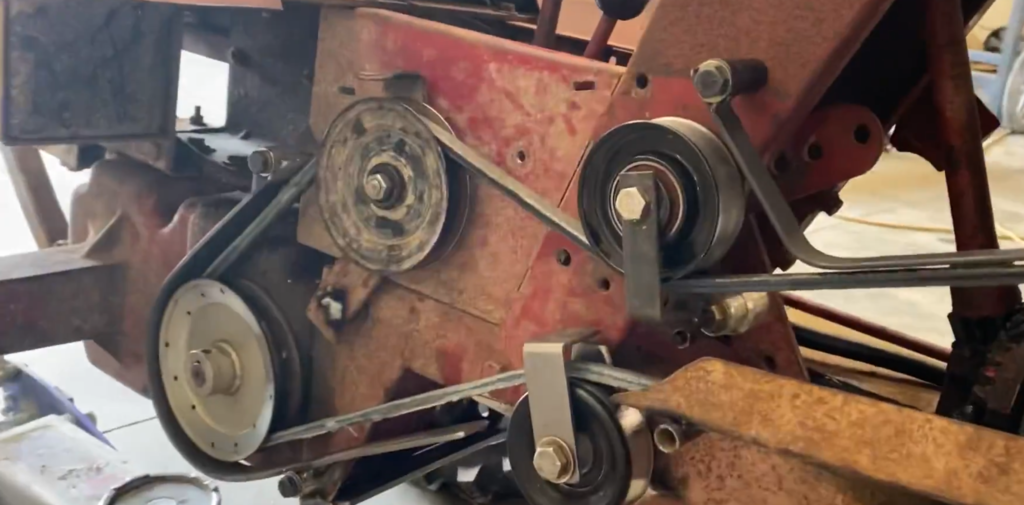

Original on a C series, as we know, covers the whole area of travel of the entire belt except the very ends around the engine and transmission pulleys.
I'm building something like "Captain 315" & "Creepy crawler" on YT have done to increase grip...
but ENCLOSING the BELT ONLY
in a C channel as referenced by @Ed Kennell.
The lower portion would be fairly easy as it's a straight shot.
The upper half... Not sure yet.
Perhaps a pulley setup sort of similar to this:
Which would give a fuller wrap at the rear pulley.
23 minutes ago, Ed Kennell said:
Steel would be my choice.  It is harder and would wear better.   Also,  IMO, steel is much easier to fab tham aluminum.    It cuts and grinds easier... no smearing and clogging of abrasive wheels and it is easier to weld. .
Thanks for that reminder. Very true.
27 minutes ago, Ed Kennell said:
  I can see 1X1 steel "U" channel working well to cover and support a belt.     Just remember the top loop will need to move vertically with the belt tensioner pulley
1 x 1 or .75 x .75 is what I was figuring. The larger would certainly offer a bit more rigidity and adjustment.
I hadn't considered to make the top piece movable but that could be a good idea.
Fastening it directly to the clutch lever somehow with a sliding pivot could give constant proper position of the top of the belt.

His tractor is working backwards from yours he's lossen the belt on the transmission pulley,  You need the bottom of the top belt supported and the bottom of the lower to loosen on the engine pulley this will be when the belt is stopped with the clutch pushed in. Set that up first fixed position should work just fine,  Then add the rest it will just be a guard doesn't have to be that close to the belt, you can set it with the clutch out.
