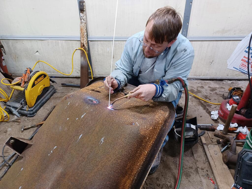

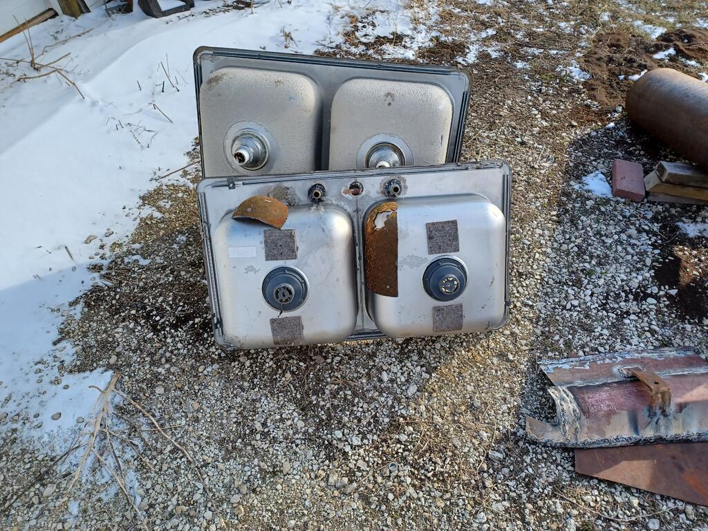

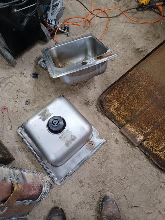

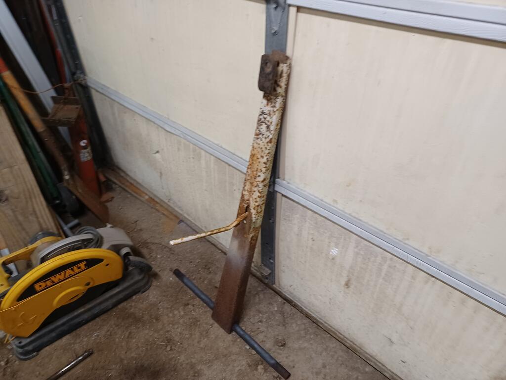

Elkskin's mower junkyard 1,117 #1 Posted January 16, 2022 I tried my best to fix the cart and well ended up asking for help. Buddy of mine said find a kitchen sink. So I went to the junkyard got 2 stainless steel sinks for 15 bucks lol. I cut one apart so we can dismantle it. And he got the axle out for me 7 Share this post Link to post Share on other sites

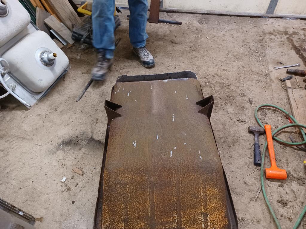

Elkskin's mower junkyard 1,117 #4 Posted January 17, 2022 1 minute ago, Pullstart said: Keep the soap dish, it might come in handy Lol now that's funny. So the sinks are thinner steel but it will work. He is going to run a brace for the latch 6 2 Share this post Link to post Share on other sites
Pullstart 71,366 #5 Posted January 17, 2022 The dude brazing… NEEDS torch goggles! I’ve been in the hospital for weld flash on my eyes, I know that stuff matters. You only get two eyes, once they’re reached you don’t have any. 2 2 Share this post Link to post Share on other sites
WHX?? 58,303 #6 Posted January 17, 2022 25 minutes ago, Pullstart said: The dude brazing… NEEDS torch goggles! I dunno Kev I never used them and I'm still blind... Seriously I could never see with the goggles when brazing and the flash is nowhere near like welding. Still of course for eye protection. Now with the invention of all adjustable auto helmets no reason not to use one even for grinding flash. Nicest save we've seen on a tub for awhile Junkyard. .. 1 Share this post Link to post Share on other sites

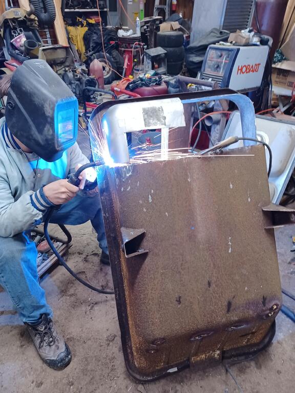

Jeff-C175 7,211 #7 Posted January 17, 2022 I didn't know you could weld stainless to plain steel? 1 Share this post Link to post Share on other sites
Elkskin's mower junkyard 1,117 #8 Posted January 17, 2022 3 minutes ago, Jeff-C175 said: I didn't know you could weld stainless to plain steel? I seen it done alot lol 2 Share this post Link to post Share on other sites
WHX?? 58,303 #9 Posted January 17, 2022 I was gonna ask that too Jeff. School us Junkyard. Signed No nothing novice welder. 1 Share this post Link to post Share on other sites
Jeff-C175 7,211 #10 Posted January 17, 2022 (edited) 13 minutes ago, WHX?? said: Signed No nothing novice welder. Me too! My neighbor tells me that my welds are "farmer welds". They stick but they look like 5h1t. @kpinnc told me to " make them stick and grind off the ugly". Edited January 17, 2022 by Jeff-C175 3 Share this post Link to post Share on other sites
kpinnc 19,008 #11 Posted January 17, 2022 (edited) I can only add this: tack up all the way around. Don't weld much at all in one spot at a time so as to not warp your sheet metal. It takes longer but will give a better result when finished. A little here, then the opposite side. Small drips of water can be used too if needed to cool your work. Not fire hose levels, just a little. And like Jeff said- grind off the ugly. Edited January 17, 2022 by kpinnc 5 Share this post Link to post Share on other sites
Pullstart 71,366 #12 Posted January 17, 2022 After all the tack welds every inch or so, peen them down, then grind them flat, then repeat. 2 Share this post Link to post Share on other sites
8ntruck 9,339 #13 Posted January 17, 2022 13 hours ago, Jeff-C175 said: I didn't know you could weld stainless to plain steel? Depends on the alloy of the stainless. The higher the chrome and nickel content, the harder the welding. Why idea what kind of weld wire he was using? Flux core or MIG? 1 Share this post Link to post Share on other sites
Jeff-C175 7,211 #14 Posted January 17, 2022 10 minutes ago, 8ntruck said: idea what kind of weld Looks like a gas bottle on the back of his cart so I'm guessing MIG. 1 Share this post Link to post Share on other sites
8ntruck 9,339 #15 Posted January 17, 2022 18 minutes ago, Jeff-C175 said: Looks like a gas bottle on the back of his cart so I'm guessing MIG. Ok. I missed that. I was wondering about the alloy of the weld wire. 2 Share this post Link to post Share on other sites
