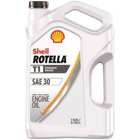

Ok you got me to bite. My name is bob but I’m not the oil guy. Modern SN rated oils should be avoided and that includes Mobil 1. In any viscosity. Diesel oils are better and Rotella in 15-40 or straight 30should suffice. Other than that look for a straight 30 that has a rating of sl, sj, or sh. Lowe’s carries one called pro select and TSC has Briggs oil in those ratings. Your flat tappets will thank you.

I use Rotelle T1 straight 30 with 1 oz of ZDDP per quart.
API classifications dictate the amounts of additives included in the blend.
  • Like 2

23 hours ago, SylvanLakeWH said:
:text-welcomeconfetti:
I’m in Michigan and I run straight 30 wt rear round…
:twocents-twocents:
Down here I put that s**t in everything. Actually I use their SAE 40 in any of my old flathead engines, those old L heads are pretty dirty running engines with no filters. If you run a 10w30 in them you'll burn a little more oil than the straight weight. Your 16 hp has a filter and tighter tolerance especially with only 200 hr. I would think any quality 10w30. be it straight, a blend, or synthetic well work just fine all year round, just depends on how much you want to spend:twocents-twocents:. We sometimes tend to over think thing here, it's a 16hp garden tractor designed to do what it's suppose to do with the oil the manufacture recommends, it's not a Bugatti Veyron ;).
