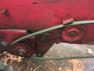

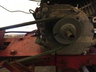

WheelHorse520H 710 #23 Posted January 9, 2022 Here are the photos I got this afternoon. That’s with the clutch / parking brake set. You can see on the engine the bolt holes are covered by the pulley. I wanted to keep the rods where they were but then the pulley was pulling the belt off the clutch. Could / should I put them on the frame somewhere? Share this post Link to post Share on other sites
pfrederi 21,049 #24 Posted January 9, 2022 What kind of engine do you have on this unit Doesn't look like and HH-60 to me.... Share this post Link to post Share on other sites
WheelHorse520H 710 #25 Posted January 9, 2022 56 minutes ago, pfrederi said: What kind of engine do you have on this unit Doesn't look like and HH-60 to me.... A 6.5 hp Greyhound single cylinder. Made for Harbor Freight Greyhound is the predecessor to the famous Predator engines. I want the HH-60 if I can find it. Share this post Link to post Share on other sites
