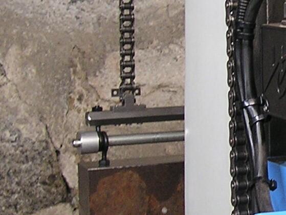

ri702bill 13,190 #11 Posted January 9, 2022 A possible answer just stared back at me while downstairs. I bought several styles of #40 tab chain connector links for the counterbalance project. There are no #41 tab chains but the side plates are the same .... may do a mix & match to put a tab plate on the inside of the chain - it would swipe a path every full revolution - IF there is enough clearance for it .... Bill Share this post Link to post Share on other sites
Handy Don 17,562 #12 Posted January 11, 2022 On 1/9/2022 at 10:54 AM, ri702bill said: A possible answer just stared back at me while downstairs. I bought several styles of #40 tab chain connector links for the counterbalance project. There are no #41 tab chains but the side plates are the same .... may do a mix & match to put a tab plate on the inside of the chain - it would swipe a path every full revolution - IF there is enough clearance for it .... Bill IMPORTANT Remember that the chain in the blower goes over the idlers and drive sprockets with the "inside" of the chain loop hitting the sprocket but it goes over the auger sprocket with the "outside" of the chain loop hitting the sprocket. BOTH SIDES OF THE CHAIN ARE TOUCHING SPROCKETS. Any sort of protrusion from the chain will jam the chain. @JimmyJam, @peter lena I agree with @wallfish the routing of the chain and the forces will keep the essentials clear. The rest is cosmetic. Share this post Link to post Share on other sites
ri702bill 13,190 #13 Posted January 11, 2022 I took advantage of the decent weather yesterday to remove the upper guard to inspect and lube the chain. There is not enough side clearance to do what I suggested, so ..... Might be able to use a detailing or bottle brush to get as much snow out of that area ..... Bill Share this post Link to post Share on other sites
