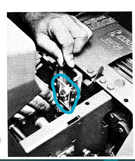

pfrederi 21,049 #2 Posted January 7, 2022 Download the manual here. Page 12 is diagnostic. First step make sure the plastic slider is in place and moves freely when you operate the motion control. Unfortunately if it is OK the next two steps are more involved. You will want a warm place to work... 1 Share this post Link to post Share on other sites
tallen4392 71 #3 Posted January 7, 2022 this is my first hydro where is this plastic slider you talk about and could that make it it go very slow in reverse when it gets warmed up it sounds like if the problem was with that it would not matter if it was hot or cold i was going to change the hydro filter and fluid to start with can you get those filters at napa i thought i saw one under there Share this post Link to post Share on other sites
pfrederi 21,049 #4 Posted January 7, 2022 The slider is under the panel between seat and hoodstand. In the first post you didn't mention the difference temperature made. Does it back up OK when it is cold then get worse as it gets hot?? Does forward response change due to temperature?? Are you using ATF or Motor Oil Filter is Wix 51410 or Napa 1410 1 Share this post Link to post Share on other sites

953 nut 68,508 #19 Posted January 13, 2022 Your Cam Follower plate may be bad, had the same thing happen on my Sundstrand and that was the fix. Lowell @wheelhorseman can fix you up. if that is the problem. https://wheelhorsepartsandmore.com/product/5996-cam-plate-for-hydrostatic-transmission/ Share this post Link to post Share on other sites

953 nut 68,508 #22 Posted January 13, 2022 Yes, it is in the picture that @pfrederi posted earlier. If it is cracked it won't go full range. It is a bit challenging to replace but can be done with normal tools. Share this post Link to post Share on other sites

Wheelhorse#1 1,962 #24 Posted January 14, 2022 (edited) Here’s a better pic in the machine.I need to replace mine as well as I’m sure it’s worn . Edited January 14, 2022 by Wheelhorse#1 Share this post Link to post Share on other sites
tallen4392 71 #25 Posted January 17, 2022 mine looks a bit different is it just a matter of removing the one one it and bolt that goes through it and then trying to get the slider out and install the new one Share this post Link to post Share on other sites
