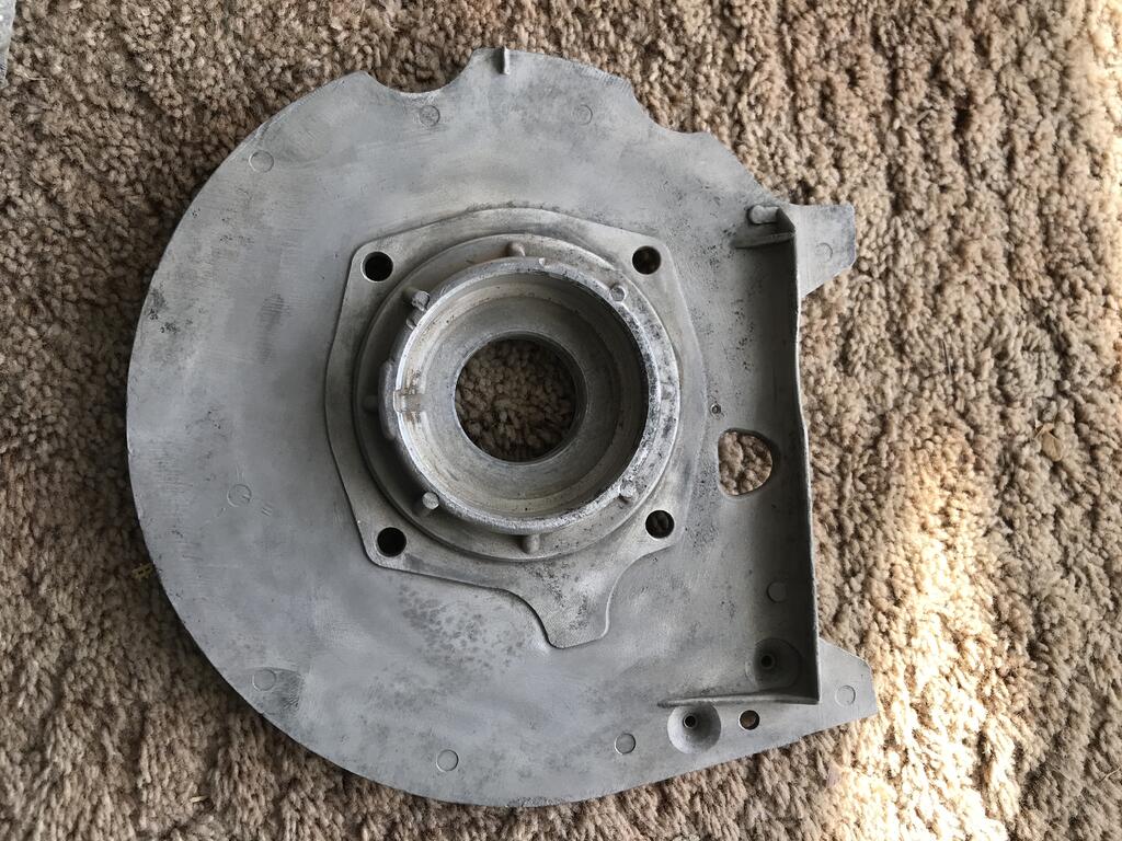

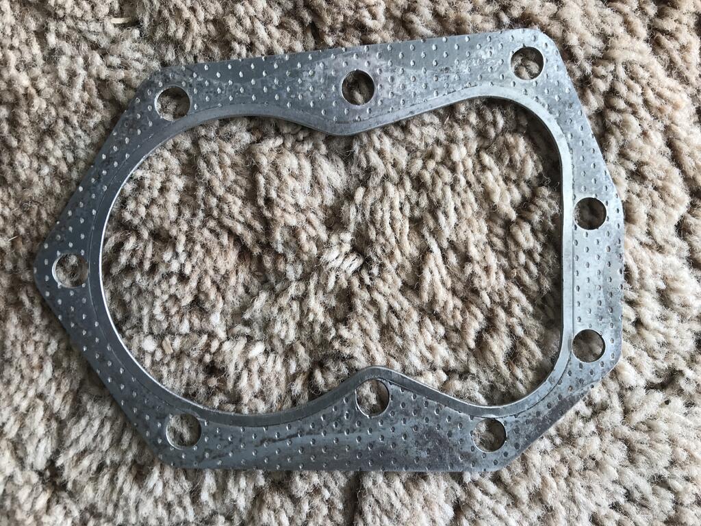

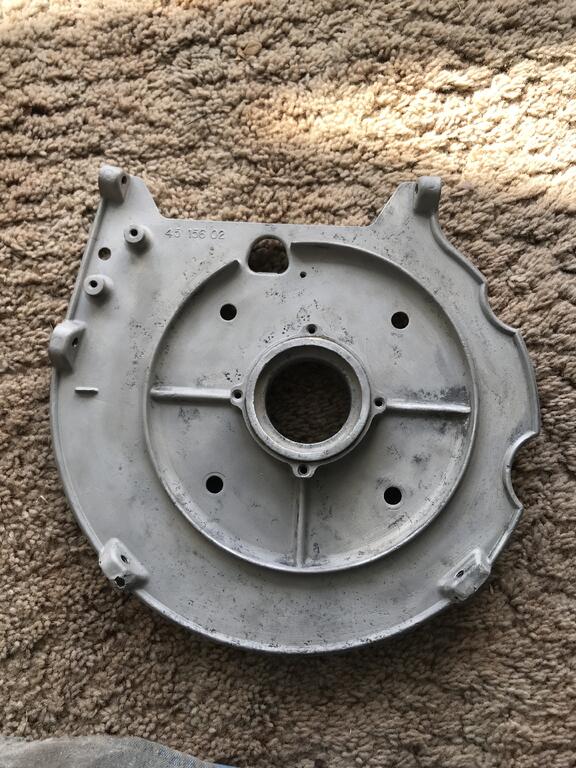

oliver2-44 11,758 #52 Posted January 9, 2022 This is a head gasket with what I call the solid fire ring. See the solid 1/8” side smooth metal on the inner inner diameter of the head gasket The above photo is the aluminum bearing plate This photo is the Infineon side of the plate. Your crankshaft bearing goes in that center ring Share this post Link to post Share on other sites
DeepH2O 66 #53 Posted January 9, 2022 25 minutes ago, oliver2-44 said: This is a head gasket with what I call the solid fire ring. See the solid 1/8” side smooth metal on the inner inner diameter of the head gasket The above photo is the aluminum bearing plate This photo is the Infineon side of the plate. Your crankshaft bearing goes in that center ring I’ve got a new head gasket coming and head! That’s one bolt out of the way. Thanks for the pics!! Share this post Link to post Share on other sites

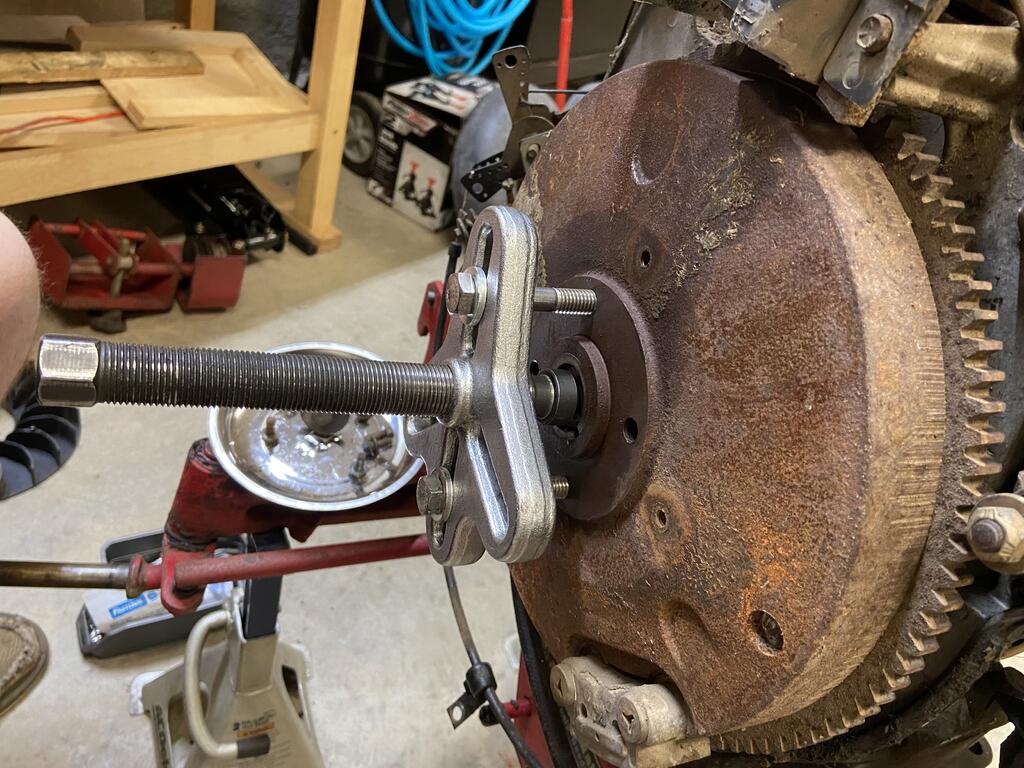

oliver2-44 11,758 #55 Posted January 9, 2022 (edited) On 1/6/2022 at 9:13 PM, DeepH2O said: @DeepH2O Thats a very unusual Flywheel, it doesn’t have any cooling fins on it. Definitely not the original flywheel or possible not original motor. Does the motor flywheel tin have a decal with a serial number and spec number on it? @richmondred01 @pfrederi don’t you think that motor would run hot without flywheel fins on it? Edit: My bad. I forgot this was a Kohler Magnum. Edited January 9, 2022 by oliver2-44 Share this post Link to post Share on other sites
RED-Z06 2,720 #56 Posted January 9, 2022 1 minute ago, oliver2-44 said: @DeepH2O Thats a very unusual Flywheel, it doesn’t have any cooling fins on it. Definitely not the original flywheel or possible not original motor. Does the motor flywheel tin have a decal with a serial number and spec number on it? @richmondred01 don’t you think that motor would run hot without flywheel fins on it? That's factory magnum. The fan bolts to it Share this post Link to post Share on other sites

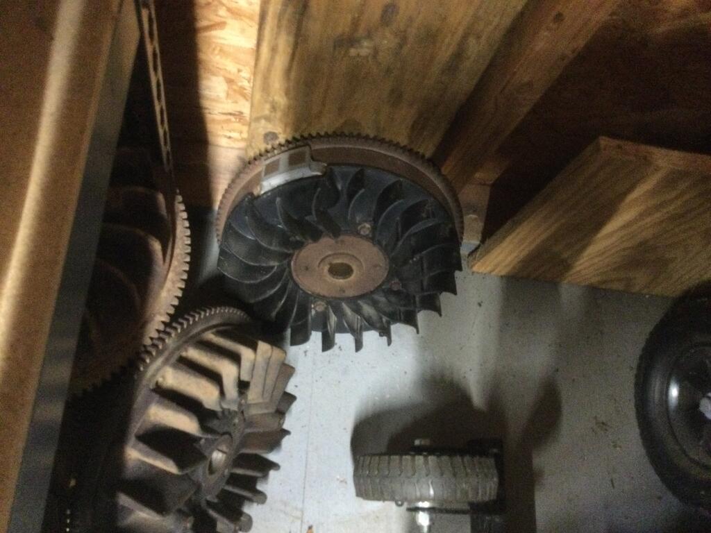

richmondred01 2,393 #57 Posted January 9, 2022 (edited) 12 minutes ago, oliver2-44 said: @DeepH2O Thats a very unusual Flywheel, it doesn’t have any cooling fins on it. Definitely not the original flywheel or possible not original motor. Does the motor flywheel tin have a decal with a serial number and spec number on it? @richmondred01 don’t you think that motor would run hot without flywheel fins on it? it has plastic fins. I’ll send a photo. Edited January 9, 2022 by richmondred01 Share this post Link to post Share on other sites
richmondred01 2,393 #58 Posted January 9, 2022 Photo Share this post Link to post Share on other sites
DeepH2O 66 #59 Posted January 9, 2022 29 minutes ago, oliver2-44 said: @DeepH2O Thats a very unusual Flywheel, it doesn’t have any cooling fins on it. Definitely not the original flywheel or possible not original motor. Does the motor flywheel tin have a decal with a serial number and spec number on it? @richmondred01 @pfrederi don’t you think that motor would run hot without flywheel fins on it? Edit: My bad. I forgot this was a Kohler Magnum. Yep, I removed the plastic fins prior to this. Share this post Link to post Share on other sites
