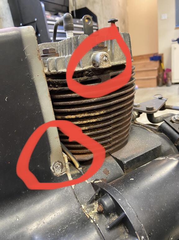

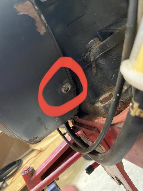

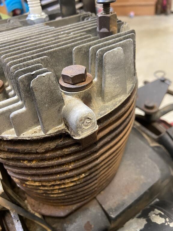

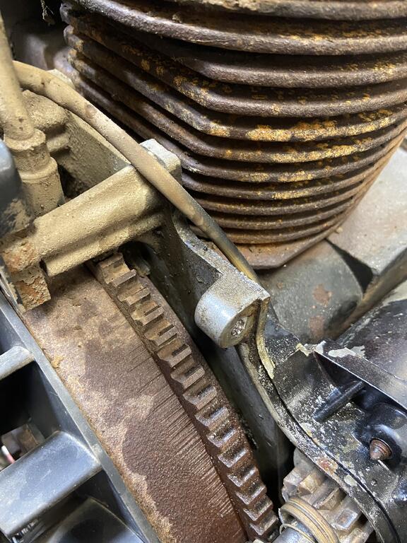

In process of restoring my 312-8. Aghhhhh!! Ran into my first headache!! Was going to remove the engine covers for painting. I tried 2 the other day. BOTH heads broke off, leaving the rest of bolt in the block! I tried drilling out and removing with bolt extractor. Couldn’t get it to budge. I applied some heat to it and the darn bolt extractor broke off in the bolt. I know it’s harder steel than the bit! Well, to add insult to injury, my dumb butt attempted a 3rd bolt after heating it up. It BROKE!! Now, the cover is partially loose. I’m stumped now!

The previous owner tighten the heck out of it.
It is to late now, but a tip. First tighten the bolt a hair, before unscrewing. It sounds backwards but helped me out a numerous occasions.

Those bolts are steel and are threaded into aluminum resulting in "Galvanic Corrosion".  The best procedure I have found is to begin by tightening the bolt a bit first then begin to remove it.

You can buy another head and bearing plate.

If you are taking the head and bearing plate off, they will be much easier to deal with. I have done the same thing, and have tapped some out to 5/16.

Yep, I suspect most of us have broken some of those same engine bolts off. On the remaining bolt you might heat the bolt head up with a brazing torch tip, then let it cool.  Soak it with you favorite penetrating oil several times over a days time. Then as others have said tighten then loosen just a little, tighten a little a little, loosen and repeat. When you reassemble be sure to use some anti-seize compound , especially on those steel in aluminum bolts.

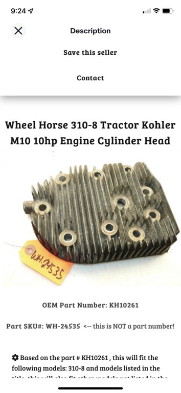

Do you guys know if there’s a difference in size of cylinder head on 10 & 12 HP Kohlers? I found one on EBay but it’s labeled part number KH10261 and advertises it’s for a 310-8. But, part number for 310-8 is KH10260 (10HP). I’m assuming since there’s different part numbers they’re different sizes.

If you have access to a welder, set a 5/16 or 3/8” nut over top of the broken parts.  Run the temp high and feed slow.  Fill the hole in and the weld wire will only stick to the steel parts.  It should turn out once cooled.  You can even use that heat cycle to quench the threads with some wax or oil.  It’ll pull it down deep into the threads.

Either use a nut, or use a small wrench "using the round end" and fill the end of the wrench, holding the welding rod further away then normal to build up in the wrench.
Bolt should turn.
I used this method in the past (and there are videos of it online)... works very well if you have access to a welder! :banana-dance:

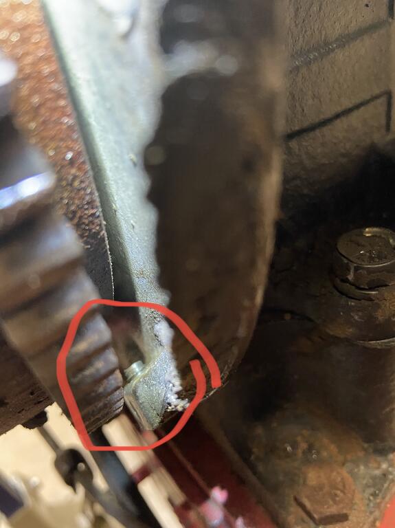

OK, heres a thought on the fan shroud --- IIRC the nut is tack welded to the back side of the shroud, you might be able to use , say, a Dremel/diegrinder and cut the tack weld at the tack points removing the nut, clean it up and JB weld another nut to the shroud --- JB weld epoxy is some good stuff!!
No nut tack welded. BUT, one of them has some threads on back side that I can possibly work with. Would have to remove fan and flywheel. Do you guys think I’ll open up a bigger can of worms? Should I just leave it be?
