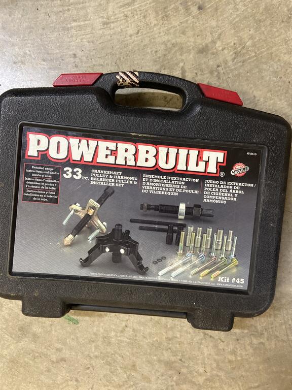

DeepH2O 66 #39 Posted January 7, 2022 Ok, so do you guys see in issue with my setup here, for trying to get flywheel off? Am I correct by assuming the only thing holding it on is 1 bolt in the center? 2 Share this post Link to post Share on other sites
DeepH2O 66 #40 Posted January 7, 2022 Found some other posts. I need to re-install center bolt most of the way, and then apply pressure to center bolt to keep from damaging threads and to keep from falling off if it decides to come off quickly. 1 Share this post Link to post Share on other sites
Jeff-C175 7,211 #41 Posted January 7, 2022 11 minutes ago, DeepH2O said: re-install center bolt Does the pointy thing on the screw of your puller come off? Some do and you then have a flat to push on the bolt head. If yours doesn't, you might consider punching a center punch as close to the center of the bolt head as possible to prevent it from 'walking' off center. 1 Share this post Link to post Share on other sites
oliver2-44 11,758 #42 Posted January 7, 2022 (edited) Just so your aware the aluminum plate behind the flywheel has the charging stator bolted to it with 4 little screws. They may be rust welded in place like the others. If I’m remembering correctly the stator has to come off to get to the plate puller holes. Sometimes you can wiggle the plate off without using a puller. That aluminum plate is also the crankshaft bearing retainer for that side of the engine. It has paper gasket shins under it to set the crankshaft side clearance. To reassemble you will need to pull the oil pan to feeler gage side clearance. This can take a couple of tries. Do you have a Kohler engine Manuel? If there is an old welding and farm repair shop in your area you might want to take it by them and see if they can get the bolts out before you go that deep in the engine. Also the flywheel is bolted on to a taper. You want to put tension on you puller then smack the puller center bolt with a hammer. You usually cannot pull the flywheel with just cranking on the center bolt. Put that center bolt back in place because it usually jumps off when you smack it Edited January 7, 2022 by oliver2-44 3 Share this post Link to post Share on other sites

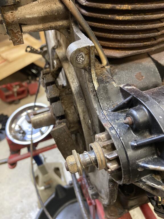

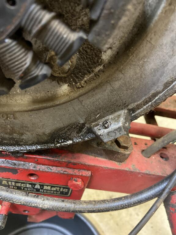

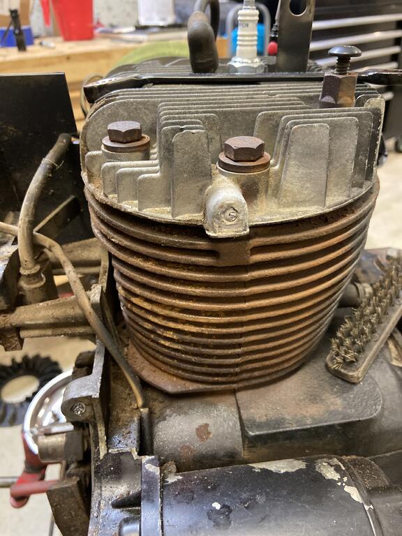

DeepH2O 66 #45 Posted January 7, 2022 8 hours ago, Gregor said: I think once you get your bearing plate off, the broken bolts can be dealt with. If the one with the broken tap NEVER comes out, there are options. Wish we had good pics of the broken bolts and locations Here they are. I got the flywheel off and access to the back of one of them. Still no luck! She’s in there. I lubricated good, applied heat, and got a good bite with chisel. Still didn’t wink. I’m not even sure welding nut will get it. So, there’s 2 covers that these 3 go to. The one in top head, I have a new head coming. That one is good. The other 2, not so sure. Share this post Link to post Share on other sites
Gregor 4,848 #46 Posted January 7, 2022 I think the head bolt would come out,l but you need to center tap and drill it pretty close. Even if you had to drill and tap it to 5/16. I am assuming the top bolt has the easy out broke off in it, but I cant really tell. Any decent machine shop could get both of them out I think. Re- tap to 5/16. If that fails cut the bosses off, cut new pieces of aluminum, (any shape) and have them welded back on. Drill and tap new holes while the cover is in place. Or send the bearing plate and head to me, and I will fix them. No charge. 6 Share this post Link to post Share on other sites
pfrederi 21,175 #47 Posted January 8, 2022 Other than the one with the broken "not so easy out" get a helicoil set and re-do them. i must 6-10 of these in my tractors Share this post Link to post Share on other sites
953 nut 69,550 #48 Posted January 8, 2022 If you heat the broken easy out to red hot it will not be hardened an longer and can be drilled out. 1 1 Share this post Link to post Share on other sites
