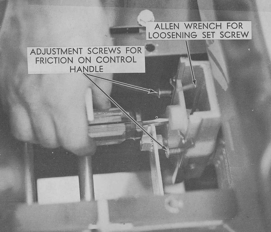

rmaynard 17,575 #13 Posted January 3, 2022 (edited) I'm with @Pullstart on this one. Sounds like you got the governor out of whack. Not a big problem if you follow the instructions to the letter on properly adjusting it. Your problem with the hydro could be as simple as a bad adjustment of the friction control. or maybe the nylon parts are cracked or broken. Edited January 3, 2022 by rmaynard 1 Share this post Link to post Share on other sites
