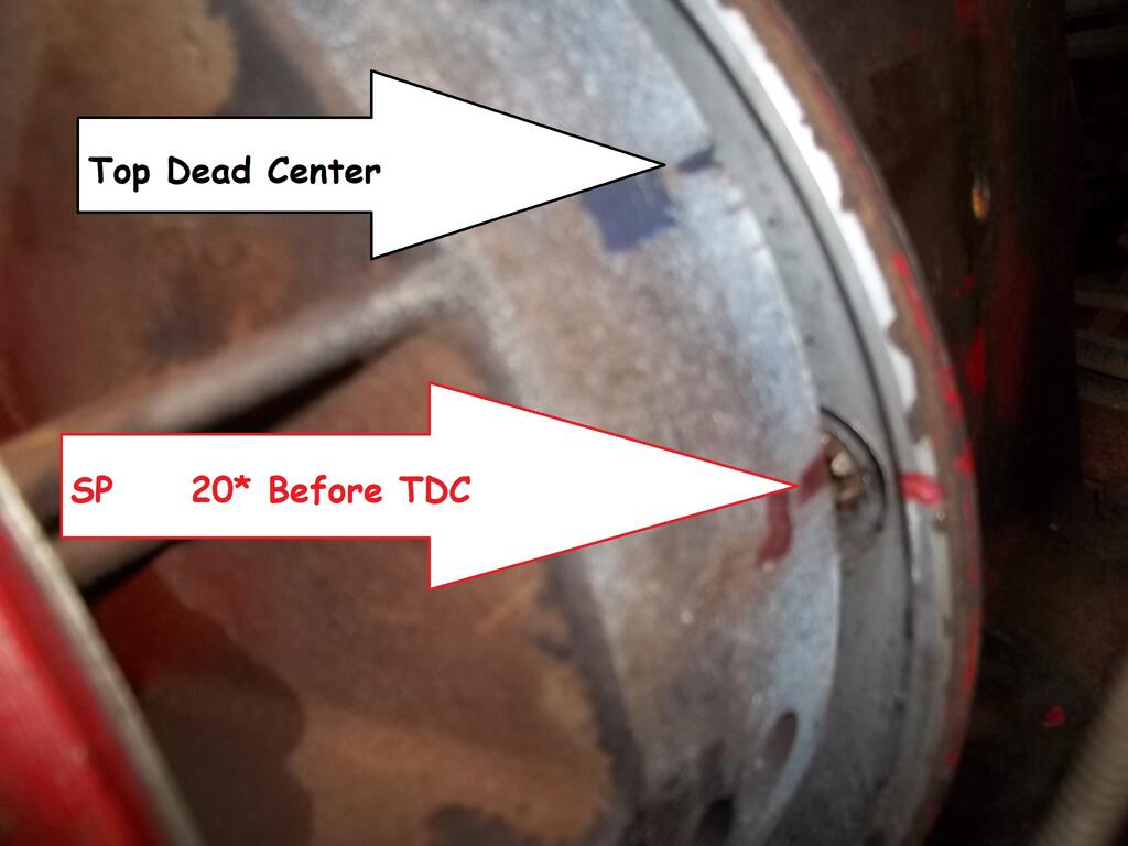

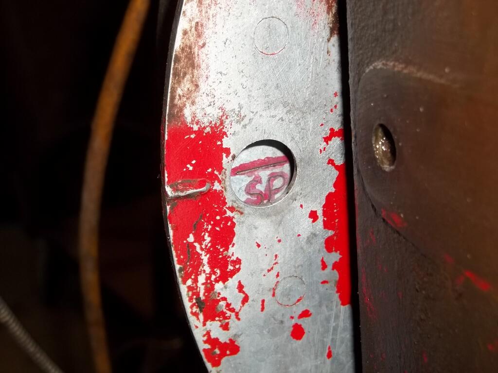

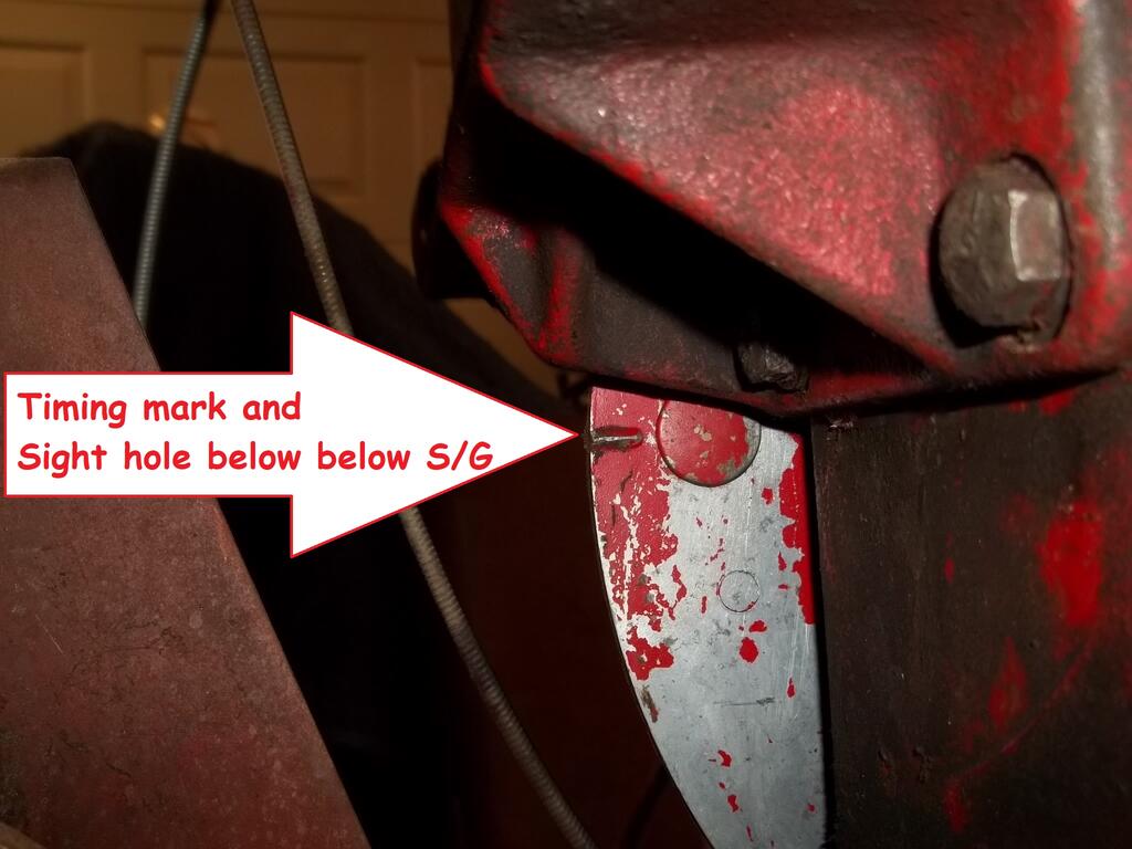

953 nut 69,544 #54 Posted January 11, 2022 10 hours ago, pfrederi said: Don't ask why but the sight hole is on the rear of the shroud for S/G..There should be a corresponding mark on the rear of the bearing plate. That would be true if this engine was pre - 1968 equipped with a S/G when built. Share this post Link to post Share on other sites

BHunter 1,702 #57 Posted January 11, 2022 52 minutes ago, 953 nut said: That would be true if this engine was pre - 1968 equipped with a S/G when built. I just looked at my 877 s/g and that doesn’t have a sight hole either. Do I need to pull the head so I can see TDC and put a mark on the flywheel? Or can i put my finger in the spark plug hole and turn engine like I do with my hot rods? Share this post Link to post Share on other sites

Gregor 4,848 #60 Posted January 11, 2022 (edited) 7 hours ago, BHunter said: Do I need to pull the head so I can see TDC and put a mark on the flywheel? When the key way on the flywheel is pointing straight up, the piston id at TDC. I think this was mentioned earlier, but I can't find it Edited January 11, 2022 by Gregor 1 Share this post Link to post Share on other sites
953 nut 69,544 #61 Posted January 11, 2022 11 hours ago, BHunter said: I just looked at my 877 s/g and that doesn’t have a sight hole either. Like Paul @pfrederi said, look under the S/G bracket on the engine bearing plate, the marks are on the flywheel. Probably not too easy to see without sanding the rust off the flywheel. 11 hours ago, BHunter said: Do I need to pull the head so I can see TDC Keyway at the top is TDC, covered this about 20 posts beck. 2 1 Share this post Link to post Share on other sites
WHX?? 58,214 #62 Posted January 11, 2022 (edited) 12 hours ago, gwest_ca said: I now wonder if Kohler was supplying the K301 as a service replacement for the K241 Interesting ... Any sign if the motor was ever painted grey Bob? Yes Richard all my SG tractors the sight hole is on the bearing plate not the shroud. I never use them tho all mine run good with points @ 20 ... K91's like to favor more towards 18 thou. Edited January 11, 2022 by WHX?? 1 Share this post Link to post Share on other sites
pfrederi 21,172 #63 Posted January 11, 2022 (edited) 2 minutes ago, WHX?? said: Interesting ... Any sign if the motor was ever painted grey Bob? Yes Richard all my SG tractors the sight hole is on the bearing plate not the shroud. But this wasn't a S/G engine it was a rope start Who knows .... Edited January 11, 2022 by pfrederi Share this post Link to post Share on other sites

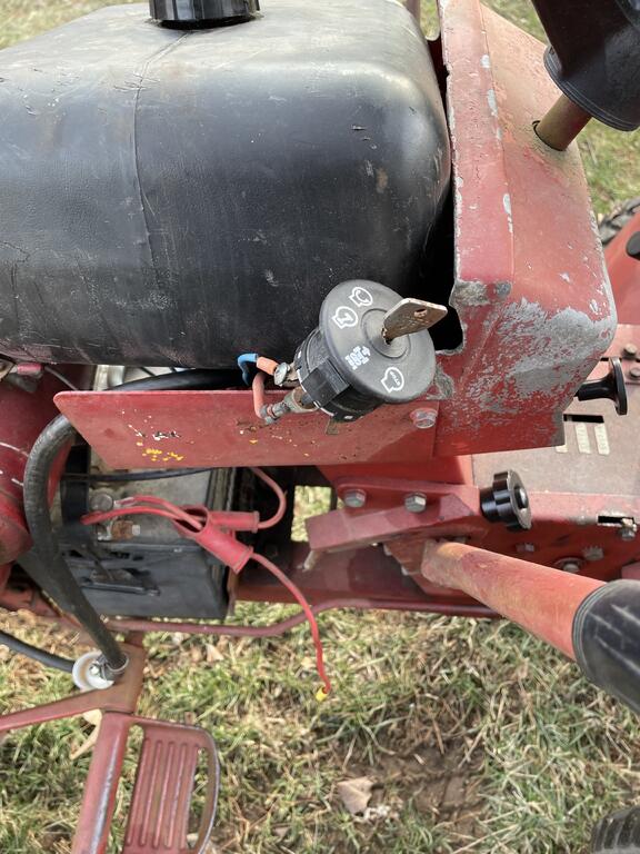

BHunter 1,702 #69 Posted January 13, 2022 I decided it’s running well the way it is so I'm going to leave the magneto in it for now. I’m wondering what type of ignition switch I need for this set up? Can I still use the original 1077 switch with the magneto?. There isn’t a wire going to the M tab on this switch. I want to get rid of this giant switch and put one in the dash Share this post Link to post Share on other sites
953 nut 69,544 #70 Posted January 13, 2022 2 hours ago, BHunter said: Can I still use the original 1077 switch with the magneto?. There isn’t a wire going to the M tab on this switch. Seem to recall you (or somebody) saying there was a kill switch on this tractor. Share this post Link to post Share on other sites
BHunter 1,702 #71 Posted January 14, 2022 11 minutes ago, 953 nut said: Seem to recall you (or somebody) saying there was a kill switch on this tractor. There is but I disconnected it. I used the button on the points cover to shut it off today. 1 Share this post Link to post Share on other sites

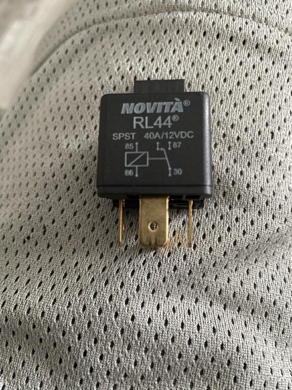

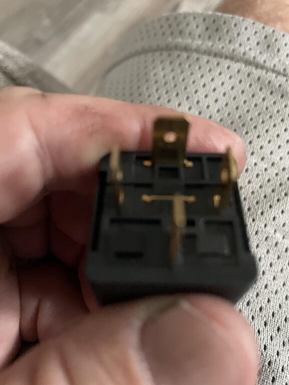

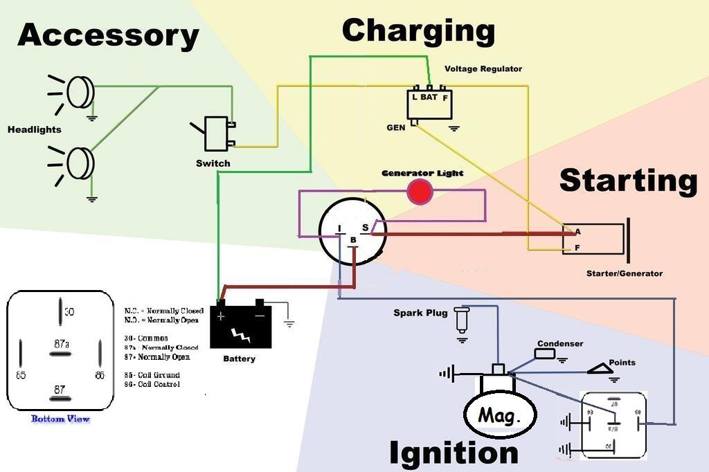

953 nut 69,544 #73 Posted January 14, 2022 You can use the three terminal ( B I S ) switch by adding a kill relay. When the switch is placed in I or S the wire from I will have 12 volts applied. This wire will go to the #85 terminal of the relay, flow through the coil of the relay to terminal #86 which is grounded. The current flowing through coil will activate the relay and open the normally closed (NC) #87a to # 30 which will allow the Magneto to produce high voltage ignition pulses as the points open. When the ignition is turned off the coil will no longer be magnetizing the relay and #87a and # 30 will close applying a ground to the magneto stopping the engine. Terminal # 87 is not used. 1 Share this post Link to post Share on other sites

BHunter 1,702 #75 Posted September 12, 2022 On 1/13/2022 at 7:52 PM, 953 nut said: You can use the three terminal ( B I S ) switch by adding a kill relay. When the switch is placed in I or S the wire from I will have 12 volts applied. This wire will go to the #85 terminal of the relay, flow through the coil of the relay to terminal #86 which is grounded. The current flowing through coil will activate the relay and open the normally closed (NC) #87a to # 30 which will allow the Magneto to produce high voltage ignition pulses as the points open. When the ignition is turned off the coil will no longer be magnetizing the relay and #87a and # 30 will close applying a ground to the magneto stopping the engine. Terminal # 87 is not used. Hi Richard. Would I be able to use this 4 prong relay? The parts store didn’t have a 5 prong . 87a does not have a prong on this one. The 1077 has been starting fine until now. I left the wiring alone that the PO had on it. Now it starts randomly. The s/g turns the motor over when I put a jumper on the A terminal. I wonder if the magneto is starting to go. I just installed a new (BIS) switch and I want to wire it like your diagram. Share this post Link to post Share on other sites
