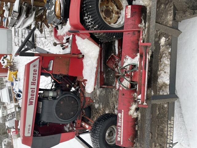

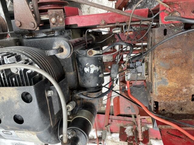

AHS 1,701 #1 Posted December 31, 2021 Ok, ID # 2110k801 11589. What years is that? I’m searching for a wiring diagram. The wiring is all messed up, disconnected from the key and the solenoid. The voltage regulator is missing. Where is that supposed to go? I got the tractor, a 48” snowplow, a grader blade and a 36” deck for $350… I guess I paid what it was worth. 1 Share this post Link to post Share on other sites

pfrederi 21,175 #4 Posted December 31, 2021 No voltage regulator WH went cheap has a 3 amp unregulated system AC headlights work only when engine is running. 3 Share this post Link to post Share on other sites

AHS 1,701 #6 Posted December 31, 2021 1 hour ago, pfrederi said: No voltage regulator WH went cheap has a 3 amp unregulated system AC headlights work only when engine is running. Ok, weird! Is it in the engine? Is in around the flywheel? Share this post Link to post Share on other sites
pfrederi 21,175 #7 Posted December 31, 2021 All runs off the stator one leg has a diode to convert Stator AC to DC it feeds the battery via ignition switch. The other leg AC goes to the headlights. Voltage varies some based on engine RPM you will see the light get dimmer at idle and stop when you turn it off 3 Share this post Link to post Share on other sites

Gregor 4,848 #12 Posted January 1, 2022 12 hours ago, AHS said: Ok, weird! Is it in the engine? Is in around the flywheel? He's saying there is no VR. Isn't suppose to be. 1 Share this post Link to post Share on other sites
wallfish 20,637 #13 Posted January 1, 2022 14 hours ago, AHS said: has a 3 amp unregulated system Yes, it's under the flywheel 2 Share this post Link to post Share on other sites

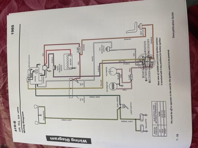

AHS 1,701 #14 Posted January 1, 2022 14 hours ago, pfrederi said: All runs off the stator one leg has a diode to convert Stator AC to DC it feeds the battery via ignition switch. The other leg AC goes to the headlights. Voltage varies some based on engine RPM you will see the light get dimmer at idle and stop when you turn it off Kinda different ball of wax.. is this the one? Share this post Link to post Share on other sites
Gregor 4,848 #15 Posted January 1, 2022 That was giving me a headache. That little gizmo in the red circle is the diode @pfrederimentioned in the post above. It will appear a just a small bump in one of the 2 wires coming from the stator. Chances are, the diode will not be under the flywheel. 1 Share this post Link to post Share on other sites
AHS 1,701 #16 Posted January 2, 2022 @Gregor Yes! A saw that diode, I will feel for a small bump. This seems like a challenge ( which I’m up for!😀). The VR is in the engine, so what’s coming from those wires (outside the motor) are DC? Share this post Link to post Share on other sites
Gregor 4,848 #17 Posted January 2, 2022 There is NO VR. The stator is under the flywheel. The wires coming from the stator are AC voltage. What exactly are you trying to do? Share this post Link to post Share on other sites
AHS 1,701 #18 Posted January 2, 2022 1 minute ago, Gregor said: There is NO VR. The stator is under the flywheel. The wires coming from the stator are AC voltage. What exactly are you trying to do? Ok, I’m trying to wrap my head around this… so the headlights are AC? Share this post Link to post Share on other sites
953 nut 69,551 #19 Posted January 2, 2022 2 minutes ago, AHS said: so the headlights are AC? Yes, just like the lights in your house (except lower voltage). 1 Share this post Link to post Share on other sites
Gregor 4,848 #20 Posted January 2, 2022 (edited) Yes. They will get brighter and dimmer with engine RPM. The other wire, with the diode, DC voltage, goes to charging the battery. @953 nutis quicker than me. But I'm older. Edited January 2, 2022 by Gregor 1 Share this post Link to post Share on other sites
pfrederi 21,175 #21 Posted January 2, 2022 2 hours ago, Gregor said: Yes. They will get brighter and dimmer with engine RPM. The other wire, with the diode, DC voltage, goes to charging the battery. @953 nutis quicker than me. But I'm older. as i said in post #7 1 Share this post Link to post Share on other sites
AHS 1,701 #22 Posted January 2, 2022 Thank you guy so much for helping me! I think I’m gonna have to listen to AC/DC in the garage, since I’ll be playing with AC wires and DC wires!😂 How many volts are the headlights? I was thinking the headlights must be low amperage cause of the tiny wire! 1 Share this post Link to post Share on other sites
Gregor 4,848 #23 Posted January 2, 2022 1 minute ago, AHS said: Thank you guy so much for helping me! I think I’m gonna have to listen to AC/DC in the garage, since I’ll be playing with AC wires and DC wires!😂 How many volts are the headlights? I was thinking the headlights must be low amperage cause of the tiny wire! On 12/31/2021 at 1:23 PM, pfrederi said: 3 amp unregulated system I assume they are 12 V bulbs, but someone else would have to verify that. You're getting above my pay grade on this one. 1 Share this post Link to post Share on other sites
pfrederi 21,175 #24 Posted January 2, 2022 They are the same bulbs used in other WHs about 35 watt I believe. 12 volt bulbs however the voltage they are fed goes up and down some based on engine speed.. You cannot directly replace them with LEDS (they want DC current) you have to rewire and feed LEDS from the battery or Acc terminal. You may experience flickering. 2 Share this post Link to post Share on other sites
