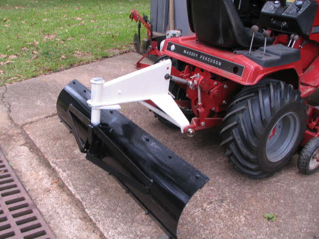

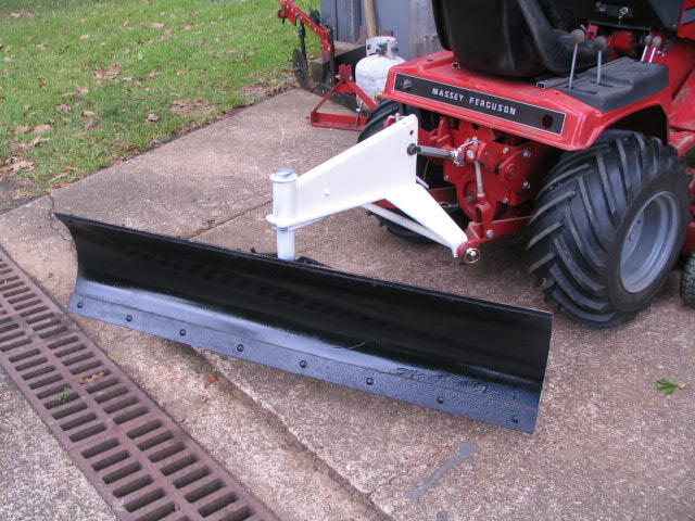

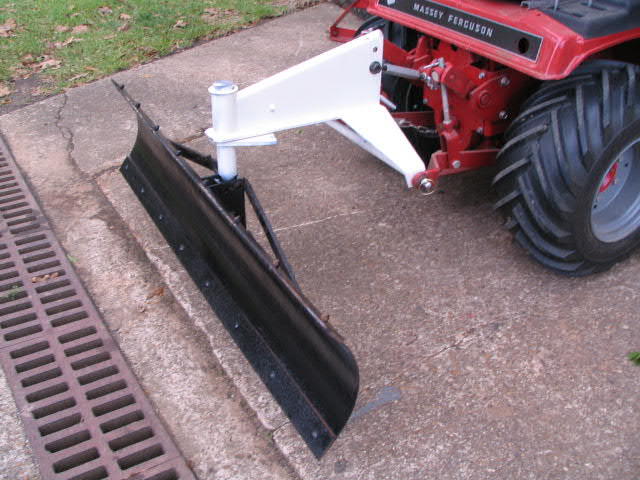

Southern_Secret 464 #2 Posted December 23, 2021 This is @Lee1977 blade and it is pretty close to how i want to make mine. 2 Share this post Link to post Share on other sites

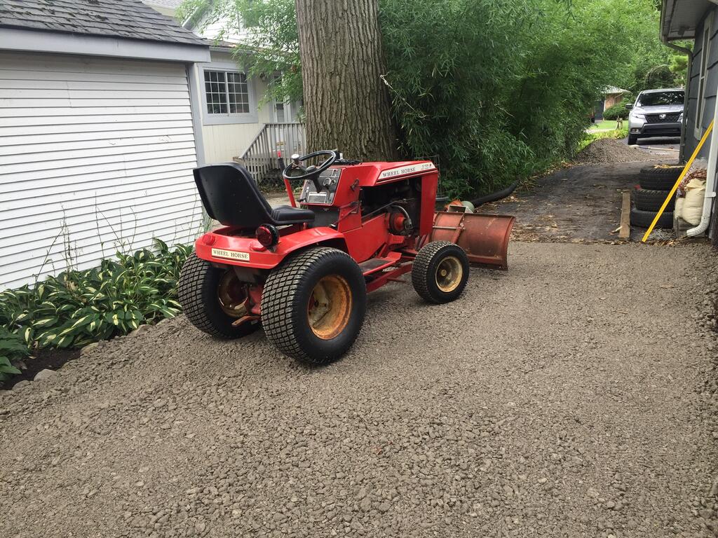

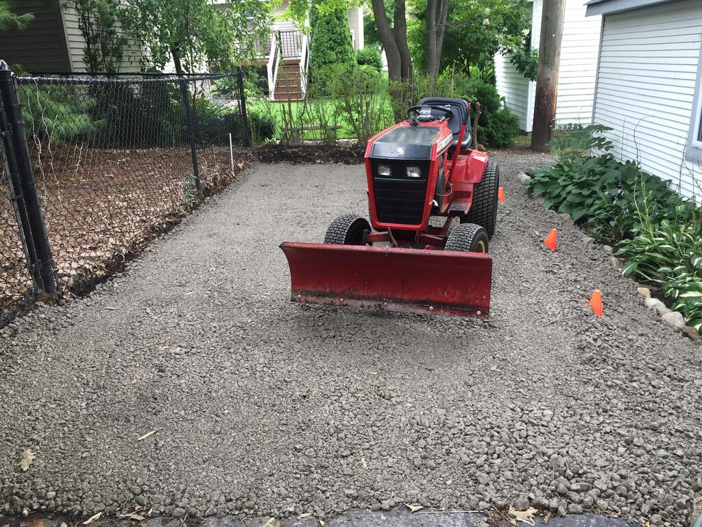

ebinmaine 80,935 #4 Posted December 23, 2021 PULL Use a PULL type. You'd be happy with a PULL type grader. Trina uses a pull type grader on her 867 to keep our driveway level and straight. A push type grader can dig in more than desired very quickly on unlevel or uneven ground. I think this is the first time she used it... 3 1 1 Share this post Link to post Share on other sites
