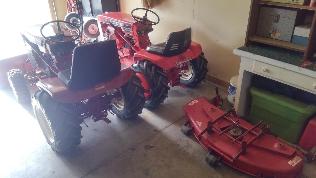

Oldskool 6,678 #51 Posted January 25, 2022 (edited) One in the works. Here is my little herd. Edited January 25, 2022 by Oldskool 2 7 1 Share this post Link to post Share on other sites

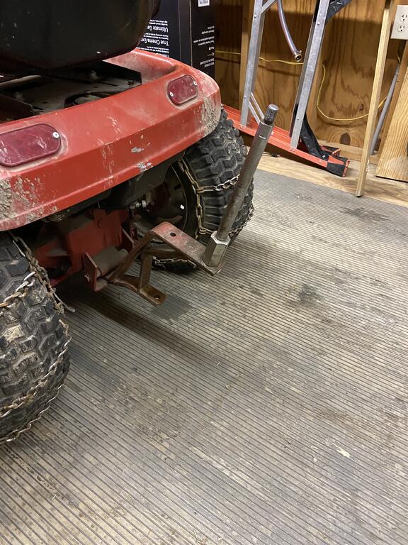

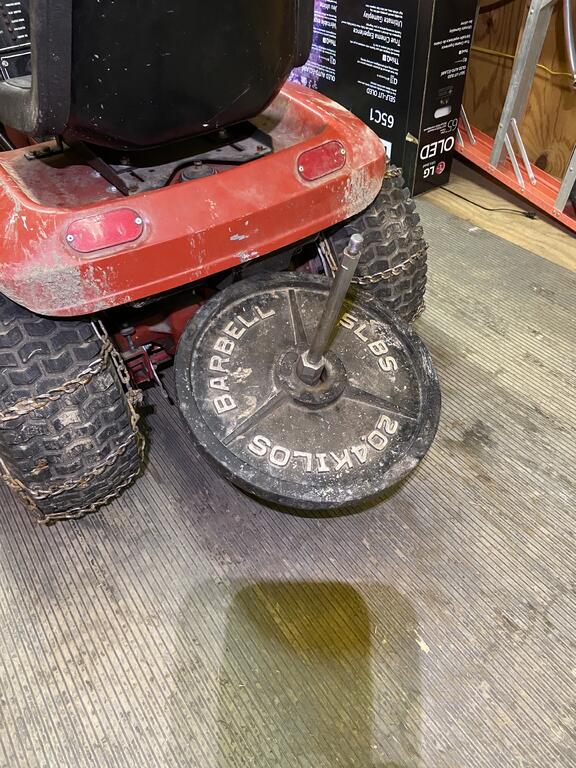

Fishroe 261 #54 Posted January 27, 2022 Not as pretty as a lot of tractors on here but I like it and it gets the job done I do want to thank the folks here for all the info I’ve gotten in the past and in the future when I start doing other things to it. I do have rear wheel weights but someone did some welding on the hitch and I had a shaft and barbell weights. Just a little bit on the shade tree side. Lol Was wondering how much weight does the rear hitch support 3 Share this post Link to post Share on other sites
ebinmaine 80,649 #55 Posted January 27, 2022 3 minutes ago, Fishroe said: wondering how much weight does the rear hitch support Not sure I've ever seen a standard. Seems like I've seen 150 lbs mentioned. We've had 200+ lbs tongue weight without issue. 1 Share this post Link to post Share on other sites
kpinnc 18,940 #56 Posted January 27, 2022 1 hour ago, ebinmaine said: wondering how much weight does the rear hitch support How much isn't the issue in my mind, but rather how hard it drops onto the hitch. I've seen two busted cases because someone dropped a heavy hitch onto the drawbar. If you're gonna carry significant weight back there, I'd weld a larger "foot" onto the part that wedges against the underside of the case to spread out the load. Just my unwarranted opinion ... 4 Share this post Link to post Share on other sites

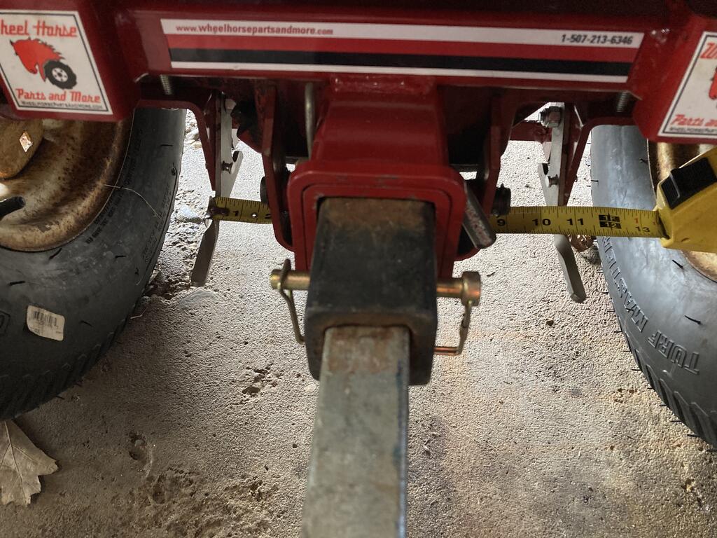

SylvanLakeWH 32,464 #57 Posted January 27, 2022 (edited) Or, go with one of Lowell’s 2” receiver hitches… way stronger… vendor section: wheelhorsepartsandmore Edited January 27, 2022 by SylvanLakeWH 4 Share this post Link to post Share on other sites
Southern_Secret 464 #59 Posted January 27, 2022 1 hour ago, SylvanLakeWH said: Or, go with one of Lowell’s 2” receiver hitches… way stronger… vendor section: wheelhorsepartsandmore 2 Share this post Link to post Share on other sites
Fishroe 261 #60 Posted January 27, 2022 That’s a nice looking hitch I have the wheel horse rear weights (not sure how much they weigh) 1 Share this post Link to post Share on other sites
