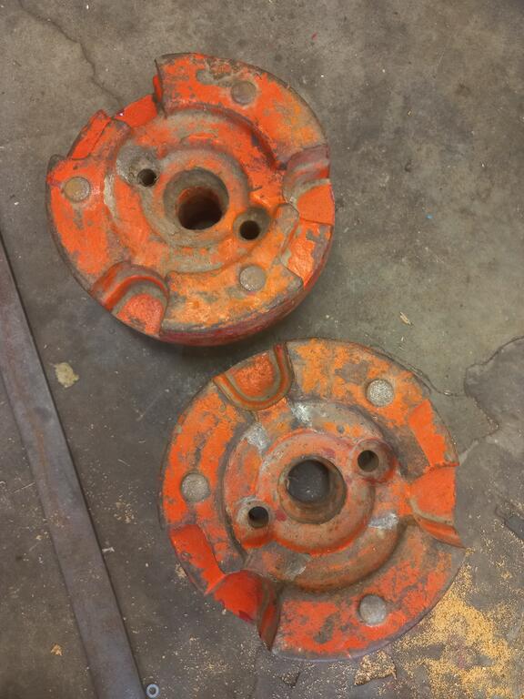

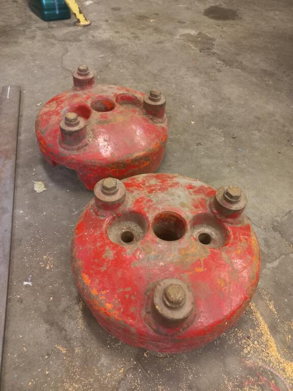

Wheelweights acquired, 20kg/44lbs each.
Now to figure out an easy way to attach them.

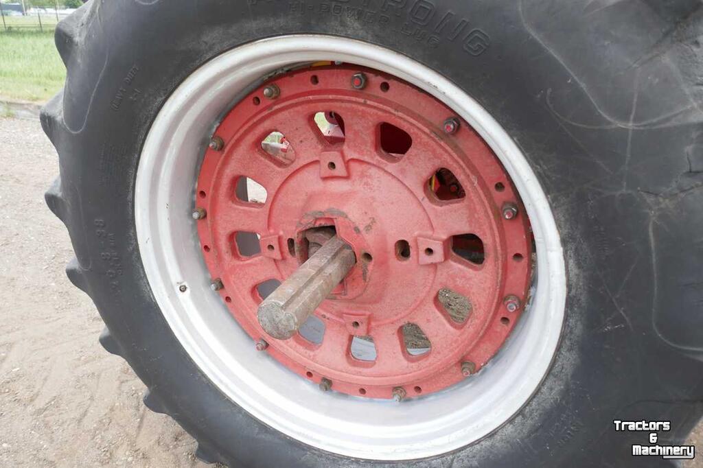

Still I think i'm going to go with wheels which are already the right width and make my own center-section. That way I can mimic the original International wheel plates to make them look even better than what I now have.

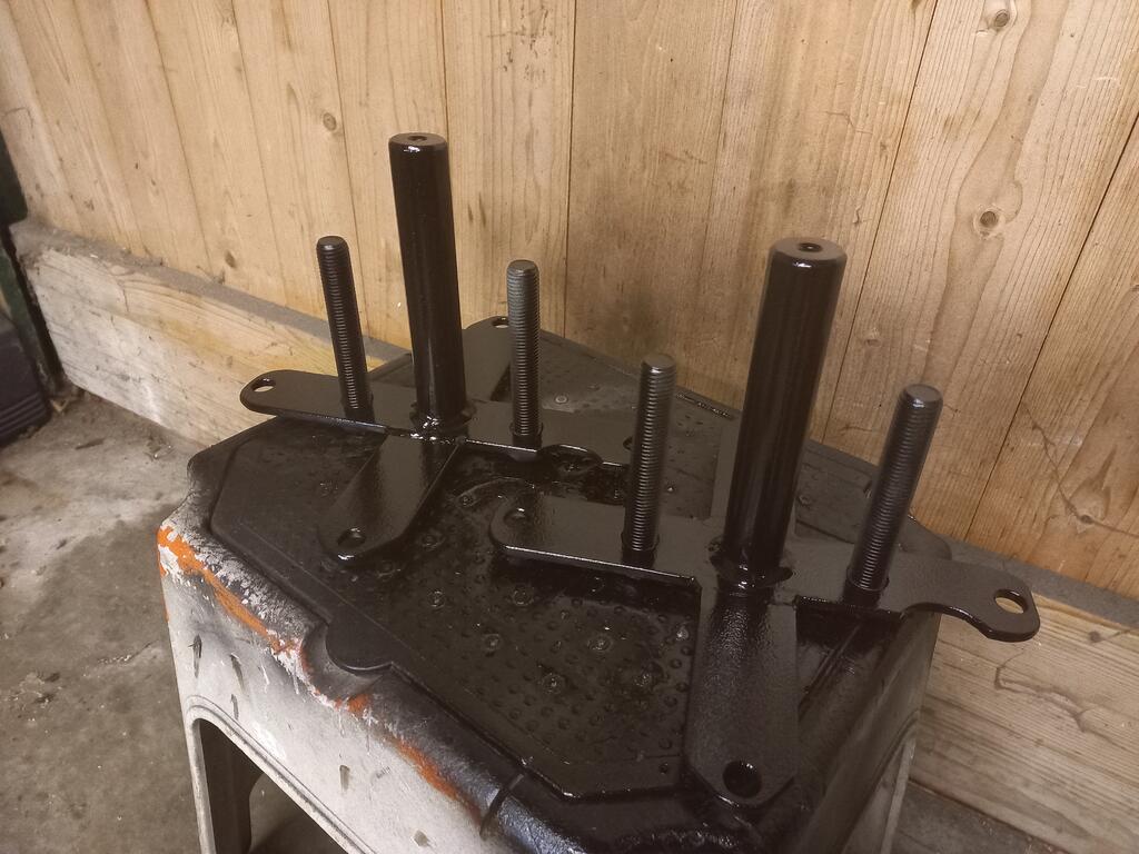

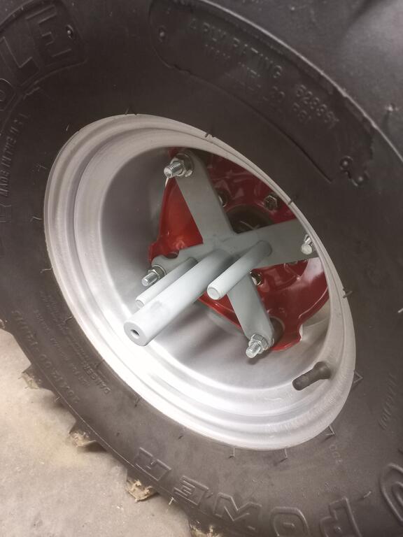

Made a cross with spacer bushings to clear the hub. Also made some plastic washers to (hopefully) save the red paint of the rim.
Two M16 bolts to bolt the weight to. The center tube doubles as a guide I can stick the weight on, then slide it back over the bolts. Also makes it look like it now has long axles which is a look I think makes it look 'American'.
Ofcourse the grey is only zinc-primer, painted the crosses shiny black.
I'll have to do some work on the weights themselves. I want to mount them what can be considered backwards because I think that looks better. Since the weights were not designed to be mounted that way I have to make some room for a nut and socket so I can tighten them properly.

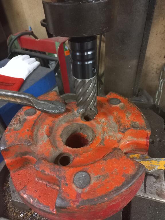

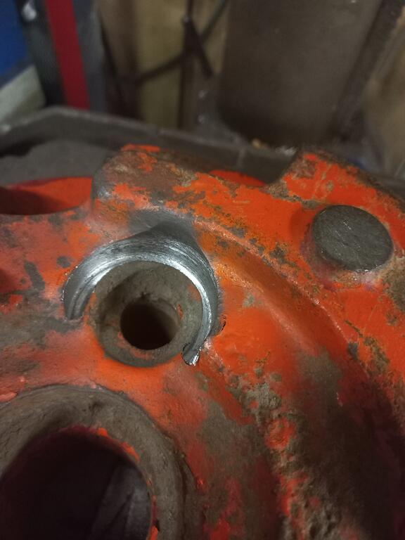

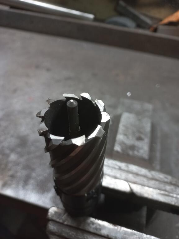

Soo.. worked on the wheel weights a bit today. The plan was to use an angular cutter to widen the holes where the nuts mount to make room for a socket. The angular cutter needed re-sharpening so delivered that to the sharpener yesterday and picked it up this morning.
Went home in good spirit and tried it out..
FAIL! This is how much I got done before the cutter was dull again.. $20 down the drain for nothing :eusa-doh:
Plan A was use a die grinder and carbide bit but that went a little slow so I opted for plan B: the angular cutter.. seems it's back to plan A unfortunately.
  • Sad 4
How hard is the weight?  What about an counterbore drill bit?
SylvanLakeWH
:text-yeahthat:
Or maybe a step drill bit?
sjoemie himself
Well the hole i'm trying to drill is 38mm/1.5".
Do you know if those bits are available in that size? Bit pricey also probably?
Step drill will not touch the material, way to hard.

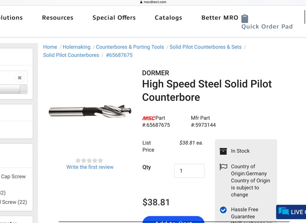

Counter bores are used in die making and solid steel work.  They are measured based on the bolt size, and give space for the bolt head and tool.  Generally an Allen bolt is used with them.
Edited by Pullstart
Jeff-C175
27 minutes ago, sjoemie himself said:
way to hard.
Maybe heat up to kill the temper?
sjoemie himself
@Pullstart yep I know those. Looking at it though the pilot diametre will be too short and it being HSS I think it will have the same issue as the annular cutter. Get dull fast.
The temper idea I unfortunately don't have the equipment for.

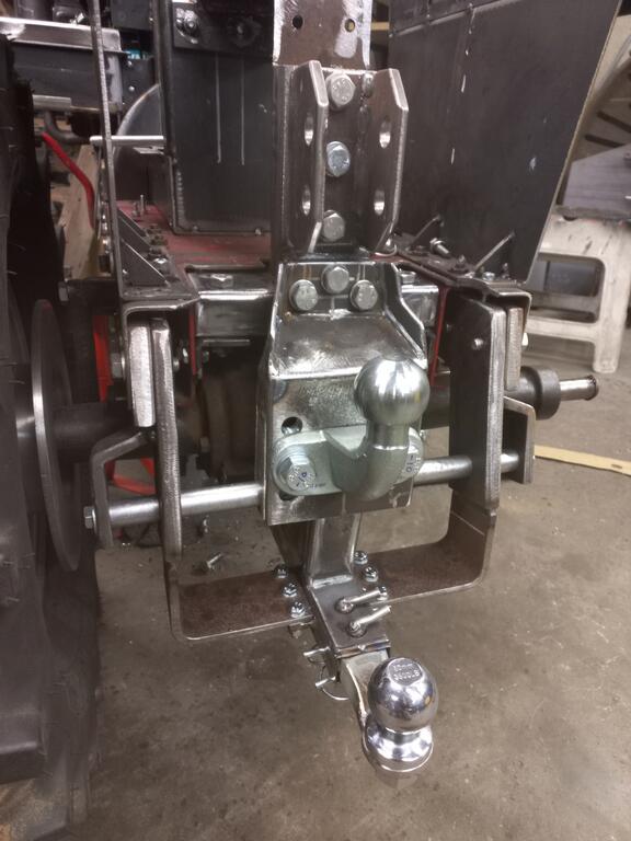

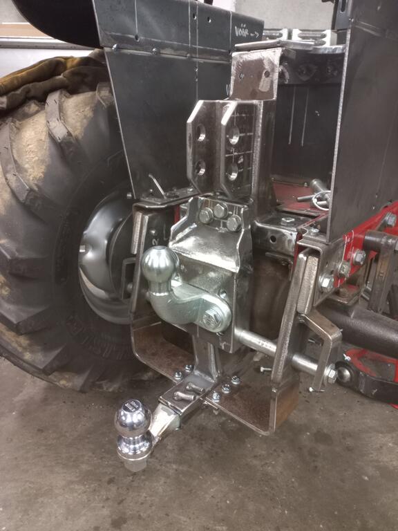

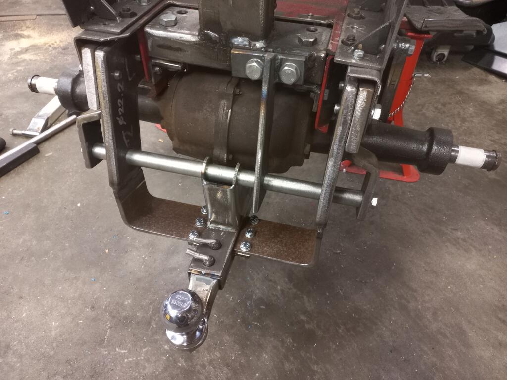

Little update, changed the ball hitch configuration. I'm hoping this will improve pulling power by transferring more pressure onto the rear wheels. Only one way to find out..
Before, low and long:
After, higher and stubby:
As you can see I now have 3 different heights to choose from, depending on the implement I'm dragging or what works best in terms of grip.
