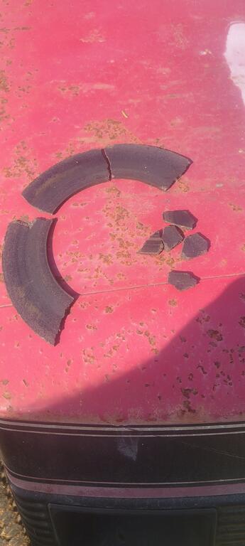

RED-Z06 2,718 #1 Posted December 15, 2021 Took the 416 out to mow and try out the new seat...mowed maybe 15 minutes, let off the PTO and bang...something hit my foot. 5 Share this post Link to post Share on other sites
oliver2-44 11,628 #2 Posted December 15, 2021 I recall reading one of the members makes and sells replacement PTO clutch material. I hope someone replies who that is as I need one too. There are some vendors that sell complete new plates with new clutch material on them. 1 Share this post Link to post Share on other sites
RED-Z06 2,718 #3 Posted December 15, 2021 21 minutes ago, oliver2-44 said: I recall reading one of the members makes and sells replacement PTO clutch material. I hope someone replies who that is as I need one too. There are some vendors that sell complete new plates with new clutch material on them. Thankfully i have had a like new spare hanging on a hook since 2005, im back up and going and good time to luve the pto bell. Easy 10 minute fix. 4 1 Share this post Link to post Share on other sites
RED-Z06 2,718 #4 Posted December 15, 2021 26 minutes ago, oliver2-44 said: I recall reading one of the members makes and sells replacement PTO clutch material. I hope someone replies who that is as I need one too. There are some vendors that sell complete new plates with new clutch material on them. New clutch 94-6650 about 58 bucks in the Jungle if you need to get back up and going 1 Share this post Link to post Share on other sites

kpinnc 18,744 #6 Posted December 15, 2021 I've seen a couple folks have 1/8 aluminium cut to replace the clutch material too. Not sure how I feel about it, but am told it works well. 1 Share this post Link to post Share on other sites
RED-Z06 2,718 #7 Posted December 15, 2021 3 minutes ago, peter lena said: @ RED -Z06 , did you take the time to lightly hi temp grease the related needle bearing the pto cone? pete Yep 2 replies up. I rebuilt that cone in 06, new pilot, new needle, new seal...was not fun. Still looked good though, wiped the race off and nothing but some heat spots from when the original went out in 06. 1 1 Share this post Link to post Share on other sites
RED-Z06 2,718 #8 Posted December 15, 2021 1 minute ago, kpinnc said: I've seen a couple folks have 1/8 aluminium cut to replace the clutch material too. Not sure how I feel about it, but am told it works well. If i was confident in an epoxy or my riveting skills id experiment with stuff like 4 pucks cut from various materials. 1 Share this post Link to post Share on other sites
