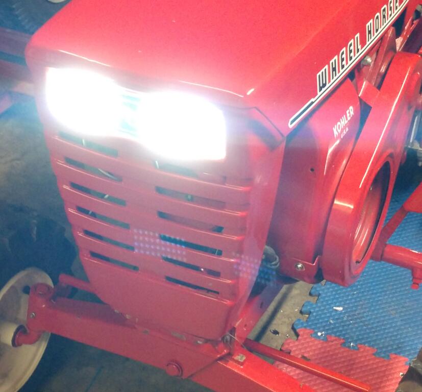

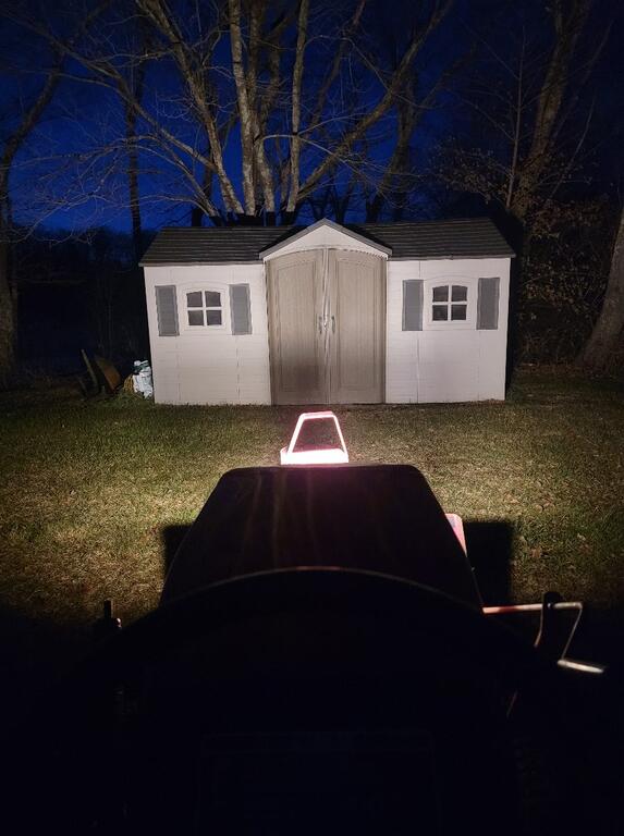

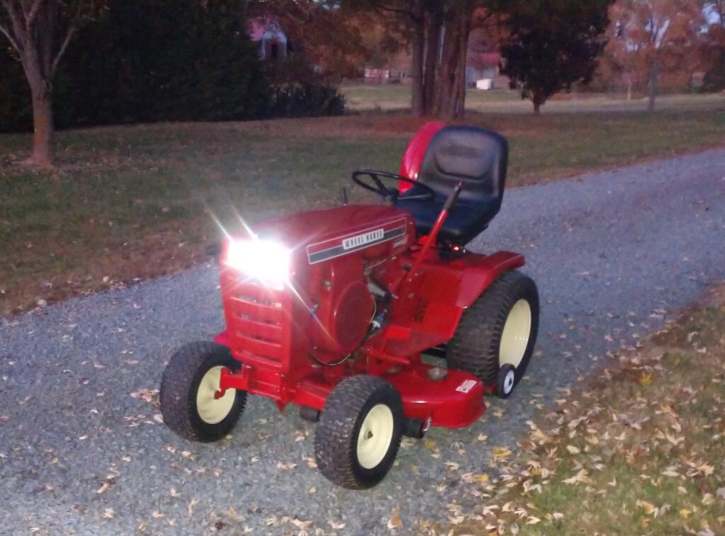

kpinnc 19,105 #1 Posted December 9, 2021 (edited) In the past few years, I've tried 4 different methods of LED light replacements. Let me say first that though some are better than others, ALL of them far exceed OEM light options so far as output is concerned. They also have very low power consumption, don't get hot, and are claimed to last thousands of hours. So far none of mine have needed replacement. There are some people who prefer incandescent traditional bulbs over LEDs, and I do not intend to try to sell them something new. We all have differing opinions, and that is the way it should be. There is also the argument for keeping these machines as close to original as possible. This thread is not intended to challenge any of those opinions. What this thread is intended to do, is offer some insight into what I've found in some testing for those of us who still work these machines, and look to improve where we can their capabilities. Make no mistake- LEDs greatly increase light output in front of your machine, and do so economically and safely. All of my tractors have one of two types of lights: the PAR 36 style on 300/400/500 series tractors, and the automotive turn signal type in most everything Wheel Horse manufactured between 1965 and 1984. This thread focuses mainly on those. I plan to do some comparison pictures and add to this thread. Some side by side comparisons will be added later as well. The PAR-36 versions are the simplest modification. You just replace the OEM lights with LEDs. If you go to SuperBrightLEDs.com and search "PAR 36", you'll find several options. The older style lights require some modifications. There are many options, and each requires different levels of modification. Remember that "warmer" colors below 4500 are more yellow like incandescent, and "cooler" above 5500 are whiter, and even lean into bluish colors above 6000. Combine this with lumen ratings (which are NOT standardized), and it can be confusing. To be honest, most any LEDs are brighter than traditional lights on these tractors, so I doubt this thread will help much there. There are more options than there are shoe sizes, and they vary between seller just as much. I'll be adding some mods that I have done as well in the next few days. Edited December 9, 2021 by kpinnc 7 9 Share this post Link to post Share on other sites

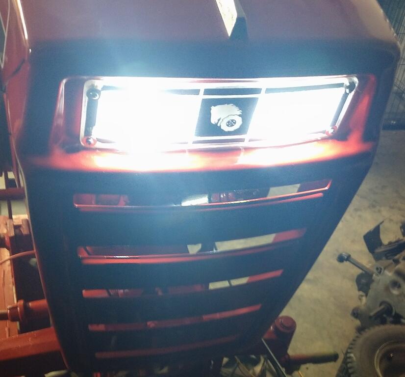

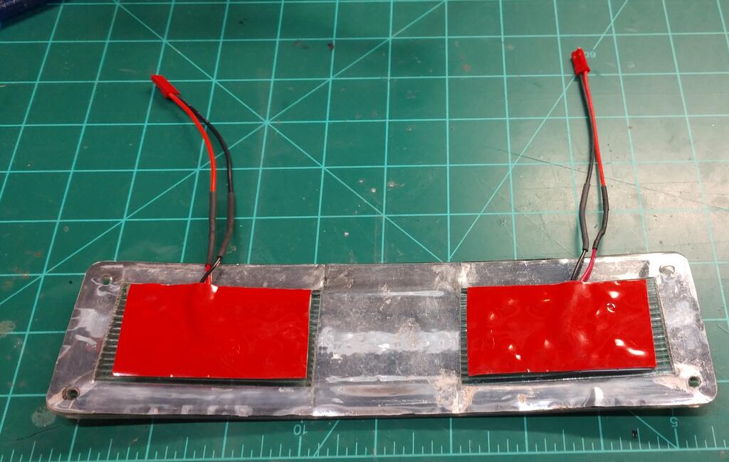

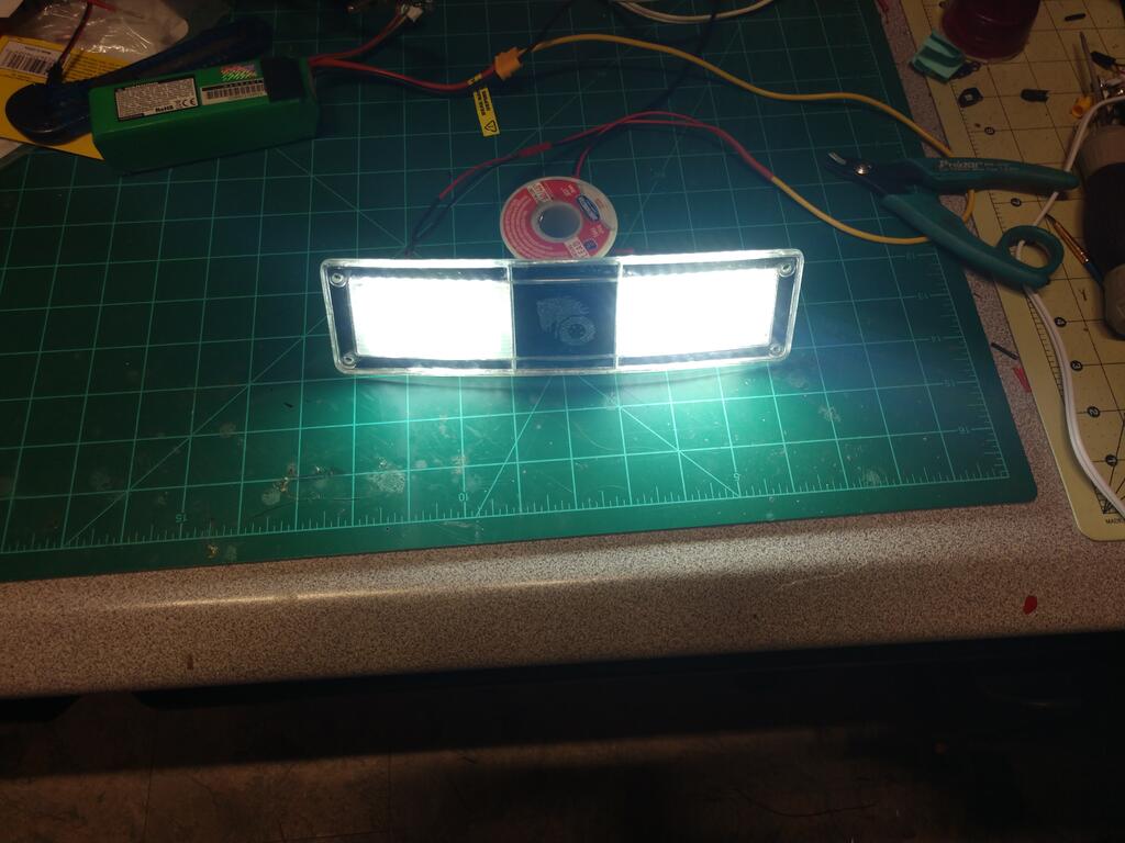

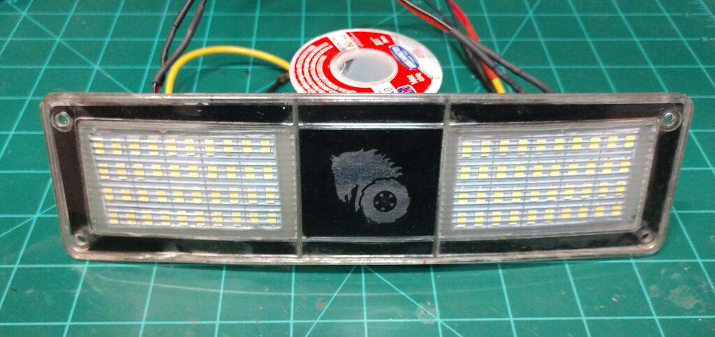

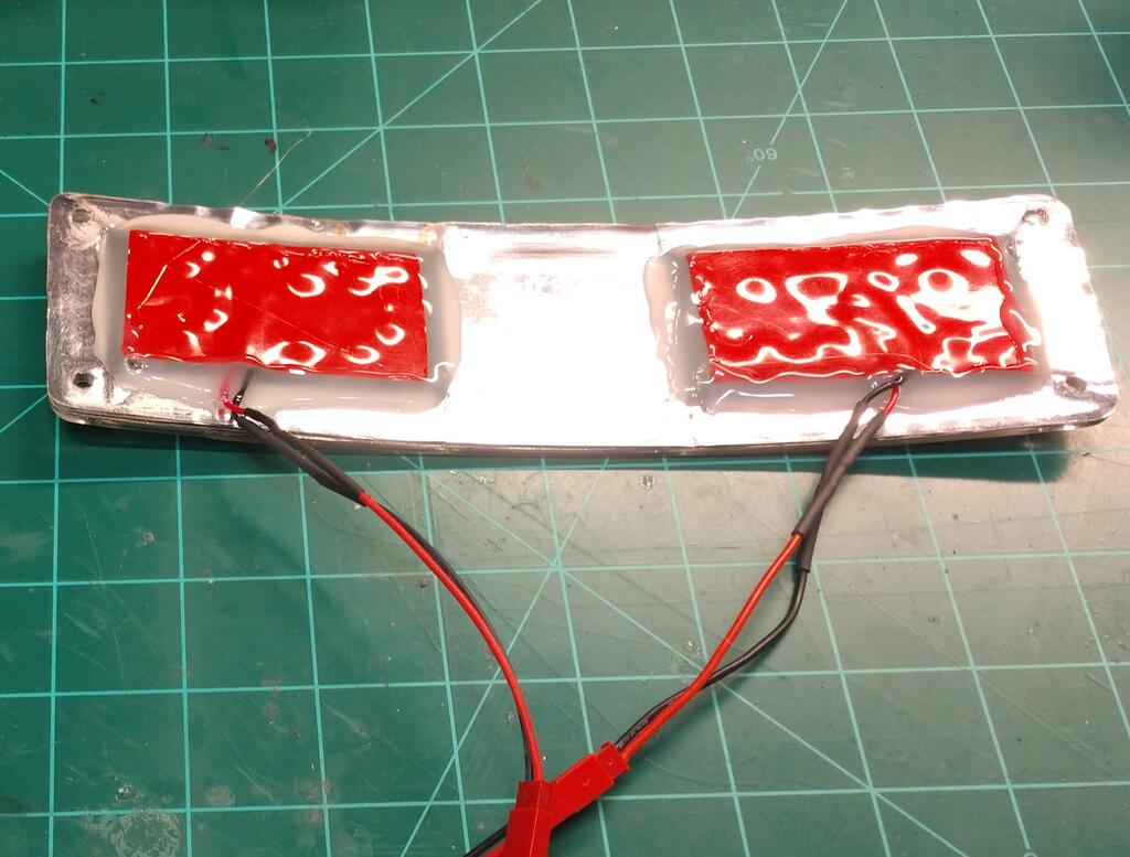

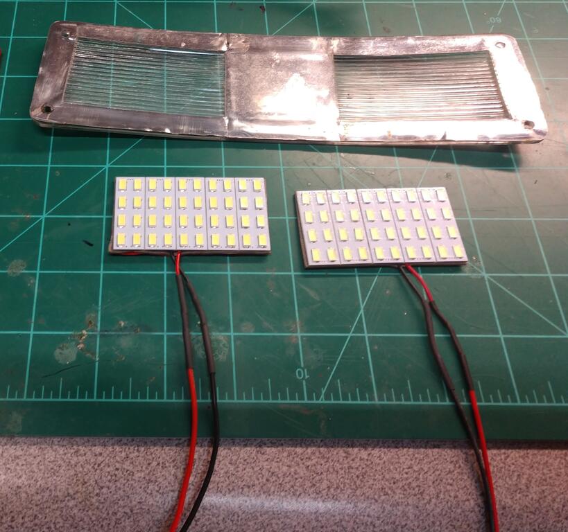

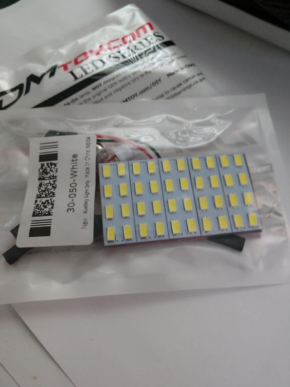

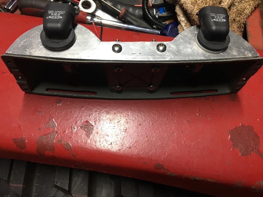

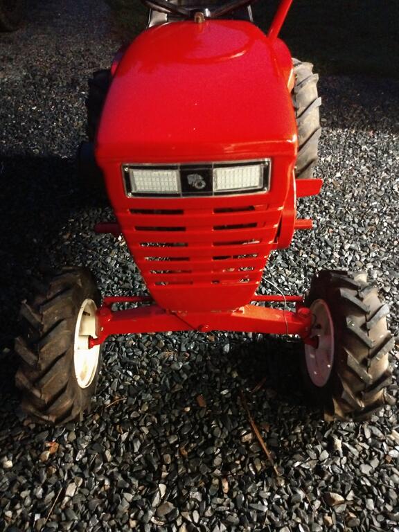

kpinnc 19,105 #8 Posted December 12, 2021 So this mod is the "ugly" one, but it is completely reversable. I've done this a couple times now, and it gives excellent results. Definitely the brightest LED mod I've found so far for this style headlight. The LED assemblies are made for overhead interior lights on a car. I got them online for about $6 each. They come with double side tape on the back, and I don't use it. The short of this is simple. I solder small JST connectors on just in case one LED panel fails, though it hasn't happened yet. Then I use hot glue to secure them to the back of the bezel. I use hot glue because it holds great, but can be removed without damaging the bezel. The glue seals out any crud, and so far has held up to the heat of the engine no problem. The pictures don't come close to showing just how bright these are. 2 12 Share this post Link to post Share on other sites

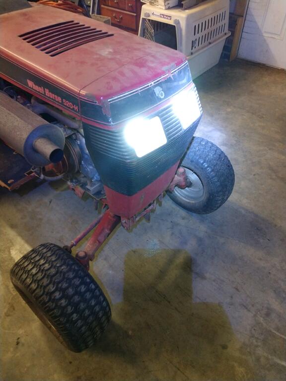

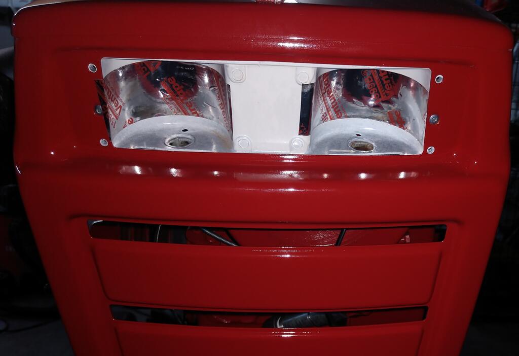

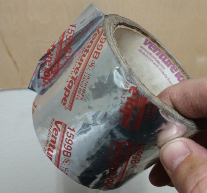

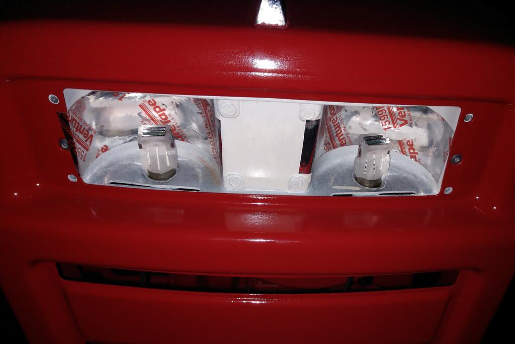

kpinnc 19,105 #9 Posted December 12, 2021 The other mod for this style headlight is more common: just swap bulbs in the original housing. Results here vary wildly depending on the type of bulb used, but can definitely add some serious improvement regardless. I've found that adding something reflective in the back of the housing makes a big difference. The last one I did used chrome duct tape. It turned out pretty good, but would have been better if I used better bulbs. 1 4 Share this post Link to post Share on other sites
Maxwell-8 4,371 #10 Posted December 12, 2021 I always stayed with incandescent bulb cause I like the look. stock, cozy color, and often don't need the output. 60w of incandescent is sufficient for me. On my c-141 I will be trying some LED's Have some rear LED from Skipper. And in the front I will be going to use the USA made Baja Designs S1: 2"x2"x2" and 2350 lumens with what I believe to be a nice color. not to white, not to yellow. I hope Santa has deep pockets this year tho.. I have a chinese 35" singelrow ledbar, claimed to be 150 watts, but couldn't produce more light then my 150watts incandescent headlights. 1 Share this post Link to post Share on other sites

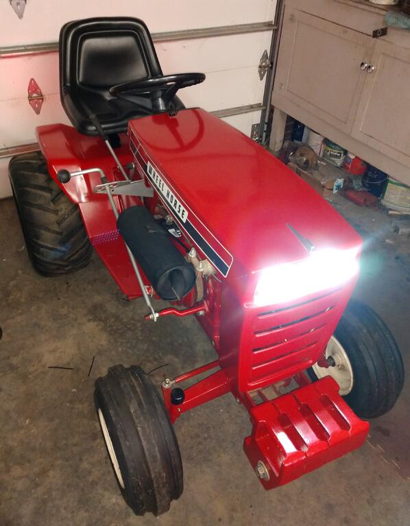

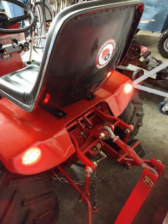

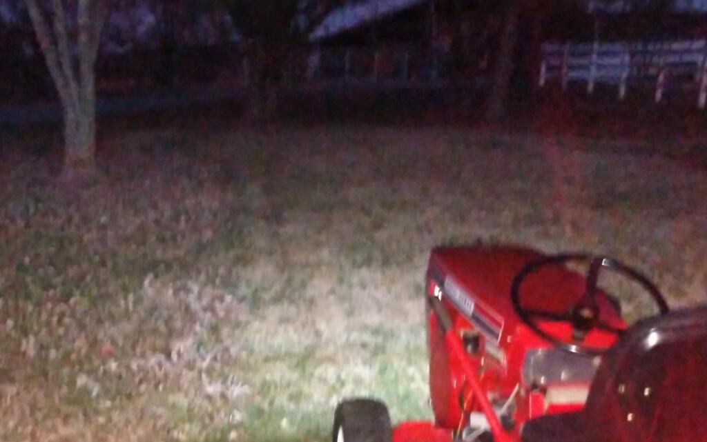

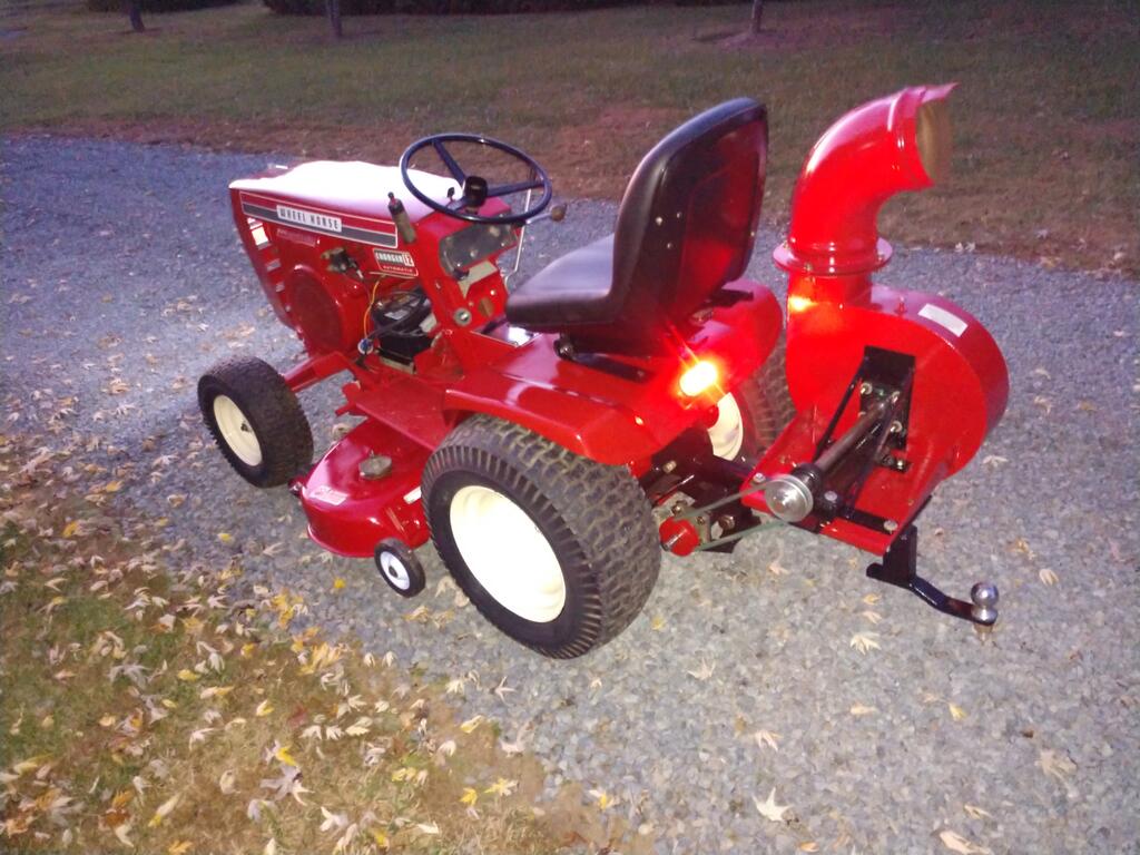

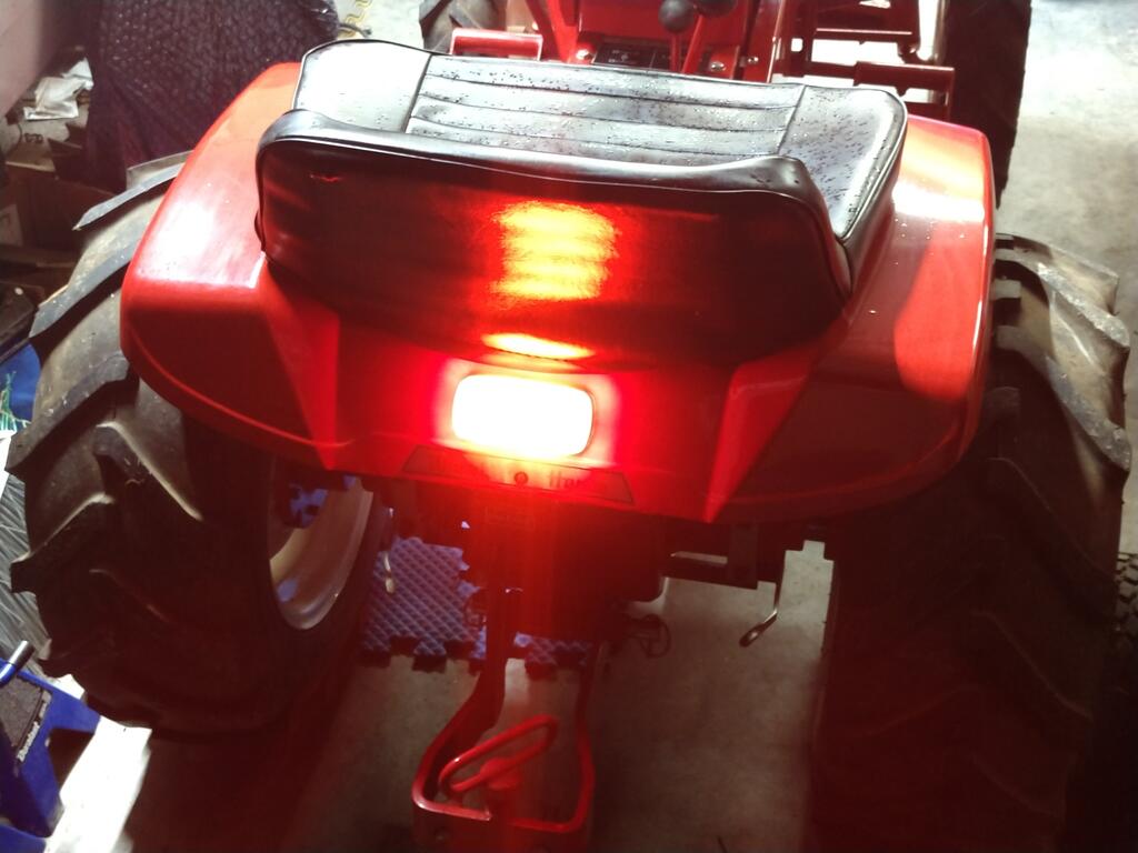

kpinnc 19,105 #12 Posted January 9, 2022 Got the Bronco converted to full LED. Same front setup as the 867, and non- standard tail lights because my fender is notched for the 3-point. Added a single inline fuse holder and fused for 5 amps. 3 3 1 Share this post Link to post Share on other sites

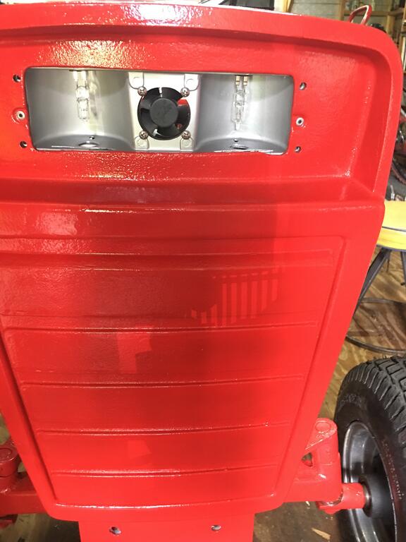

19richie66 17,951 #13 Posted January 9, 2022 (edited) Very nice. I just brought back my dad’s Bronco 14 home. I’ll have to check yours out more closely. I converted my gt14 to halogen lamps with a cooling fan in the front with hopes of going led in the future. I like the led panels you installed. Have a link for those? Edited January 9, 2022 by 19richie66 1 2 Share this post Link to post Share on other sites
ebinmaine 81,273 #14 Posted January 9, 2022 32 minutes ago, 19richie66 said: I converted my gt14 to halogen lamps with a cooling fan in the front Pretty slick Richie 1 1 Share this post Link to post Share on other sites
19richie66 17,951 #15 Posted January 9, 2022 It works. 2 Share this post Link to post Share on other sites

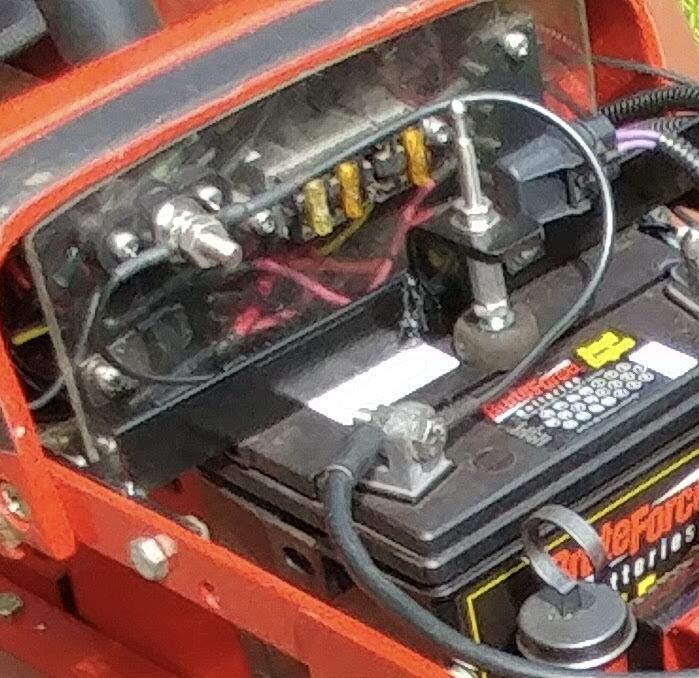

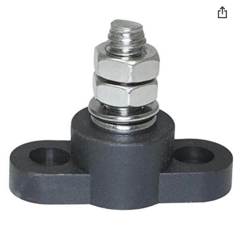

19richie66 17,951 #20 Posted January 9, 2022 (edited) I used one of these for my lighting. I ran a ground wire directly from the battery to this post and then tied my ground wires to it. No flicker. Edited January 9, 2022 by 19richie66 1 5 Share this post Link to post Share on other sites
Jeff-C175 7,212 #21 Posted January 9, 2022 2 hours ago, 19richie66 said: the battery Richie, is this a stock battery hold down ? and the Plexiglas shield? Share this post Link to post Share on other sites
kpinnc 19,105 #22 Posted January 9, 2022 6 hours ago, 19richie66 said: I used one of these for my lighting. I ran a ground wire directly from the battery to this post and then tied my ground wires to it. No flicker. I love the plexiglass shield! Tried and true method for protecting hot circuits! 1 Share this post Link to post Share on other sites
kpinnc 19,105 #23 Posted January 9, 2022 8 hours ago, jonw440 said: Vstar LED PAR36 bulbs. I love these lights! I used them the other night and worked great. No flicker (I did add a ground wire from the motor to the ground bolt on the hood hinge then up to the lights) The lights were bright enough for me. That's s great price on those. I might have to get a couple from there myself. The ones I have were about $19 each. 1 Share this post Link to post Share on other sites
19richie66 17,951 #24 Posted January 9, 2022 (edited) 4 hours ago, Jeff-C175 said: Richie, is this a stock battery hold down ? and the Plexiglas shield? I made the hold down and the lexan is part of a golf cart windshield. It was the easiest way to add a fuse panel, relays and circuit breaker. Edited January 9, 2022 by 19richie66 4 Share this post Link to post Share on other sites
