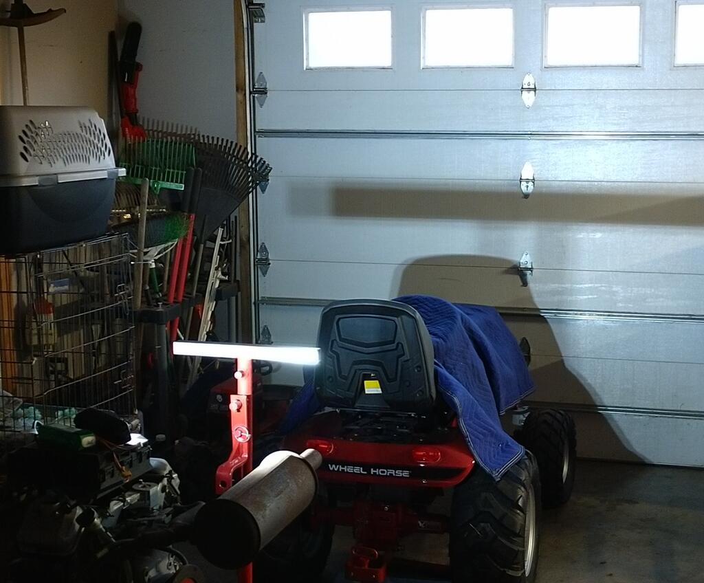

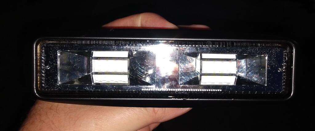

kpinnc 18,960 #26 Posted January 12, 2022 I have another one, but it won't come close to looking "original" on anything. That being said, it's crazy bright. Like mow in the dark bright... 2 3 Share this post Link to post Share on other sites

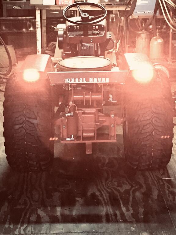

19richie66 17,935 #32 Posted January 12, 2022 (edited) 33 minutes ago, kpinnc said: I certainly like them! A bit expensive, but not so much when you realize they probably will never need replacing. Gonna have to try a set! You can kind of see how bright they are but are way better when it’s dark. Picture does them no justice. You can find them on ebay sometimes at a good price. Place where I got mine isn’t on there anymore. Edited January 12, 2022 by 19richie66 2 6 Share this post Link to post Share on other sites

kpinnc 18,960 #35 Posted January 13, 2022 5 hours ago, 19richie66 said: You can kind of see how bright they are but are way better when it’s dark. Picture does them no justice. They look great to me! I think those are the same that were installed on our company trucks and used as strobes. They were very bright! 2 Share this post Link to post Share on other sites
oliver2-44 11,749 #36 Posted January 13, 2022 22 hours ago, kpinnc said: I have another one, but it won't come close to looking "original" on anything. That being said, it's crazy bright. Like mow in the dark bright... @kpinnc are these bulbs are complete lights with housings. If they are bulbs, will they fit in the C series housings. Any links to source appreciated. Share this post Link to post Share on other sites

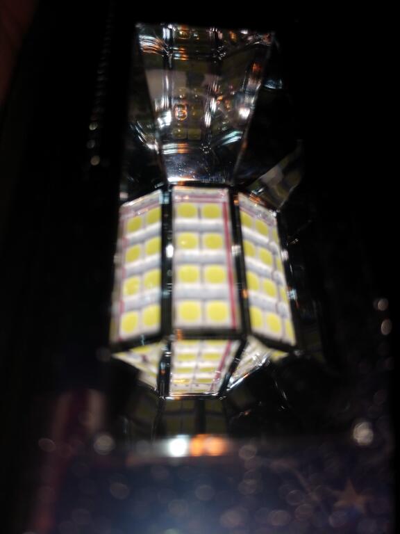

kpinnc 18,960 #37 Posted January 13, 2022 (edited) 19 minutes ago, oliver2-44 said: @kpinnc are these bulbs are complete lights with housings. If they are bulbs, will they fit in the C series housings. Any links to source appreciated. The one in the pic you copied doesn't fit any wheel horse without modification. There are dozens of versions to fit C series housings online. Anything corresponding to a 1156 bulb will work. I've ordered several from superbrightleds.com, but you can also find them in automotive sections of any Walmart. Just make sure that you get white LEDs. Even then colors will vary from slightly amber (3000) to bluish (6000). Lumen ratings also vary from low 100s to around 400. The higher the number the brighter. https://www.superbrightleds.com/search/led-products/1156/ Edited January 13, 2022 by kpinnc 2 Share this post Link to post Share on other sites
19richie66 17,935 #38 Posted January 13, 2022 8 hours ago, kpinnc said: They look great to me! I think those are the same that were installed on our company trucks and used as strobes. They were very bright! I believe these have 11 flash patterns and two solid on settings. One is on @10% and the other is @70%. Mine are at 10% and they are bright to look at. I would like to try their work lights. They look well made. 2 Share this post Link to post Share on other sites

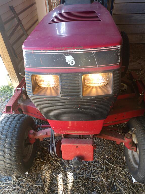

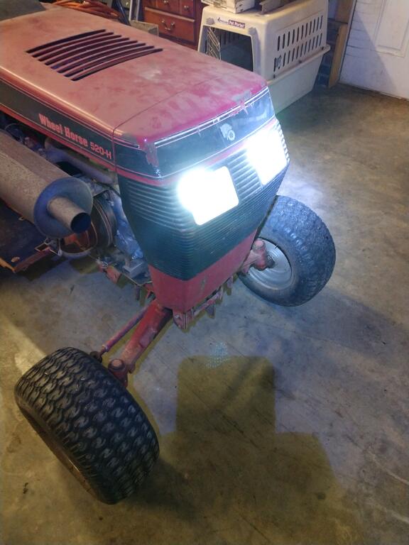

kpinnc 18,960 #39 Posted January 25, 2022 (edited) I promised some comparisons, and almost forgot that. Here's one for PAR 36 bulbs in the same tractor. First is incandescent. Second is LED. Edited January 25, 2022 by kpinnc 3 2 1 Share this post Link to post Share on other sites

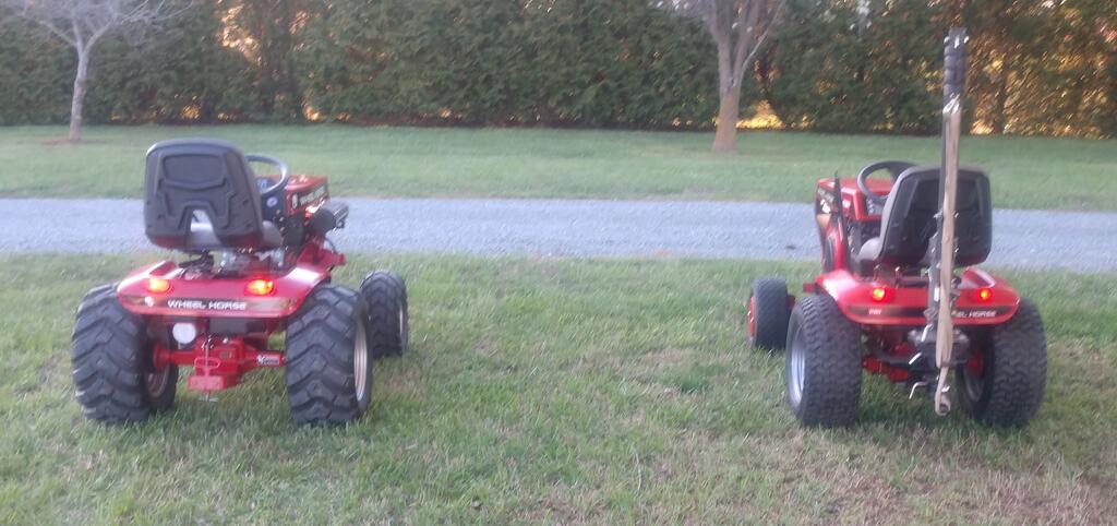

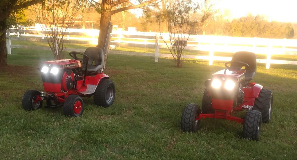

kpinnc 18,960 #45 Posted March 29, 2024 Old thread, but this is a good example of the difference between "cool" (6000) and "warm" (4500) PAR 36 LEDs. And for all the non-believers, that bright thing in the background is afternoon sunlight. These things are bright in daylight! 2 2 1 Share this post Link to post Share on other sites
kpinnc 18,960 #46 Posted March 29, 2024 2 hours ago, kpinnc said: And for all the non-believers, that bright thing in the background is afternoon sunlight. These things are bright in daylight! Same for tail lights for that matter... 2 1 Share this post Link to post Share on other sites
