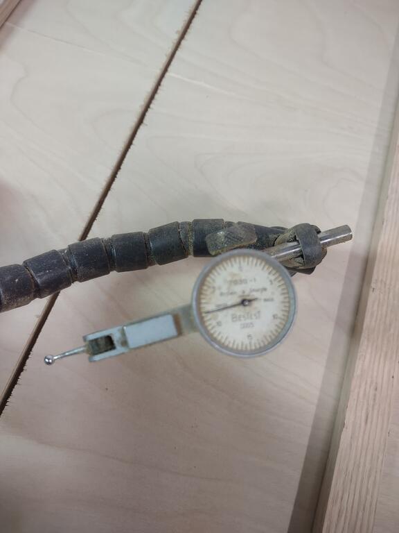

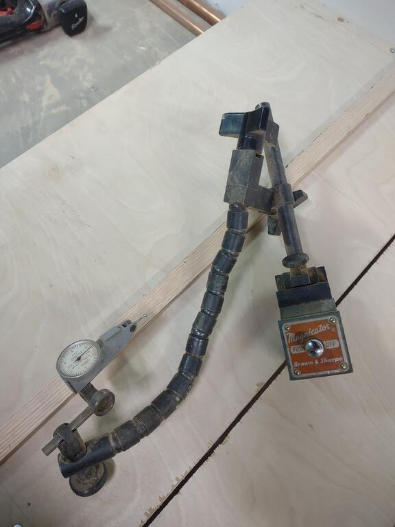

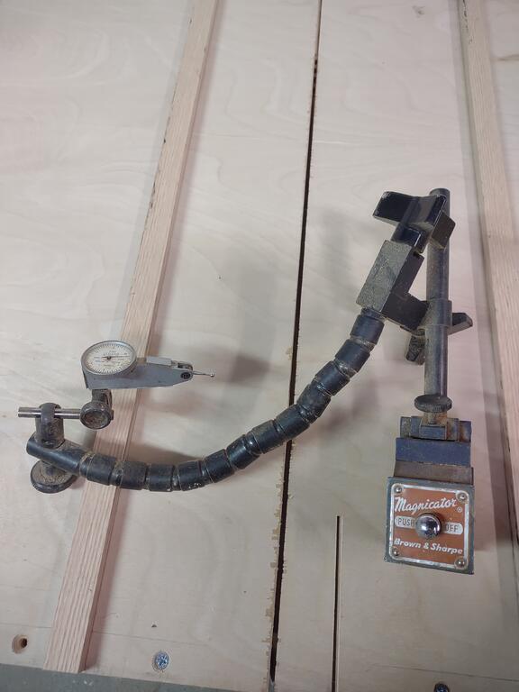

ebinmaine 80,765 #1 Posted November 29, 2021 What might this be used for? Looks like it has some sort of magnetic mount but I don't know why the push button is there. Arm appears to be adjustable in many many different ways and directions. Is this simply some sort of universal ish tool? 1 Share this post Link to post Share on other sites
ri702bill 13,092 #2 Posted November 29, 2021 (edited) Eric: That is a Test Indicator and Magnetic Base with the not-so-rigid knuckled arm. Probably used to check brake rotor run-out. That indicator, if it moves smoothly, has limited (+/- .010) travel, and is good to have. The magnetic strength on the base can diminish over time - just replaced mine this year, bought in in the 1980's. The posable arm (think GI Joe doll) will wear out first - the cam action over time will not be enough to hold all the joints tight. I prefer the solid arm version. Bill Edited November 29, 2021 by ri702bill 6 Share this post Link to post Share on other sites
Achto 32,795 #3 Posted November 29, 2021 (edited) That is a dial indicator on an adjustable mount with a magnetic base. I have used them on a lathe to check trueness, also used them when lacing a spoke rim to check trueness. When lacing a Harley rim the tolerance is .015" on the wobble and .015" on the hop. Edited November 29, 2021 by Achto 4 Share this post Link to post Share on other sites
ri702bill 13,092 #4 Posted November 29, 2021 Just looked at the pictures again - Brown & Sharpe - I worked there twice, but never in the Industrial Products Division. EXCELENT Bestest indicator - jeweled movements - cleaned up is is a gem. Bill Share this post Link to post Share on other sites

rmaynard 17,585 #8 Posted November 29, 2021 I have a similar unit that I use to set the timing on Tecumseh engines by finding the piston top dead center. It is called a Disc Brake Runout Gauge. 3 Share this post Link to post Share on other sites
Gregor 4,848 #9 Posted November 29, 2021 Would the push button turn the magnet off? 1 Share this post Link to post Share on other sites

Ed Kennell 47,399 #13 Posted November 29, 2021 (edited) 1 hour ago, Gregor said: Would the push button turn the magnet off? Yes, it releases the magnet. Brown and Sharp 0.0005 " Best Test dial indicator with magnetic base and flexible arm. I used one for 40 years for centering bearings and aligning shafts. Around $50 bucks for the mag base. $200 for a Best Test indicator. Edited November 29, 2021 by Ed Kennell Share this post Link to post Share on other sites

Gregor 4,848 #15 Posted November 29, 2021 8 minutes ago, Ed Kennell said: Yes, it releases the magnet. Mine has a knob to turn. 1 Share this post Link to post Share on other sites
lynnmor 9,042 #16 Posted November 29, 2021 That indicator has been abused like so many things. It has no place in the hands of folks that have no respect for quality tools. The price when new is over $200. Example 1 Share this post Link to post Share on other sites

ebinmaine 80,765 #21 Posted November 29, 2021 42 minutes ago, lynnmor said: That indicator has been abused like so many things. It has no place in the hands of folks that have no respect for quality tools Odd thing about this particular situation is this fellow kept everything he had in the original case. His widow says he was not at all known for buying things used or vintage or anything like that so it's likely he had this for many years. He was what I would call and avid experimental woodworker. She had said that he was very well known for starting a project to mess with it some and then not finishing it. Often on purpose. Given the information in the previous posts so I'd say it's likely that he used it to check things on his wood lathe which he used a lot. I don't understand for the life of me why it's so full of dust. I wonder if it got misplaced and then lost in the shuffle somehow. The workshop area was STUFFED. 1 Share this post Link to post Share on other sites
Gregor 4,848 #22 Posted November 29, 2021 (edited) Not much sense using something like that on wood. Wood isn't that stable from one week to the next. Or one day to the next. Edited November 29, 2021 by Gregor 1 Share this post Link to post Share on other sites
